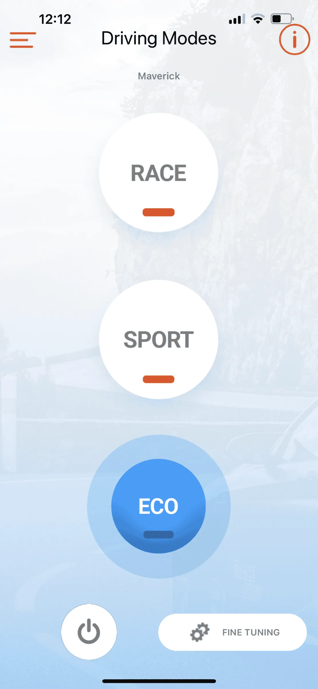

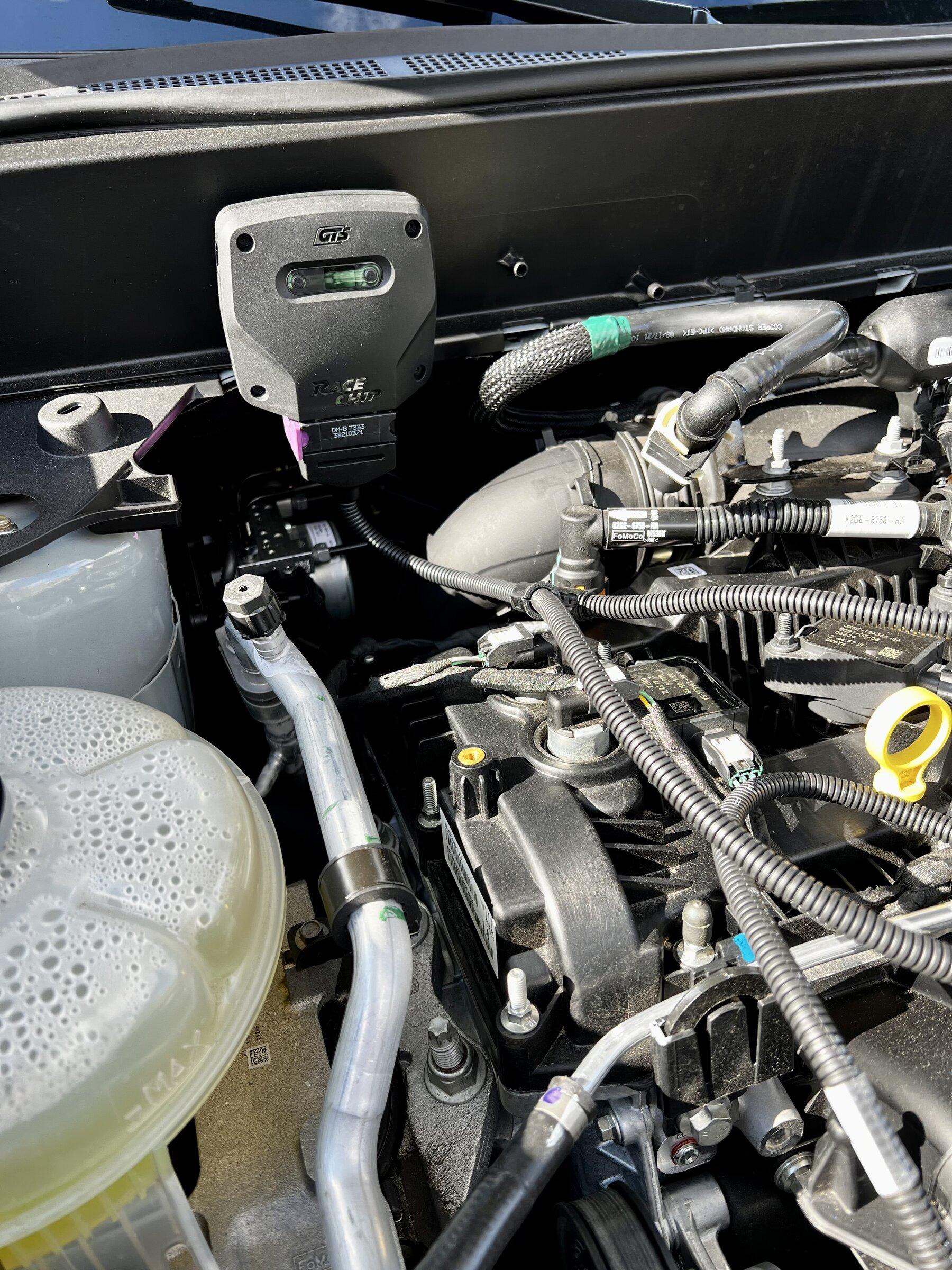

Well, I had a few spare minutes today and thought I’d throw this on, pair the Bluetooth with the app and check it out a bit. Install involves literally two plugs and find a spot to mount the unit. The longest part of the install was removing the front skid plate on my FX4 as it makes it easier to reach.
I’m not going to go wild and beat on the truck until I can get it over to my tuner to monitor things. However, I did do two quick 0-60 sprints and it seems much quicker. Throttle response is night and day and the power-band is much more smooth. I don’t have a dragy or any figures in black and white to offer anyone yet. The earliest I can get into my tuner with both of our schedules in January 5th.
I also ran the truck around for several miles in eco mode as I was equally interested in that aspect of the unit as the go-fast portion. The revs definitely hang lower and drives in a similar manner to the eco mode in my previous vehicle.
Will report back in January once I get the truck on the dyno and see what happens. Until then the product is going to stay on eco mode and I’ll see if there’s any noticeable difference in fuel efficiency.

Greetings all! I'm trying to help my sister with the install of one of these remotely. The docs RaceChip sent her actually had a 2.3T Ford Ranger engine bay in the pictures. Does anyone have pictures of where the A and B sensors are, or any written tips they could offer on the install process. Thanks and happy boosting!
UPDATE: She got the chip installed, thanks for nothing! (jK).
Taking down the FX4 skidplate allowed access to plug B which she mentioned was a bit tough to get disconnected.

Thanks to CLH917, I managed to install non Bluetooth GTS last Christmas on the FX4, 4K, LUX, 360. The goal is to gain MPG. The instructions & pictures were from some other Ford engine.
