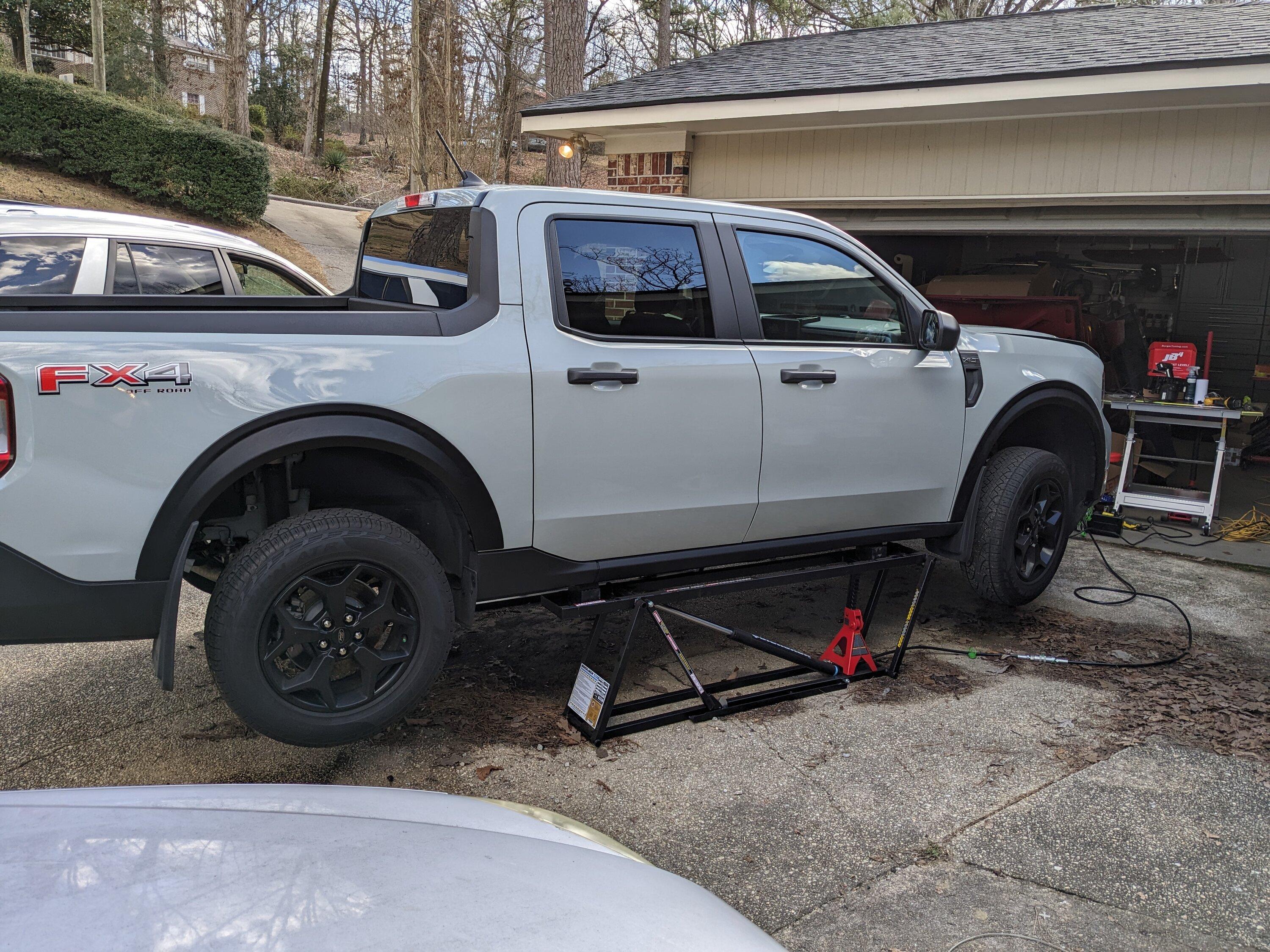

I hooked up my JB4 and it was pretty easy. One of the two sensor wires is best accessed from beneath the vehicle; I used the QuickJack so I could look over the exhaust as well. Note that the front skid plate needs to be removed during installation if you have the FX4 package.
Ford Maverick JB4 Tuner for 2022+ Ford Maverick 2L EcoBoost (BETA) PXL_20240223_204902800
Once it was hooked up, I could connect with my tablet to monitor gauges and log information for review. The Bluetooth connection is an option, as is a cable for a Windows computer. The JB4 connects to two engine sensors and the ODB II output beneath the dash.
Ford Maverick JB4 Tuner for 2022+ Ford Maverick 2L EcoBoost (BETA) PXL_20240226_173858859
Now to get out and test the various maps that are included with the package. I'll post my thoughts after trying it all out.
