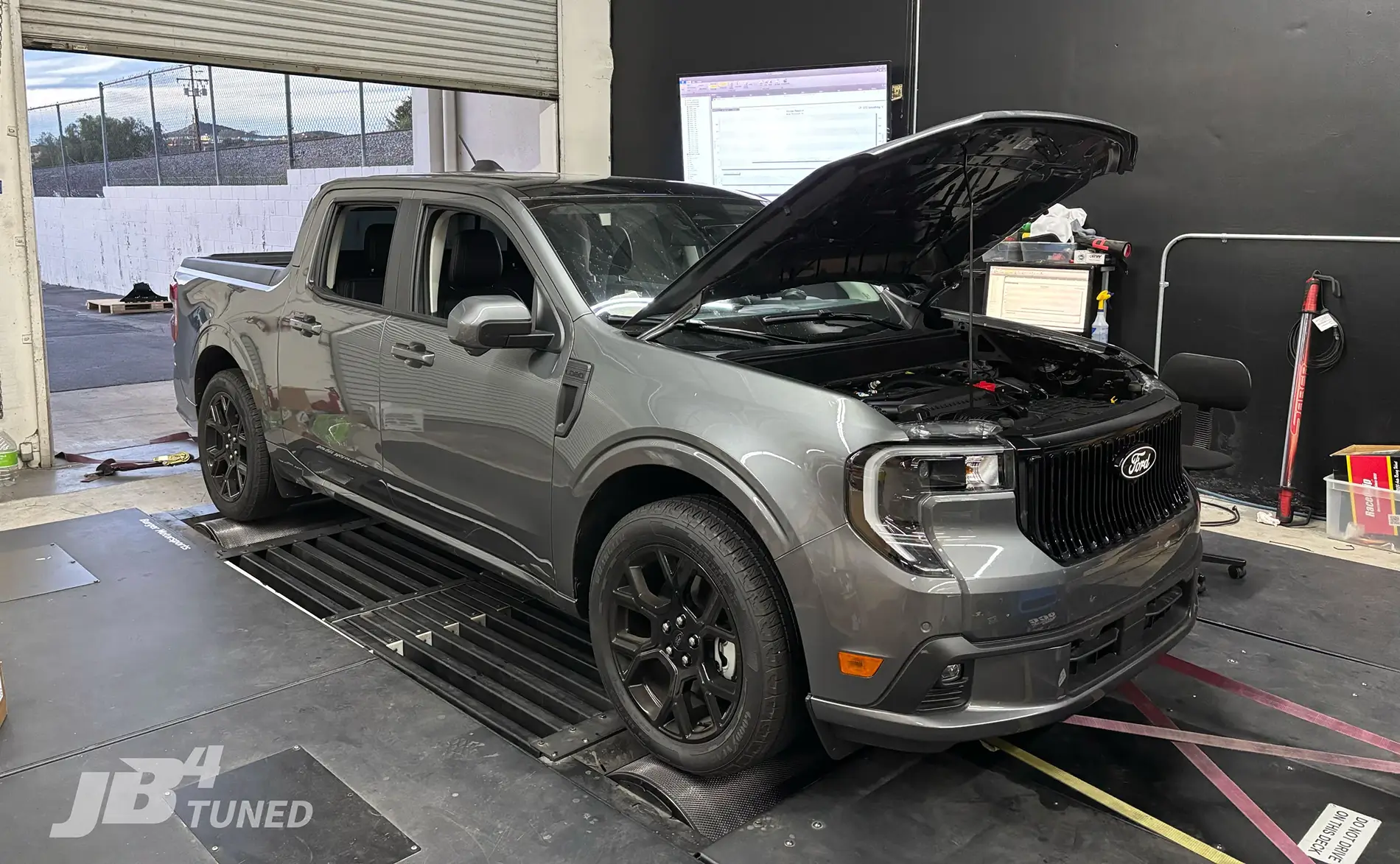

I took my 2025 Lobo in for a tune with Burger Motorsports. Its pretty awesome. Has anyone else had there truck tuned? What are your thoughts?

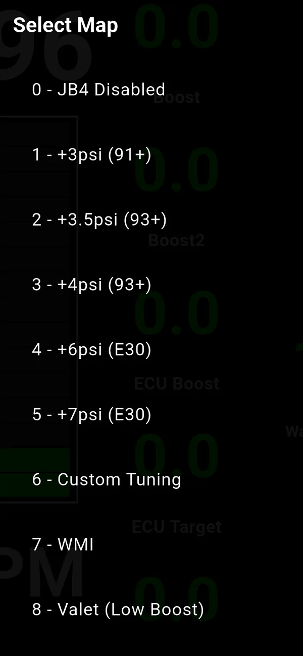

Thanks for taking your Maverick in! I just installed the new firmware yesterday. Im only on Map 1 and didn't have much time to test it out. FYI, anyone who has a 2025+ must enable option 1. This is designated for the new 2025+ CANbus and needs be enabled for the JB4 to tap into the trucks ECU values. In addition if you want a faster ramp up of boost, also enable option 6.
I'll be testing option 6 later today. Ideally looking for higher boosts during spirited city driving.

Was map 4 E30?

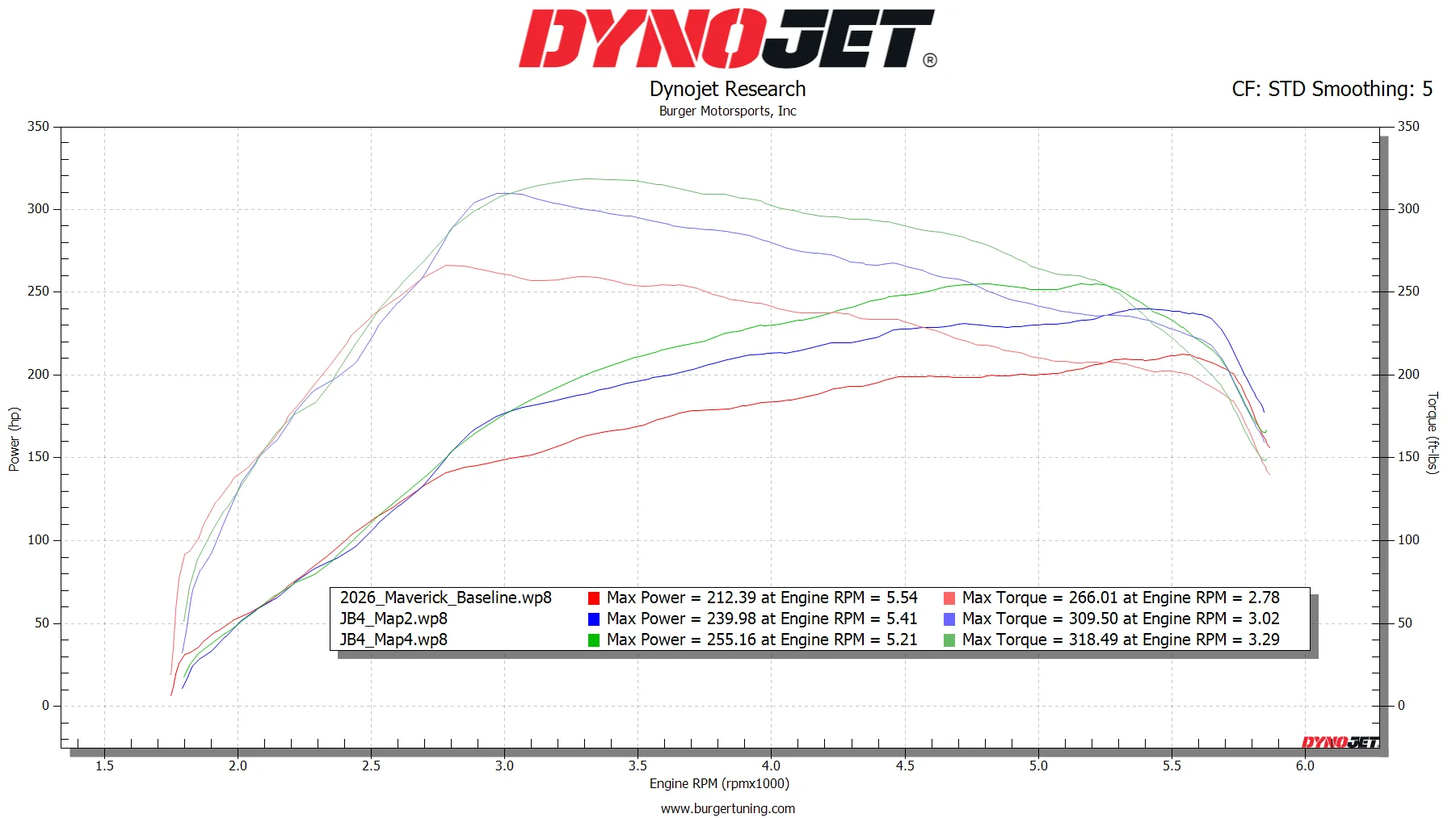

What is the power outputs of Map 2 and 3?
