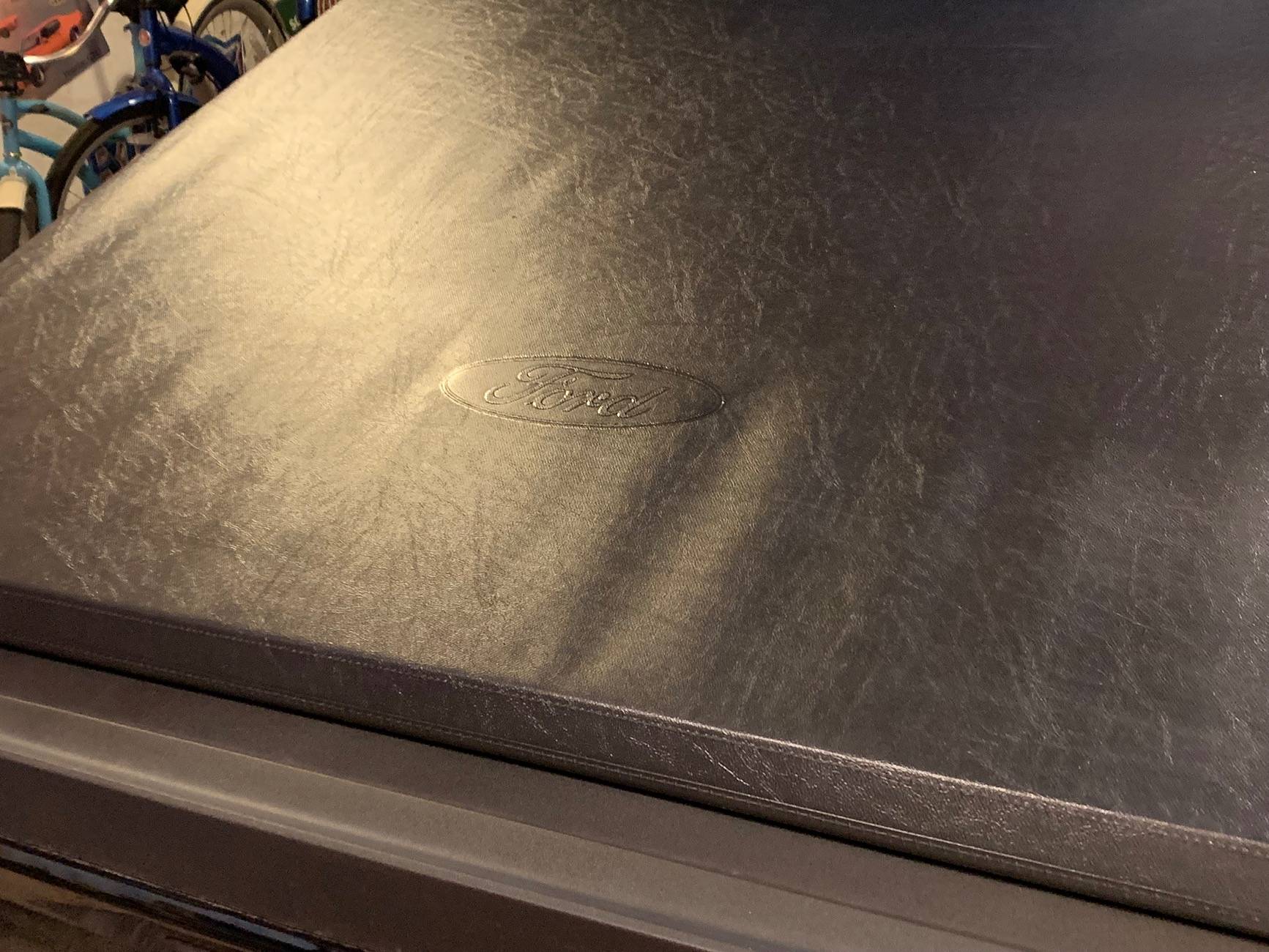

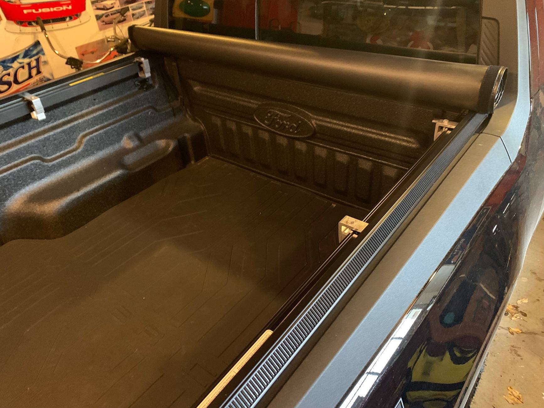

This was the ford branded soft rollup & you can see only the clamps protrude into the bed & rolls up not blocking view, but can be pushed fairly tight if you need to use the whole bed
I had this one on my 22'. I didn't care for it much. Windy days are rough on it.

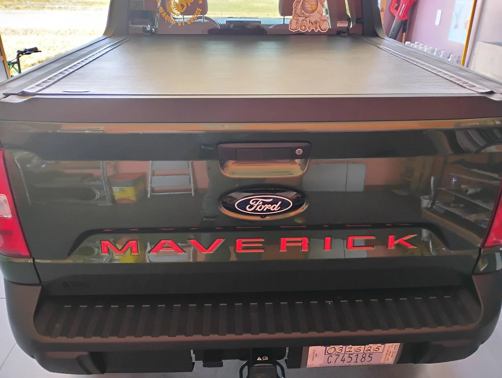

I now on my 25' have the hard roll up, which looks like one poster said, a bunch of sticks rolled up, but it is sorta high when rolled up, like six inches. It is way too cold to go out, roll it up, take a picture of it, etc., but takes about 7 inches off the sight through the glass. Not much to see that low anyway. But it is extremely better made and made to last, my opinion. Now, the worst part, it cost from ordering it when ordering the truck, some $425.

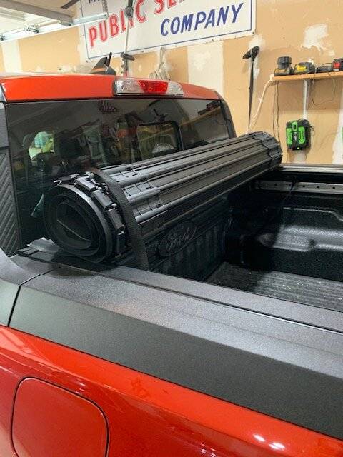

I’m looking for measurements as to how big around your tonneau covers are when rolled all the way up? (I’m trying to work out how much rear visibility and bed length I’d lose.) Please say what brand and model you have (or at least if it is a hard or soft rolling cover), but don’t worry about price or detaching it though.
Second question: how much bed width do you lose to the mounting rails?

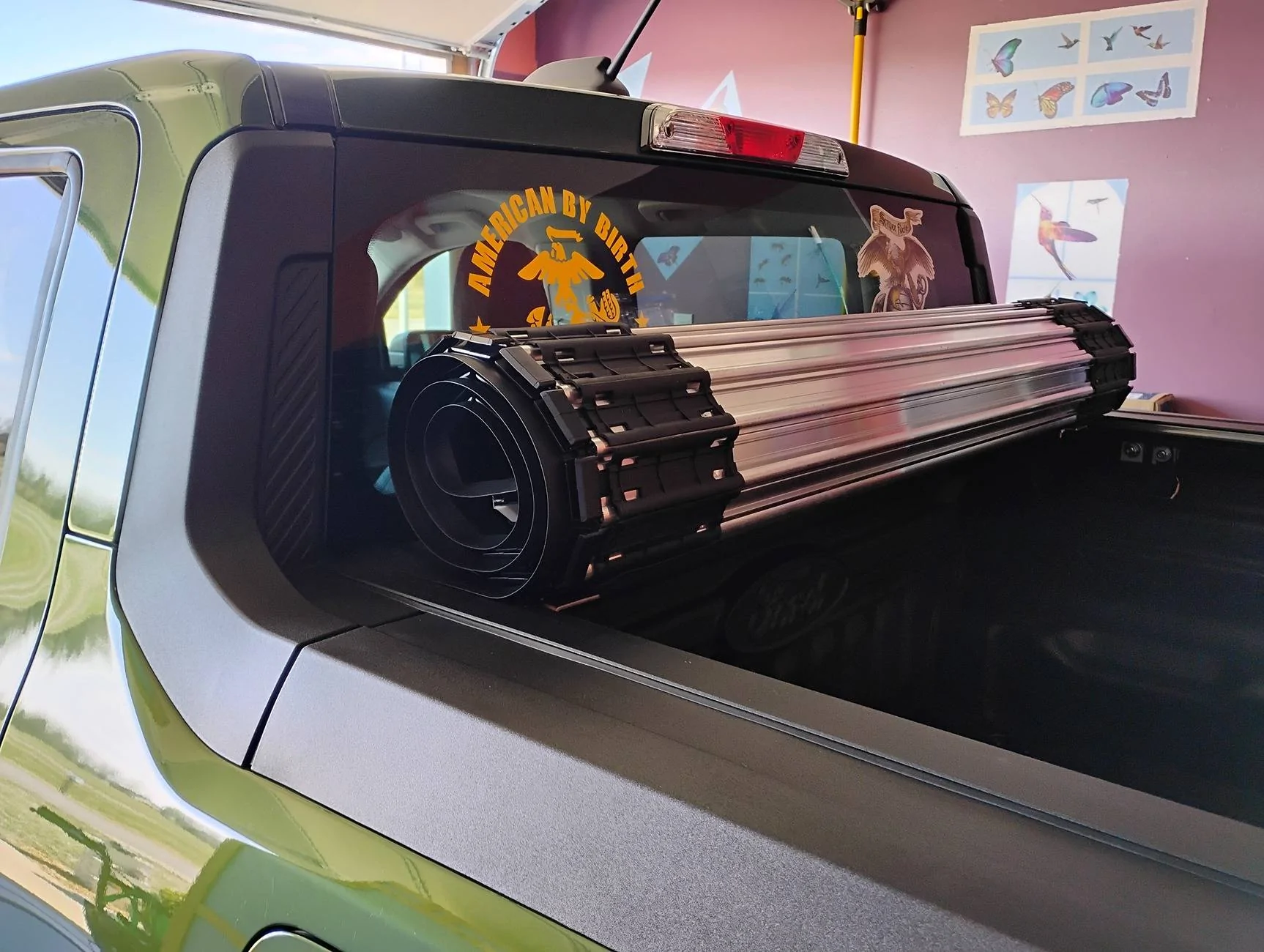

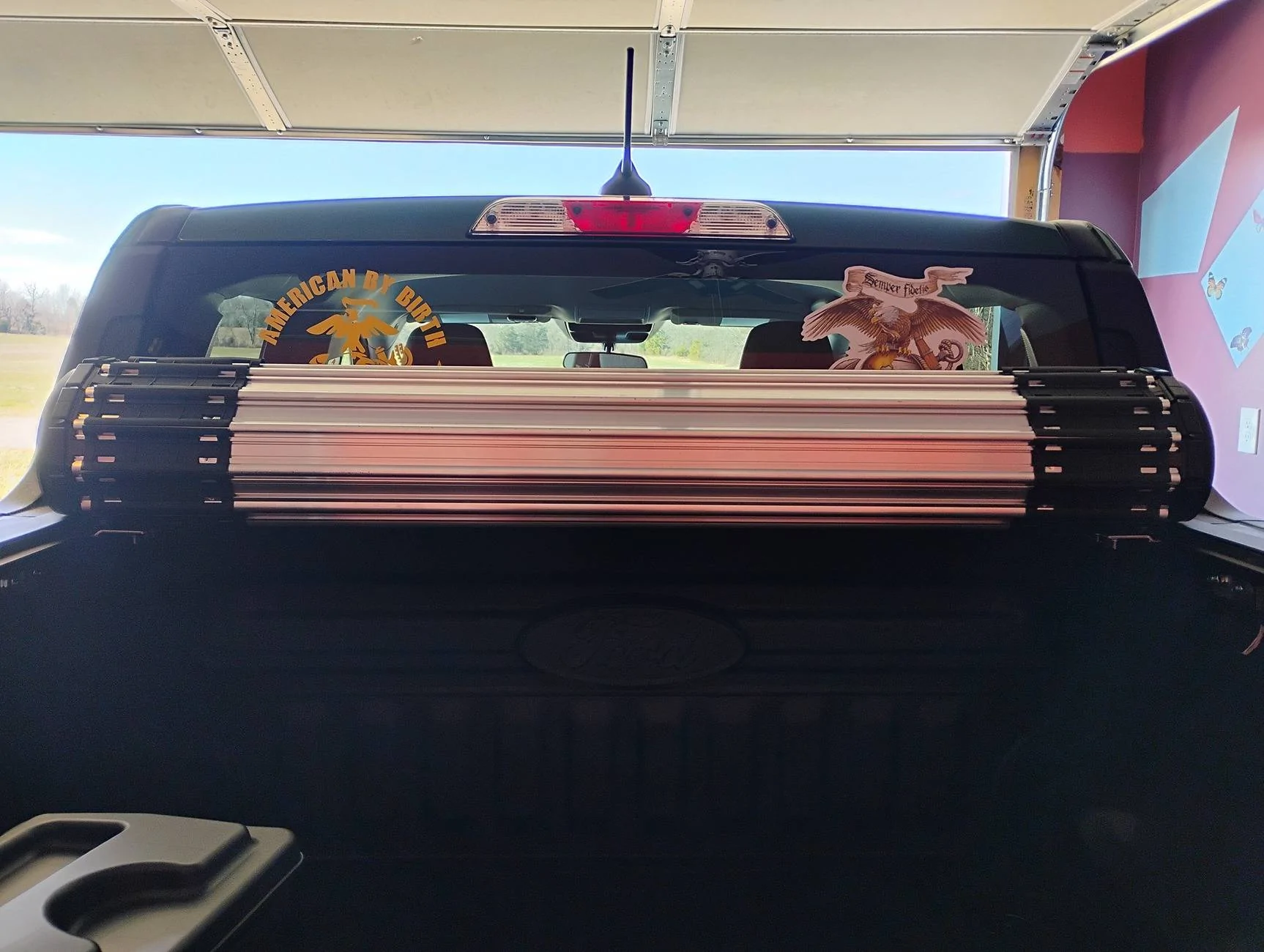

I just installed the BAK Revolver X4ts hard roll-up (with T-slots for my folding ladder rack).

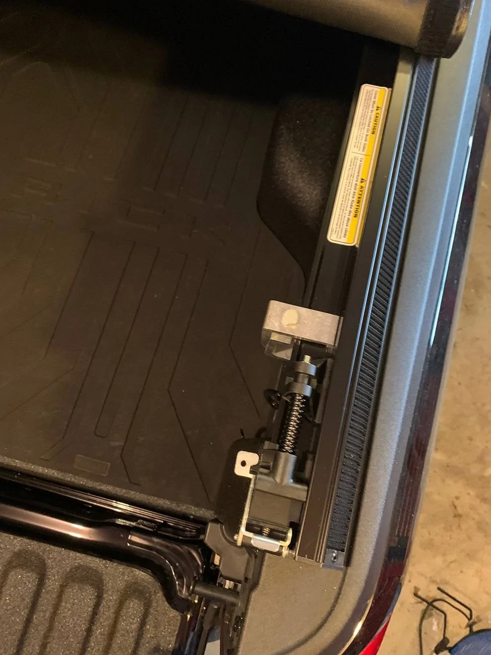

The height of the roll is about 7-3/4" and it blocks the first 7-1/2" of bed. I have to remove it to use my bicycle rack that sits against the front of the bed, or when I get a load of mulch, but it comes off easily with 4 "knob nuts". The mounting rails cost you 2-3/4" of bed width on each side, but that's still less than the wheel wells and does not affect things like 4x8' sheets. The slotted cover mounting plates in the front block the bed a bit more, but you can see them in the marketing photos. The locking actuator arm at the rear extends into the tailgate area a bit more on each side, so you also have to watch that when loading stuff. I think the extruded aluminum rails are a bit fragile for "truck" use but probably will do fine if you keep them in mind when loading. I had to locate my rails about 3/4" rearward from the factory position in order to get the cover to overlap the edge of the tailgate adequately. The cover and rails have to be aligned to some extent for the latch mechanism to operate properly. I do not expect this cover to keep rain out of the bed, but I have a DeeZee rubber mat in there so drips down the edges will not touch cargo.
