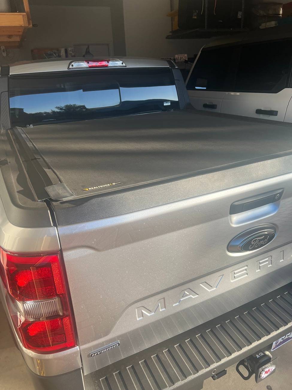

Great T Cover
Ford Maverick Question about soft tonneau covers 1maverick
