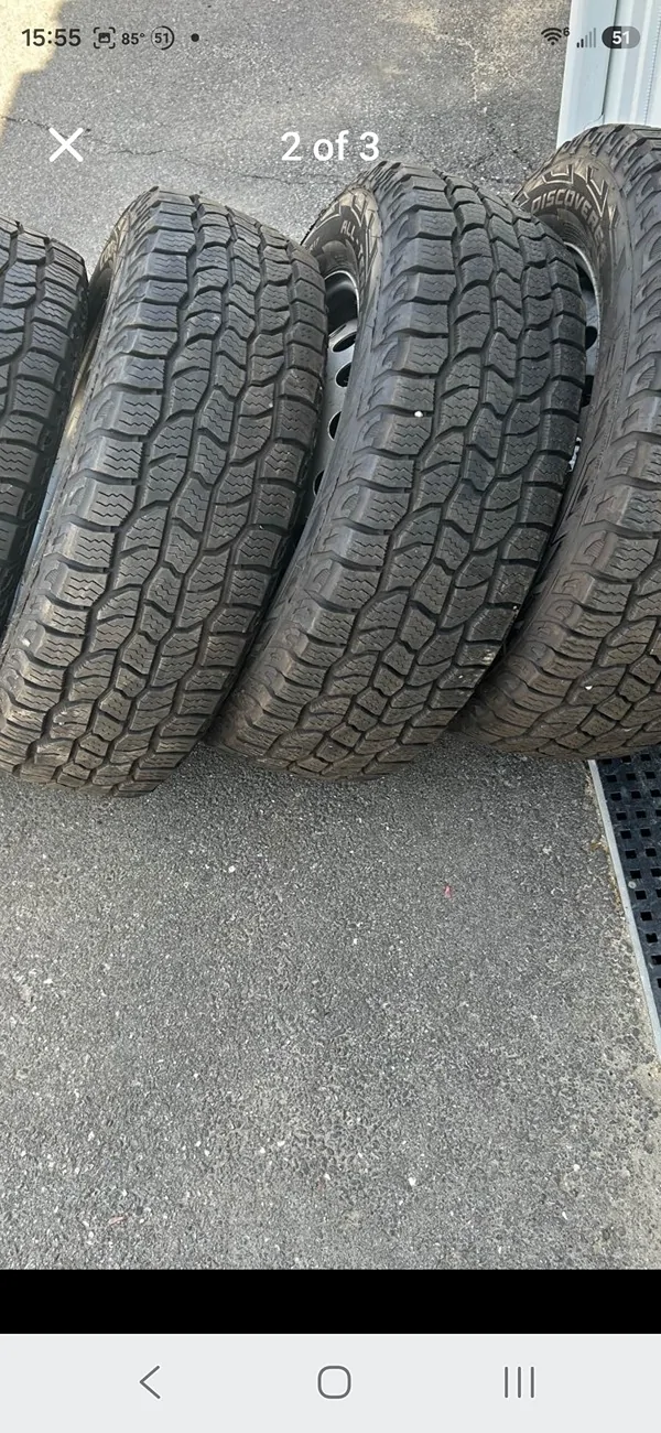

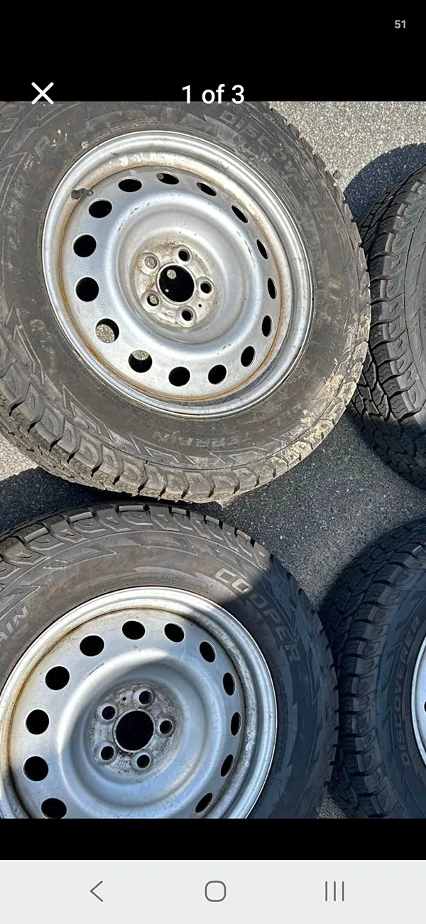

Thank you, I have a 2024 Maverick hybrid 2wd
I found a set of steel wheels with tires, and existing sensors in them.
My goal was to buy this new set of steel wheels 245/75/17 to replace my alloy wheels that were 225/75/17.
The steel wheels do not have the center cap, or lug nuts. I was hoping that I could use my lug nuts from my alloy wheels to put these new larger steel wheels on my truck. The seller said the sensor should work for 2022-2025 Mavericks

The steel wheels are not larger, the tires are larger.
The lug nuts for the steel wheels are open ended and are different from all other Maverick factory wheel options.
TPMS Sensors for 2022-2024 Mavericks are 315MhZ
TPMS Sensors for 2025-2026 Mavericks are 433MhZ
The sensors are not interchangeable outside those model years..

The 225 and 245 designations are the tire size, not the wheel size.
The wheels are both 7 inch rims and either tire size should fit on either wheel set.
The tires from the steelies can be put on your rims, or are they in bad shape?

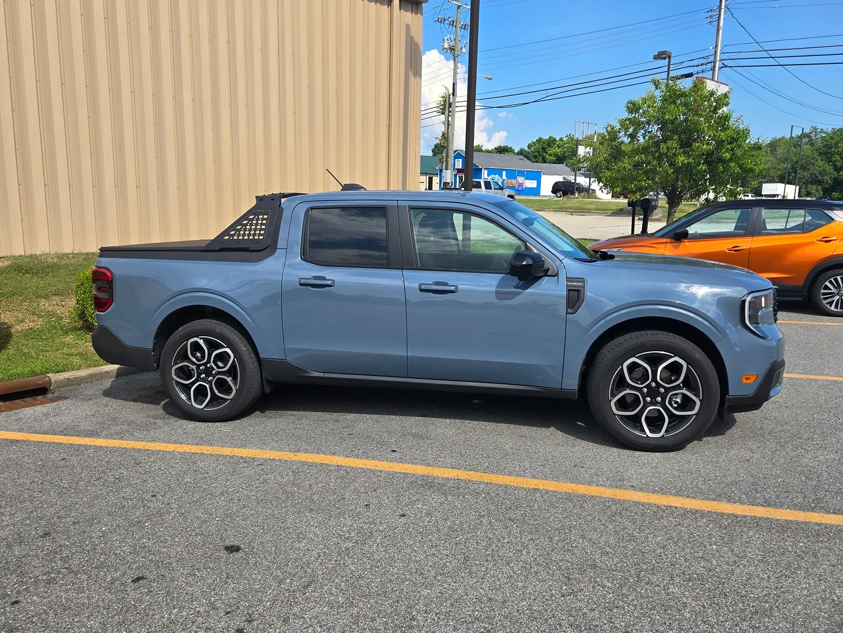

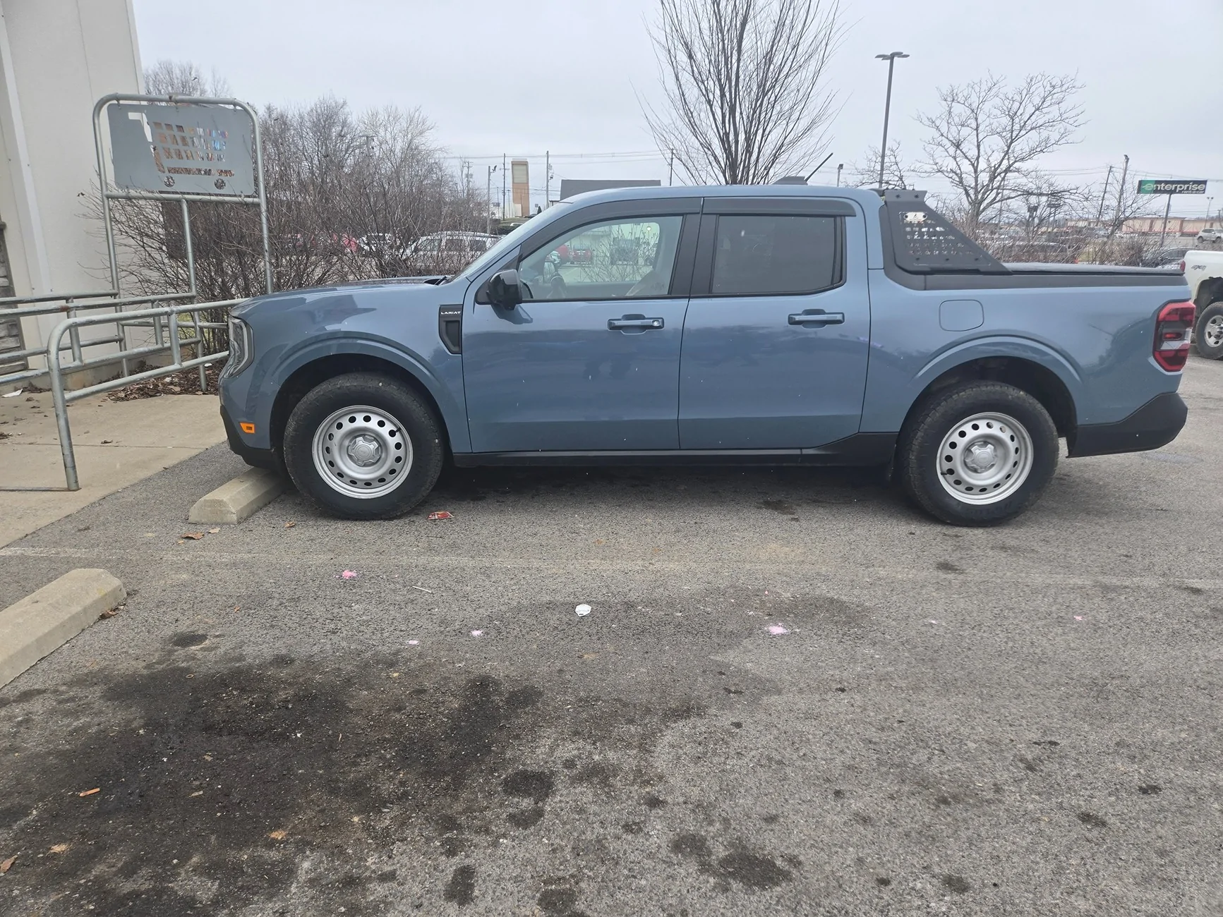

I used the chrome lug nuts designed for the steel wheels for my winter and all terrain driving so the center caps are retained. I used the OEM aluminum wheel lug nuts for the Mustang Mach-E wheels.
Those look great, I did not realize the mach e rims would fit the Maverick.
I currently have the xlt alloys on my Maverick. I want to put the steel wheels on for getting firewood, and also for winter to keep Alloy Wheels in good shape. Being in New England I am afraid that the salt on the roads is going to ruin the painted alloys.
