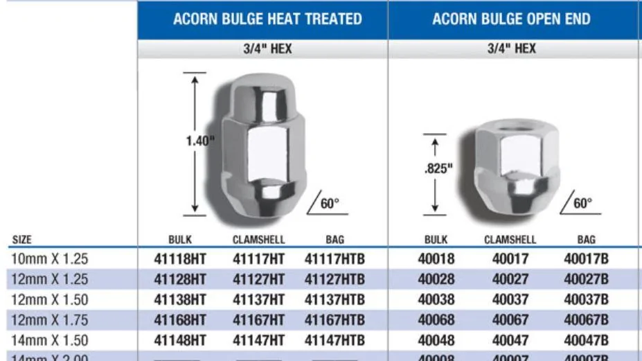

could anyone tell me if your steel wheels come with an open end lug nut? If so is it a 60 degree conical like on the regular alloy wheels?

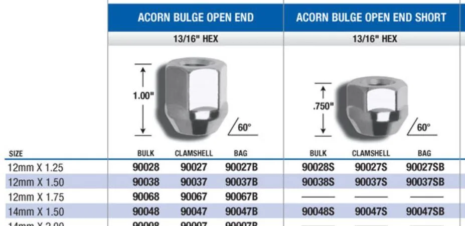

I already have my custom wheel and tires, just waiting on my truck. It was in st Louis yesterday. hoping it get here to Michigan soon. I had ordered mcguard spine drives but now that I have the wheel I found out they are too tall for the center cap to fit. Momo wheels said to use an open end conical. I was thinking maybe if the steelies have an open end nut I'll just use those. A normal 13/16 socket just fits the lug nut hole
