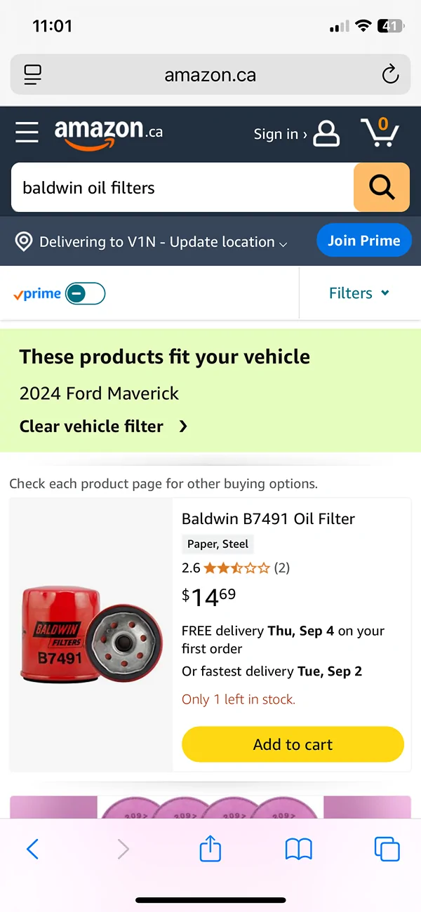

Is this the one for a 24 EcoBoost?
Yes. That is the equivalent to the FL-910s.
The equivalent to the FL-400s is B243, and the equivalent to the FL-1A is the B2.
Thanks Terry. They all fit the 24 Eco, just some hold more or less oil, and more is better when it comes to oil! To an extent,😉
I paid just over $4 each on a case of 12 B2's. $14? That's crazy money for an oil filter. O' Weirdly gets about $12 for some of their filters... not my $12.
Since I couldn't find my case of Baldwins (after my grandson used my shop and 'organized' some of my inventory I bought a filter at my local Federated ( soon to be a Parts Pro store) for $4.85.
