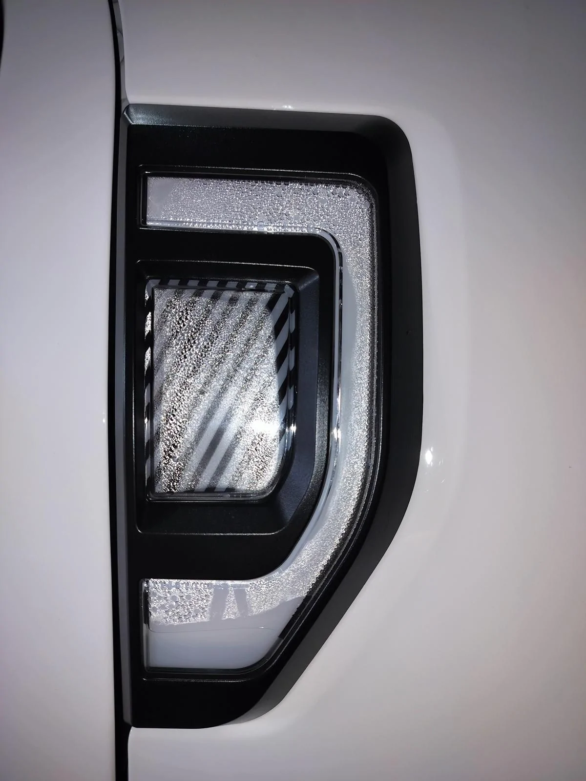

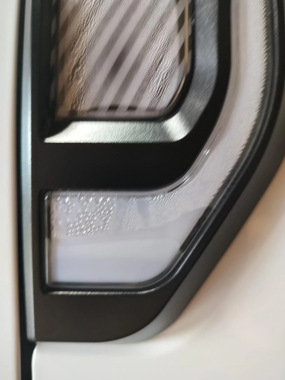

I want to include a couple pictures of the issue? DONT BUY THIS ITEM !! I understand they are a sponsor but there has to be some accountability.just saying
Ford Maverick Problem with Mabett Fender Turn signals IMG20240614085437
Ford Maverick Problem with Mabett Fender Turn signals IMG20240614085424

Box them up and return to Amazon and get your money back. I have already done this with the set I bought because I had the exact problem. My money was in my account the next day. Here is a picture of mine

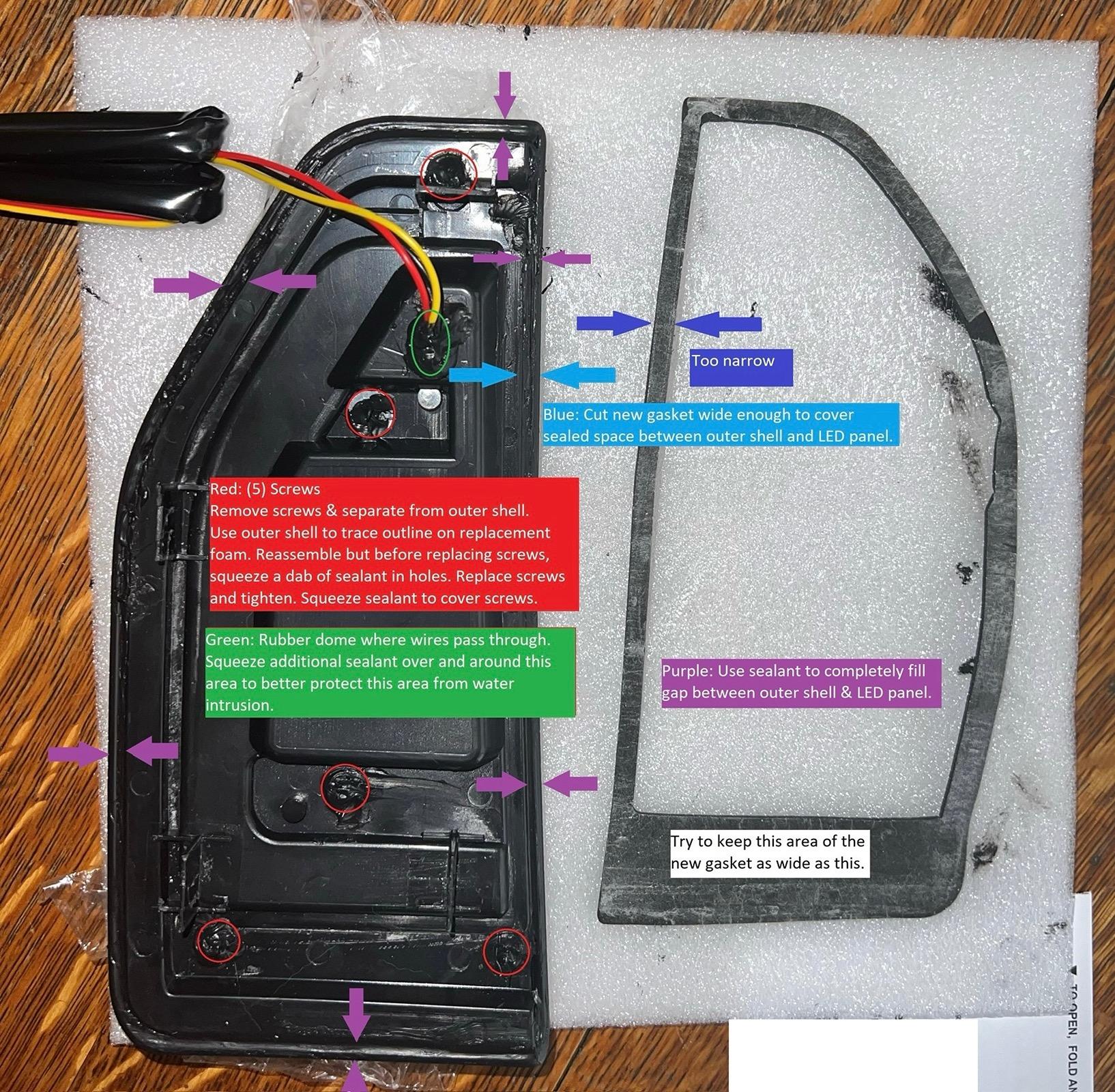

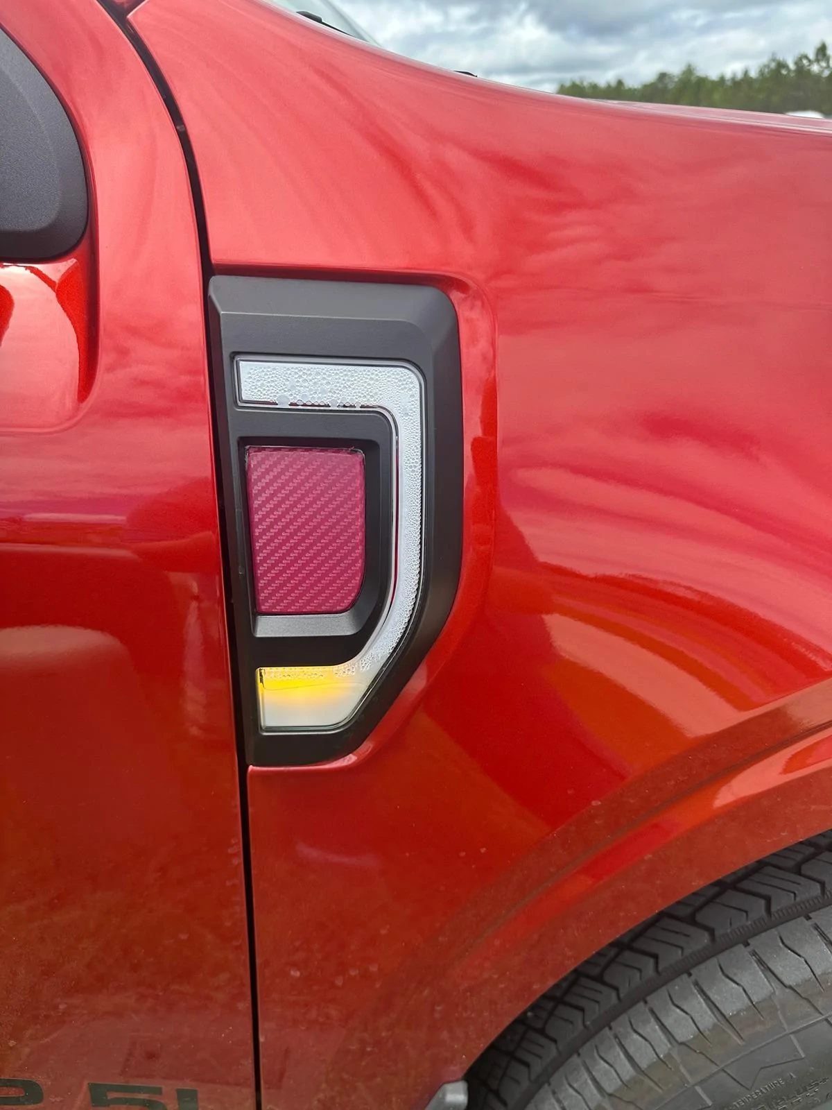

I added this to my write up I posted the other day…

Ok, so now I can totally understand why these things get moisture inside. They are not built to keep moisture out!! Period!! You don't need water to make these things get moisture inside. Humidity alone will do it. From what I am seeing, they are not manufactored to handle the variations of temperatures.
What is on the left side of our trucks? Something on the passenger side (left side) is drawing heat to this area and causing these things to leak and absorb moisture.
This is just my opinion, but from my own history of buying aftermarket tailights and headlights, when the quality was poor, they always absorbed moisture.

I contacted Ryan with pictures of the moisture inside. He immediately sent me a new set FedEx 2nd day! This time before installing I sealed all seams with silicone.
How is your modified set holding up so far?
