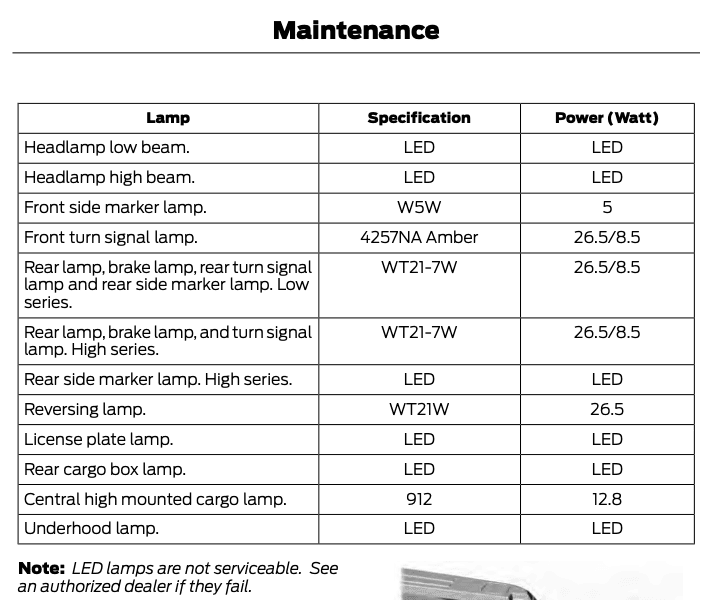

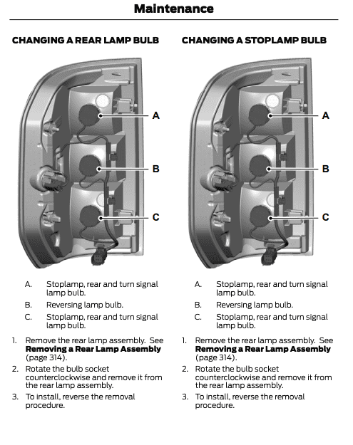

The flasher bulb is 4257NA spec. Just like @Dallas Maverick posted for the front, the rear is serviceable as well (more easily).
Note that the front LED headlamps are not serviceable w/ non Ford LEDs (per Diode and the manual).

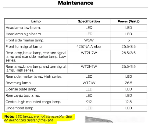

Is it safe to assume that the Signature lighting on the Lariat in not replaceable?
If something were to happen to it, would you have to replace the headlamp assembly?
EDIT: Oh wow, I just saw this.
Ford Maverick Aftermarket LED front turn signals 1633624333796
right now, I replace low beams (Halogen) in my car every other year or so. I hope that with the switch to LED, this is something that I'll never have to do again.

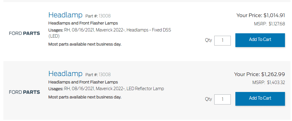

$1,000+ to replace the headlamp assembly on this thing.
I assume insurance won't cover a bulb if it burns out.
The LED reflector lamp at MSRP of $1.4K seems like the XL/XLT assembly
Lariat is the Fixed DSS - doesn't make sense that it's less.. Am I reading that right?
