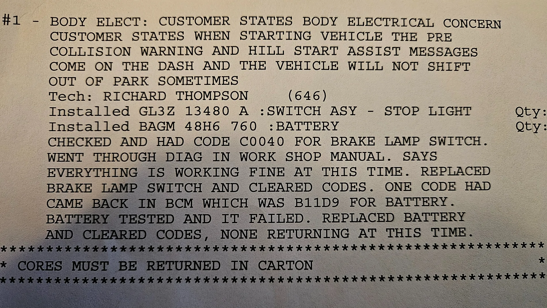

So here is what they found this morning and replaced
Battery
Break switch
Here's to hoping the problem goes away
I want to thank everyone for the input. it was extremely helpful I went Into the dealership this morning with no your fixing it attitude, with knowledge from the community of owners. Thanks again to everyone!
Battery
Break switch
Well looky there you battery abuser!

Its been checked a few times already
So far my battery has been good first thing they checked. Mine also wasnt part of the recall at all. I fussed about that already. I have amp and speakers installed, but it was doing this way before all that.

I know right I would have thought it was the battery after being in the shop 3 times
Yelp I was definitely wrong on that front. Thinking it couldn't be it. Assuming they would have seen it by now.
I guess the frustrating part of it for me is that the service department should have looked at the battery condition first. Then started replacing parts.
I would also ask them if they can increase the 12 volt battery charge to at least 90% if not 100%.

4 days for me was the first time. They got the shifter part fixed. They did a battery and break switch.

Well its not fixed just got stuck in park again same warnings again
So, new battery and gear selector switch didn't fix it.
Are there any other dealers near you to take it to?
If your dealer has more than one, switch Service Writers.
