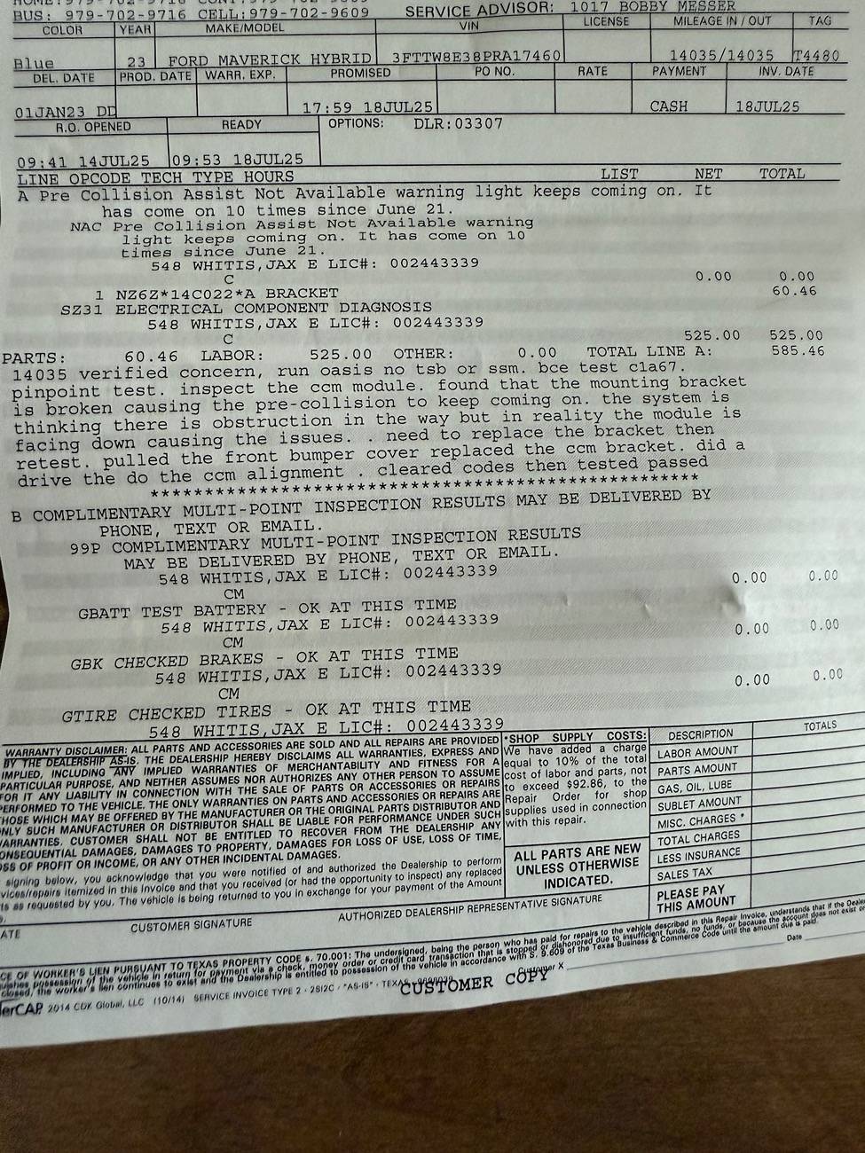

Nov 4, 2021
198
149
College Station, Texas
2023 Ford Maverick Lariat Lux Hybrid, 22 Escape
Update: after going around and around with the dealer, they are claiming that someone either backed into the front of the truck or nudged to break brackets. I pointed out AGAIN, that the sensor box was not cracked, grill not broken nor any scratches on the bumper to indicate someone bumped it. But I needed my truck, so here is the receipt and the video of the area. Thanks to everyone’s help. I’ll take it up with Ford
