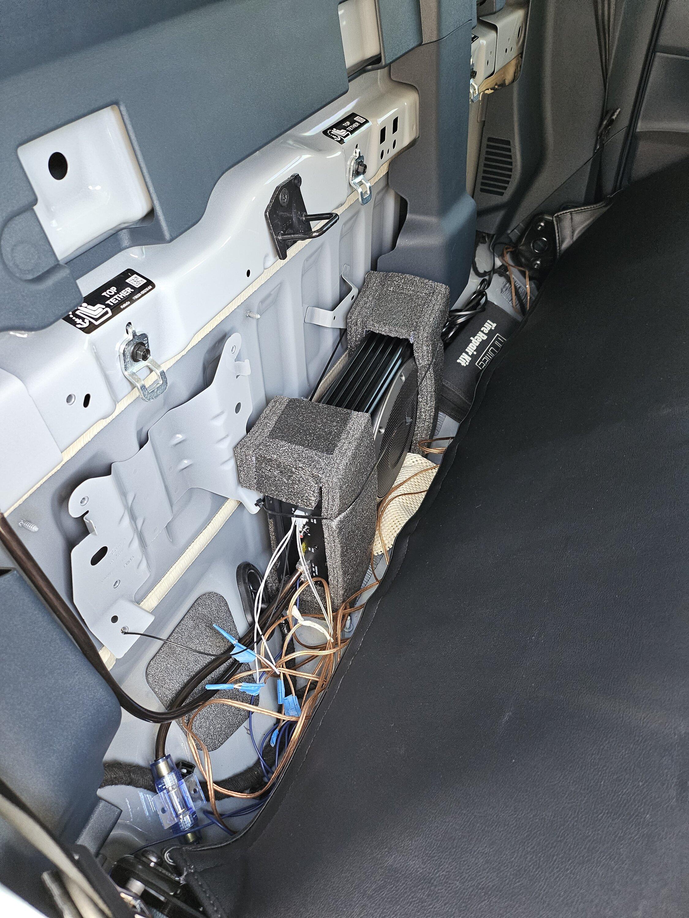

This is how the sub is mounted for the moment. After testing it and make sure everything works, I'll make a permanent mount for it that doesn't take the scissor jack. (Spoiler: It works!)

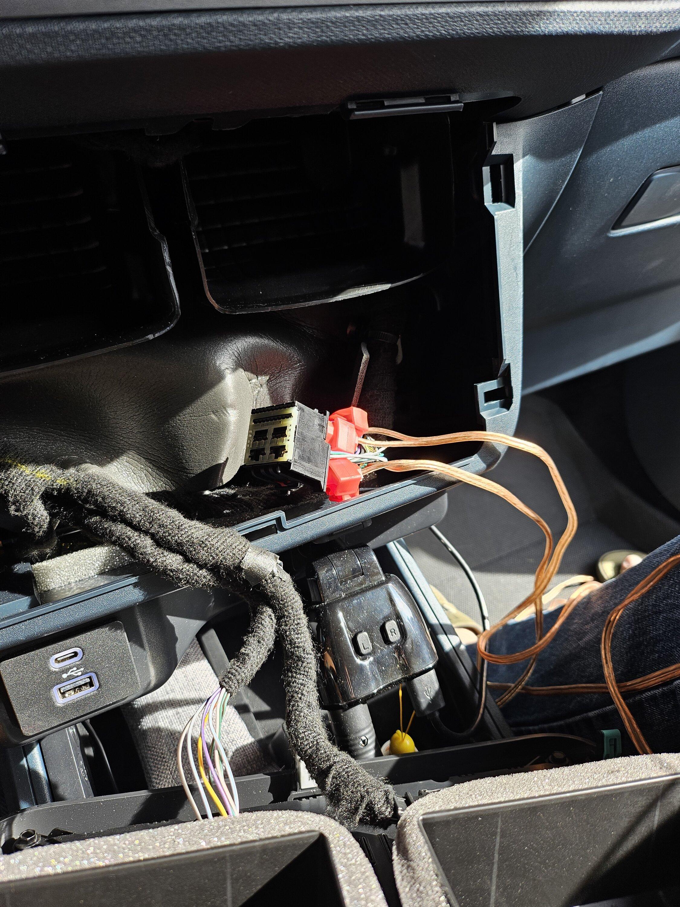

This is where I tap the wire for the speaker level input, which is the radio harness behind the HVAC control panel. I could've tap into the rear speakers, but I'm afraid of audio interference.
For the remote turn on wire, I used fuse #1 under the passenger footwell, which only gets power if the key is set to the "On" position. Fuse #3 or #6 should work as well, except it's micro 2.

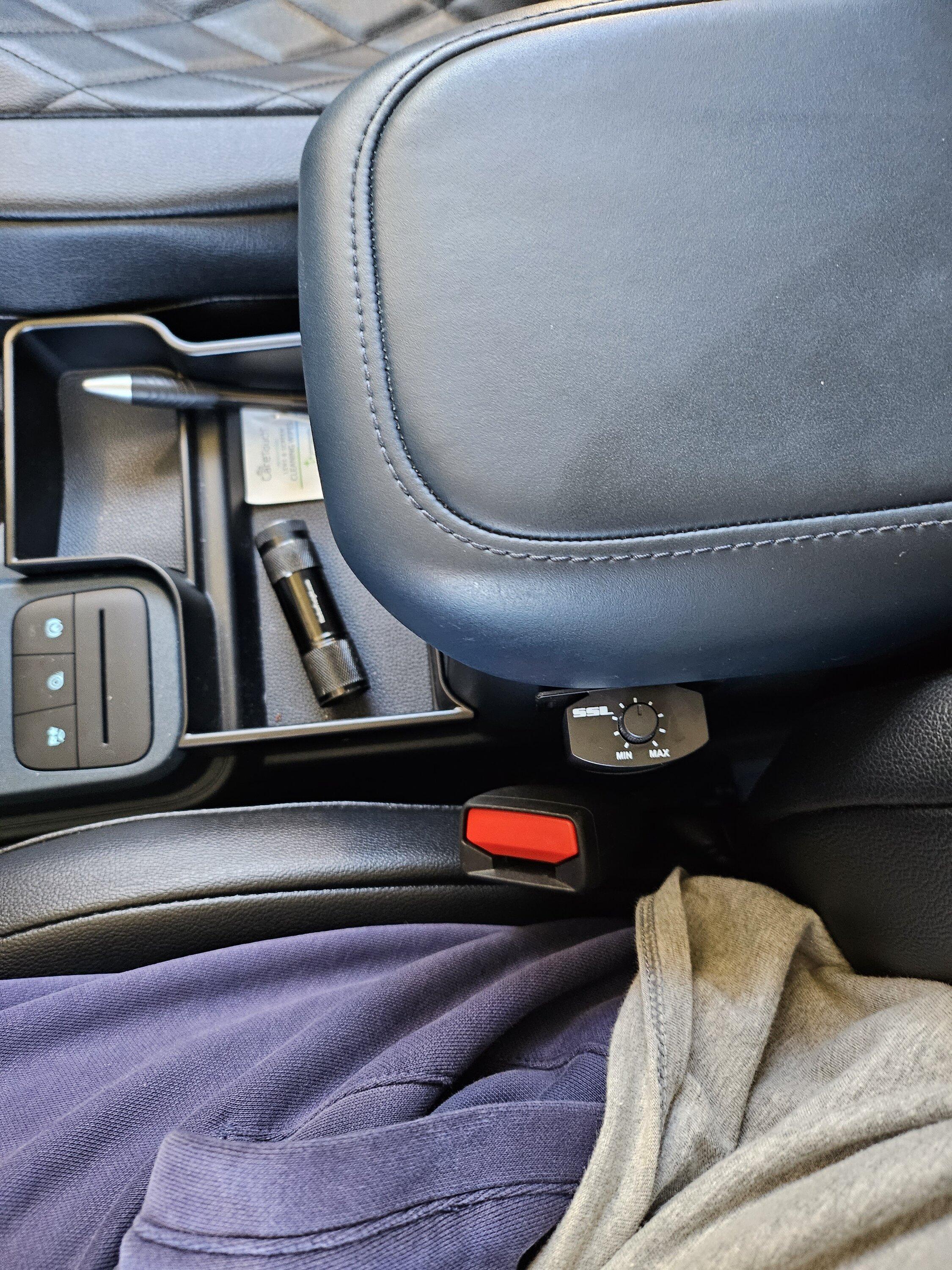

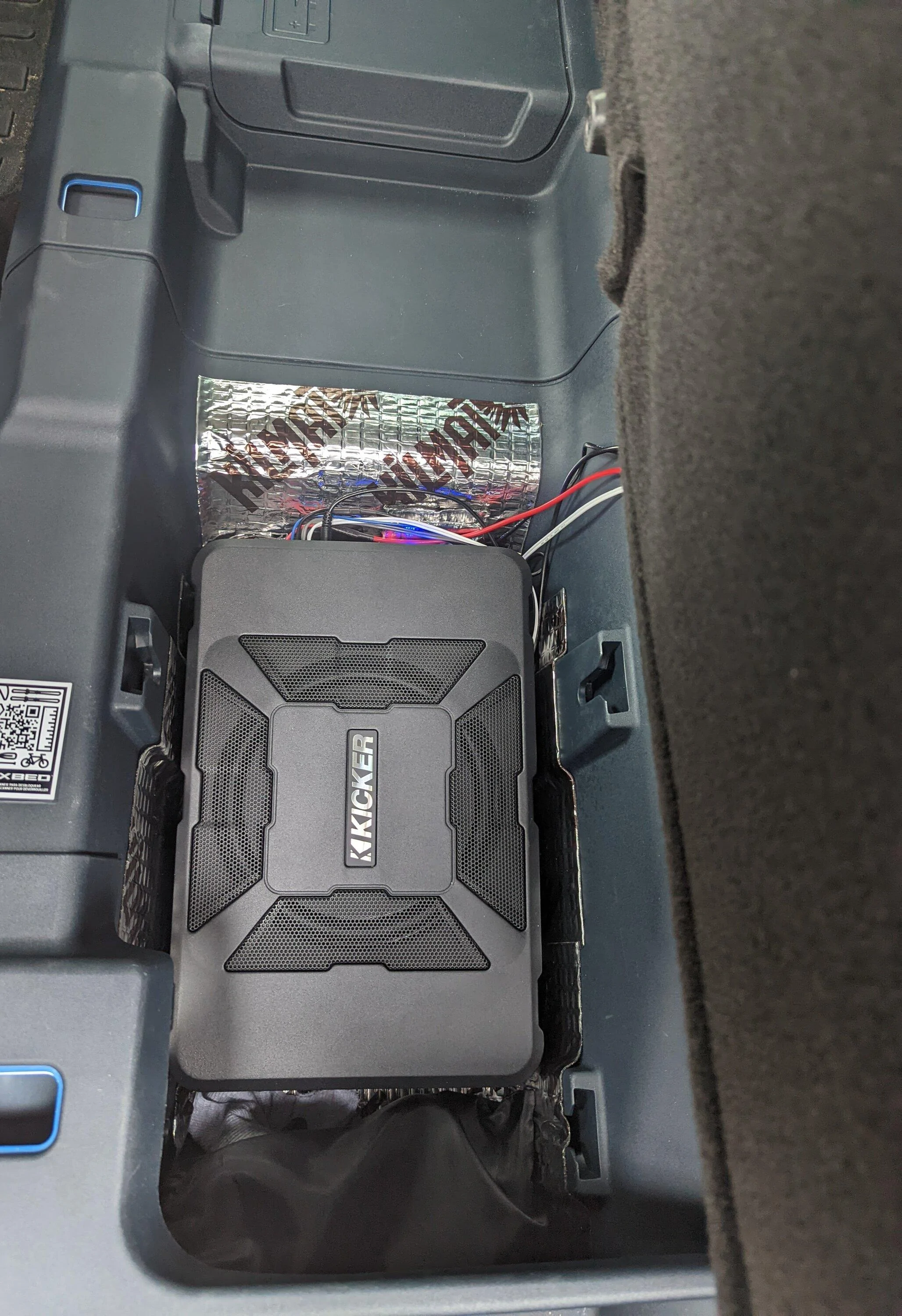

My Kicker Hideaway 8 sounds great under the back seat. Doesn't fit perfectly, sits at a bit of an angle. I mounted the Bass control under the console USB port area where you can't see it.
Got it Open Box at BestBuy for $165. Available for $210 now Open box Excellent.
Looks good, mine just barely fits in there lol.
