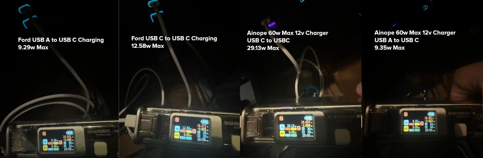

I have a battery bank that displays input and output. I’ll drain it a bit and check what the truck is outputting. My guess 15w max.

This was with the only USB A to C I had on hand so it may of been a limit, but I doubt it. The USBC to C was an Apple Cable.
12v Ainope Charger on Amazon

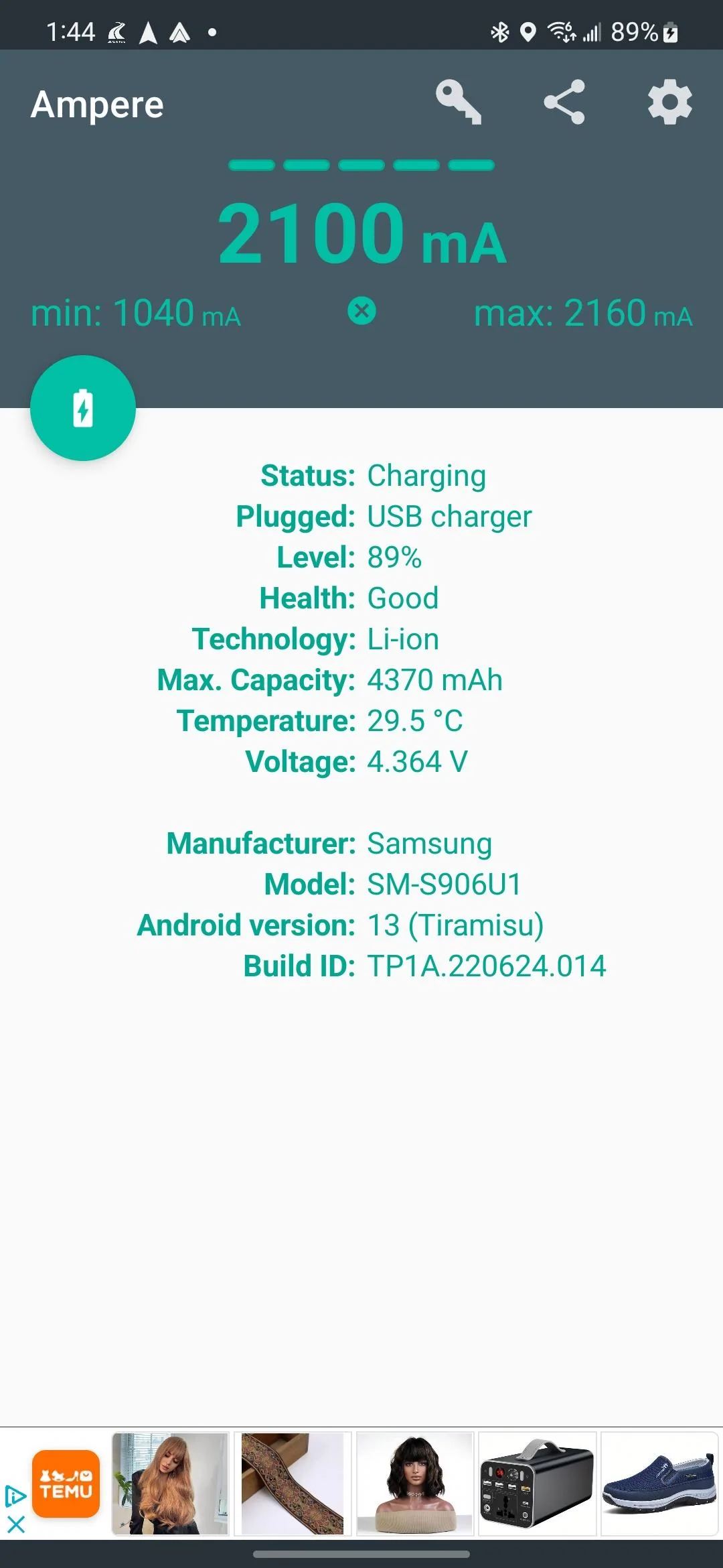

Just out of curiosity, I checked my charging rate when connected with the USB-C port. Not sure about wattage, but it was over 2.0 amps. It fluctuated somewhat. Overall, more than acceptable.

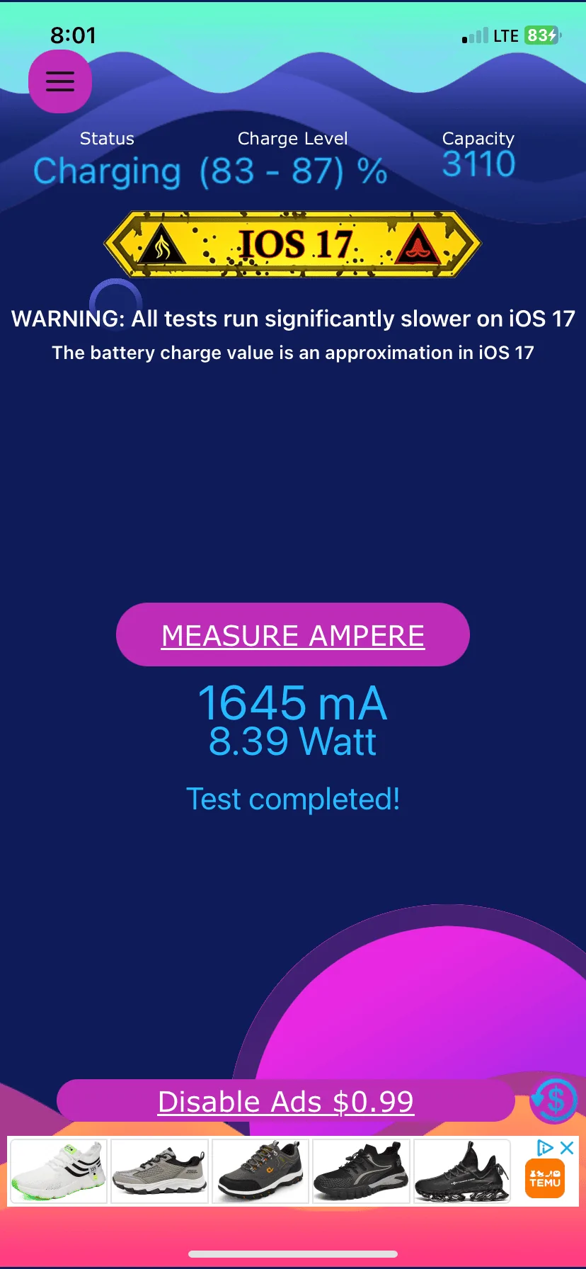

Sounds like all the iPhones are charging more slowly compared to the android phones. Does anyone have both types of phone and can do a comparison?

I have an iPhone 12, using the UsbC to lightning cable. It will bring my phone from a ~25% charge to 95% during a 45 minute drive, while using Apple carplay, maps and music.
