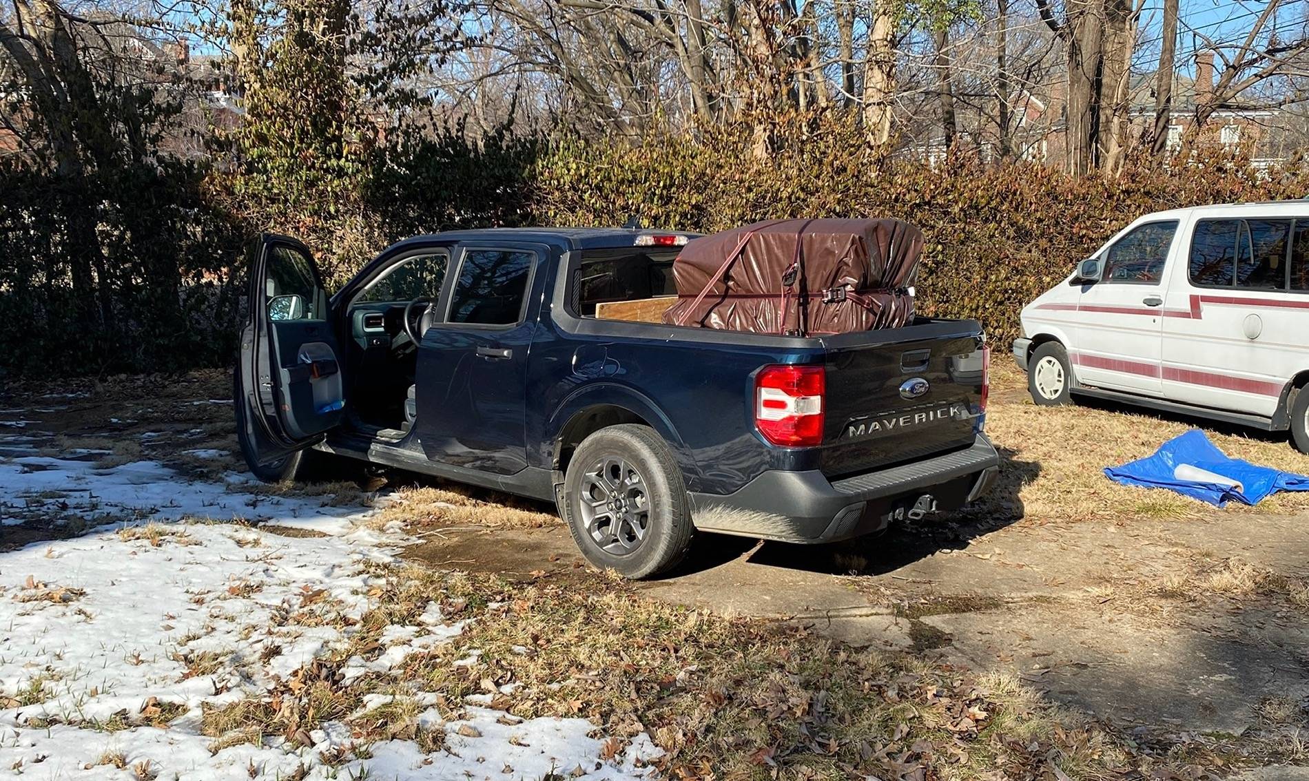

I put a diesel locomotive engine in the back of mine. I also had airlift air bags in the rear. Get some. They are like $120 and you can DIY without special tools in under an hour. Weight uncertain. But not light.
Ford Maverick Payload - 1800 doable? 24' hybrid IMG_9679
