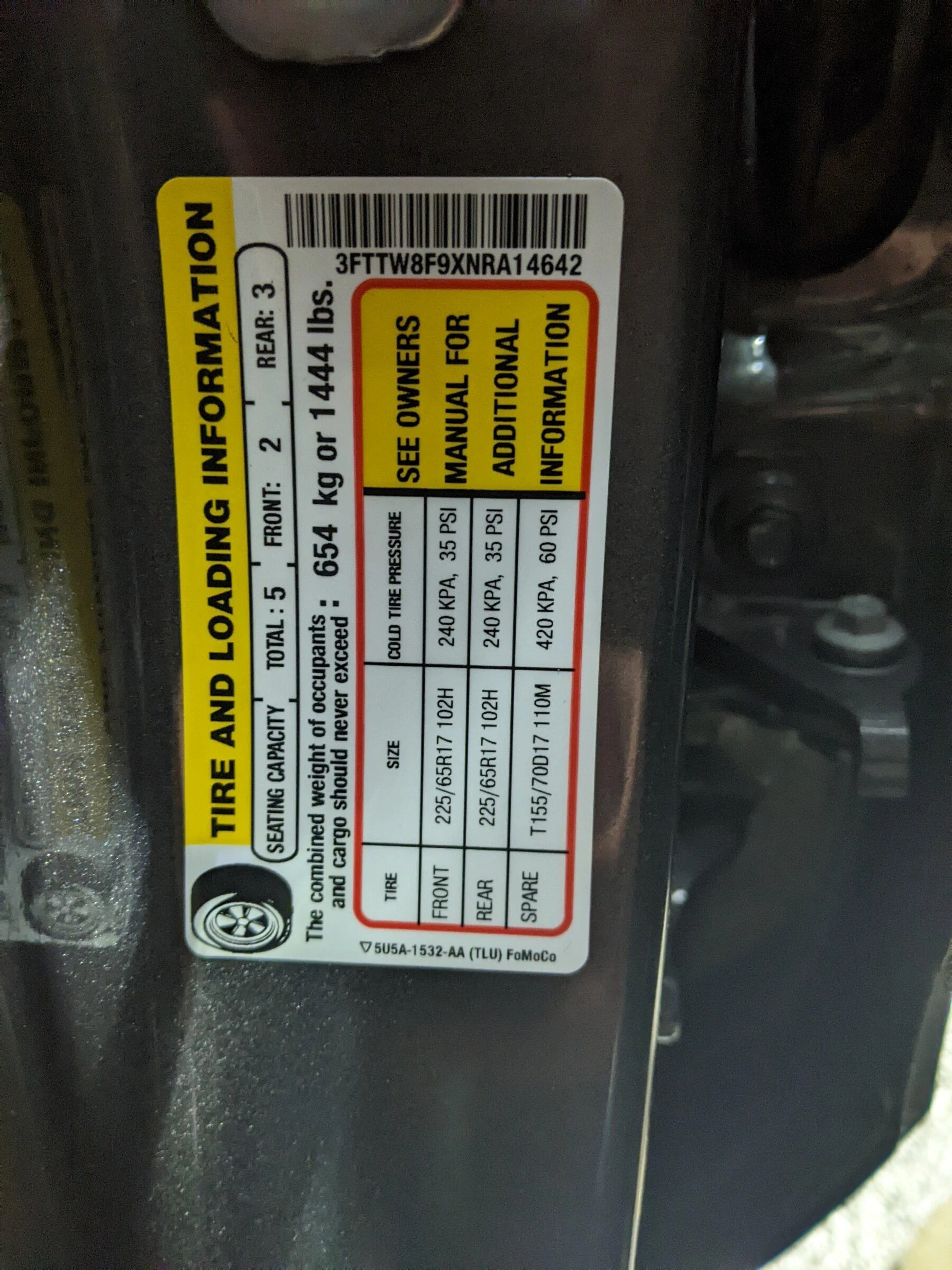

My AWD XL with only 360 and hitch receiver is 1498 lbs.

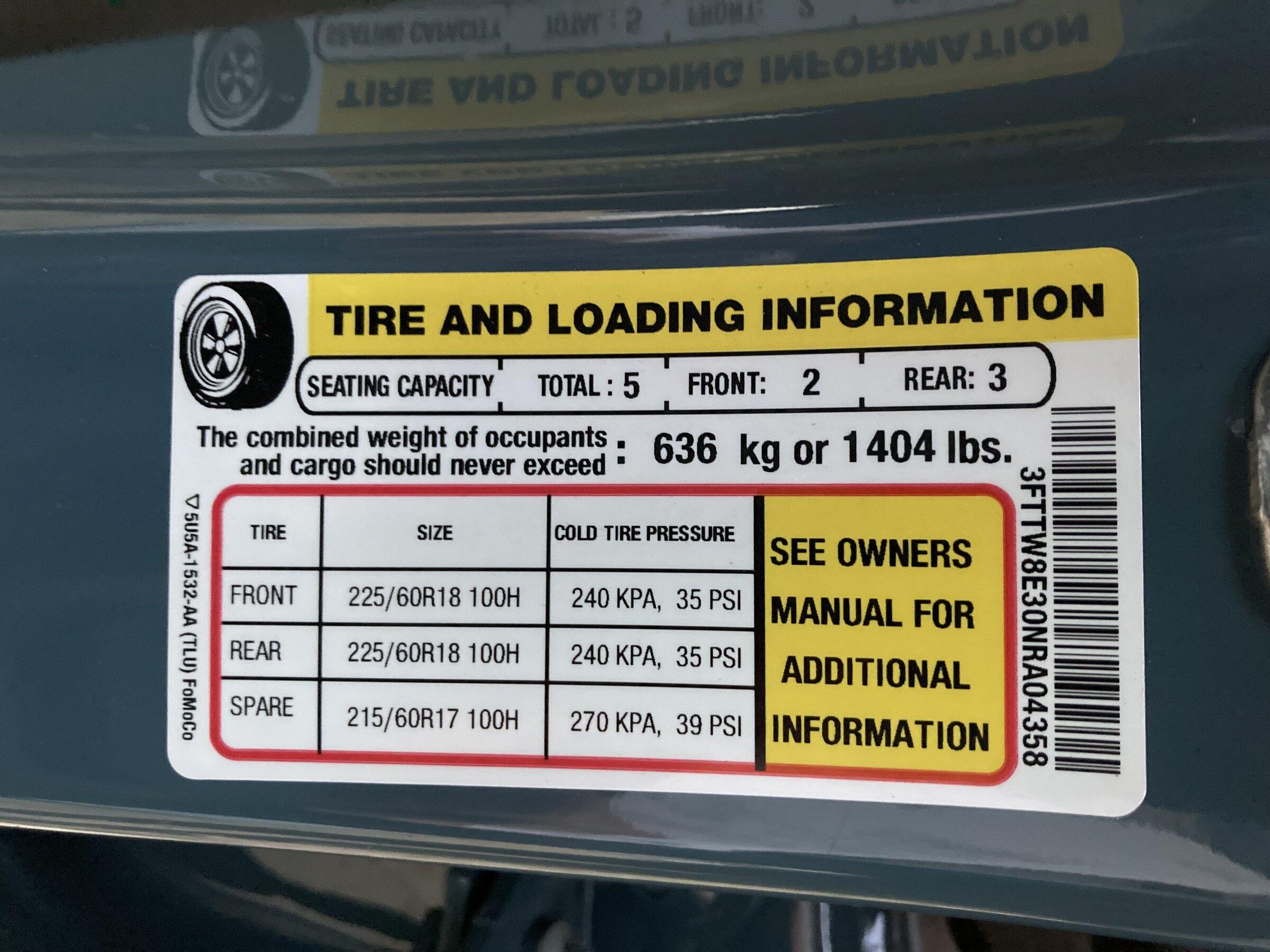

Just as an additional data point I have the EcoBoost Lariat, AWD, Lux and 4K tow package and my payload capacity is listed as 1343. So, it looks like the FX4 took a chunk off in your case perhaps?
I also added the option for the folding Tonneau bed cover which probably weights a few pounds although I doubt they actually include that in the sticker even though it was part of the installation at the factory?

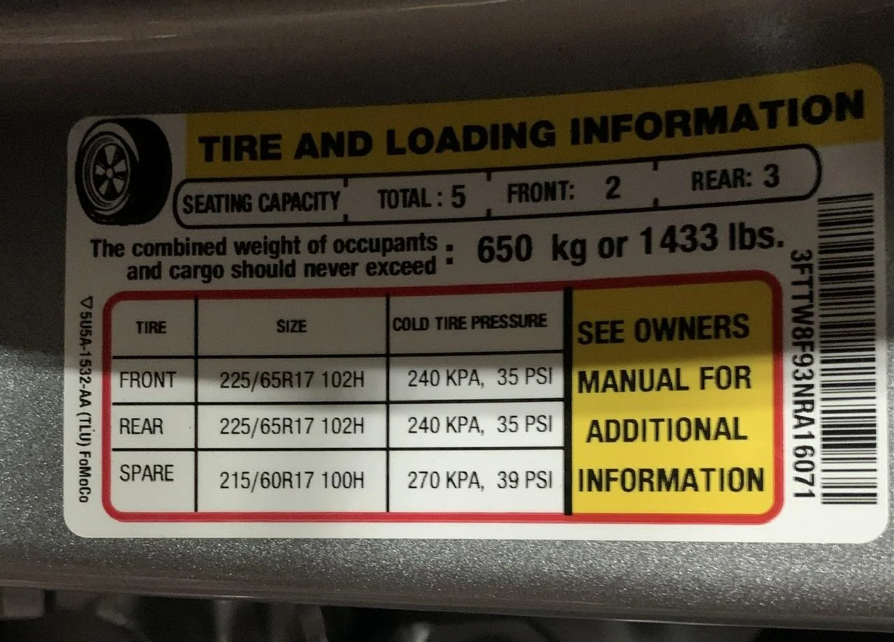

Well obviously he’s talking about eco boost since 4K tow isn’t available in hybrid or even fwd anymore. Also here’s mine I have xlt, cp360, moonroof, sibl, rear sliding window, fx4 w/optional wheels and tires @ 1433lbs. My opinion if’s you’re really that close to 100lbs limit that you’re probably not interested in buying this vehicle to fit your needs and maybe try a ranger with more truck abilities and will be discounted for the new model coming out?
