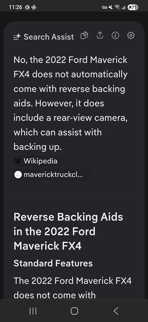

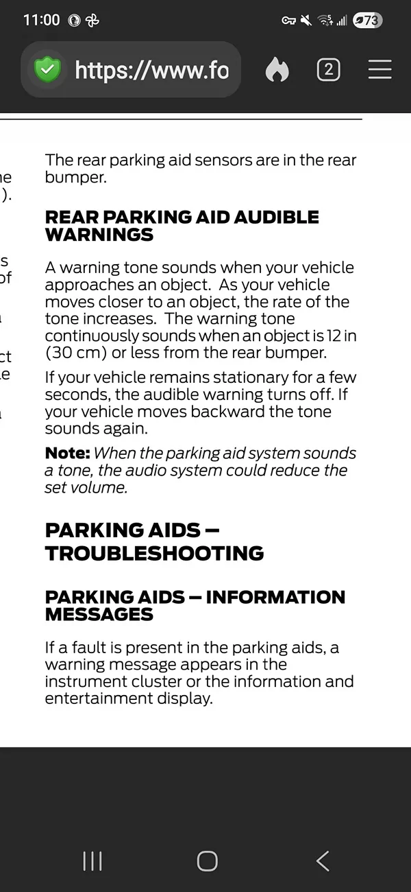

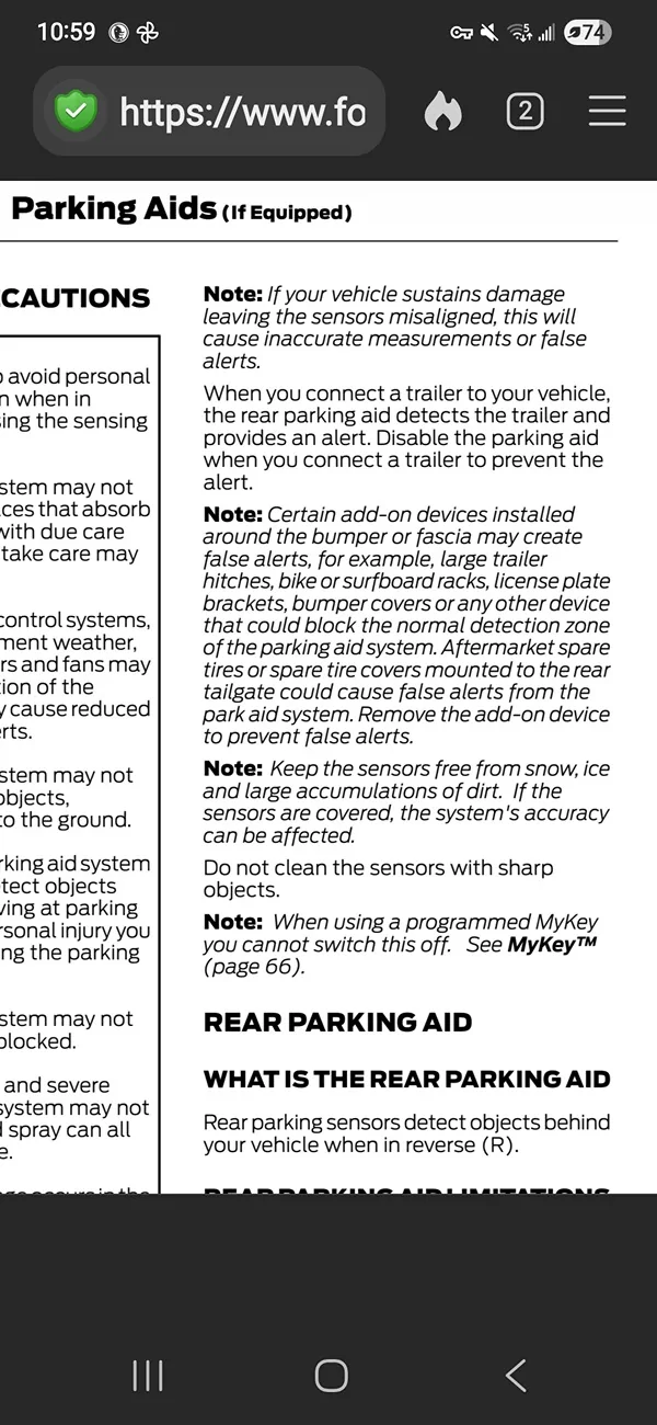

If the OP does return, and reads the replies, only they can post a pic of their bumper (a la Glen Baker LLC post...to see if they have the sensors installed, I assume?). Or confirm they have the Luxury pkg which includes the sensors and audible warning.
From what my quick search indicates as well as a quick look into what I hope was the right manual, the FX pkg doesn't come with the rear backing assist in a 2022.
The manual also indicated that you can not shut the system off if you have a coded key...though the sound can be affected by the sound setting on the audio system.
So, via their audio system, if they do have the appropriate luxury pkg/Co-Pilot package on their FX Mav, the sound may have been affected negatively in this way.
Of course, what is a post without some photo's of Maverick Manual pages that everyone likes to see, eh? And is familiar with in how to use it....right? 😉
