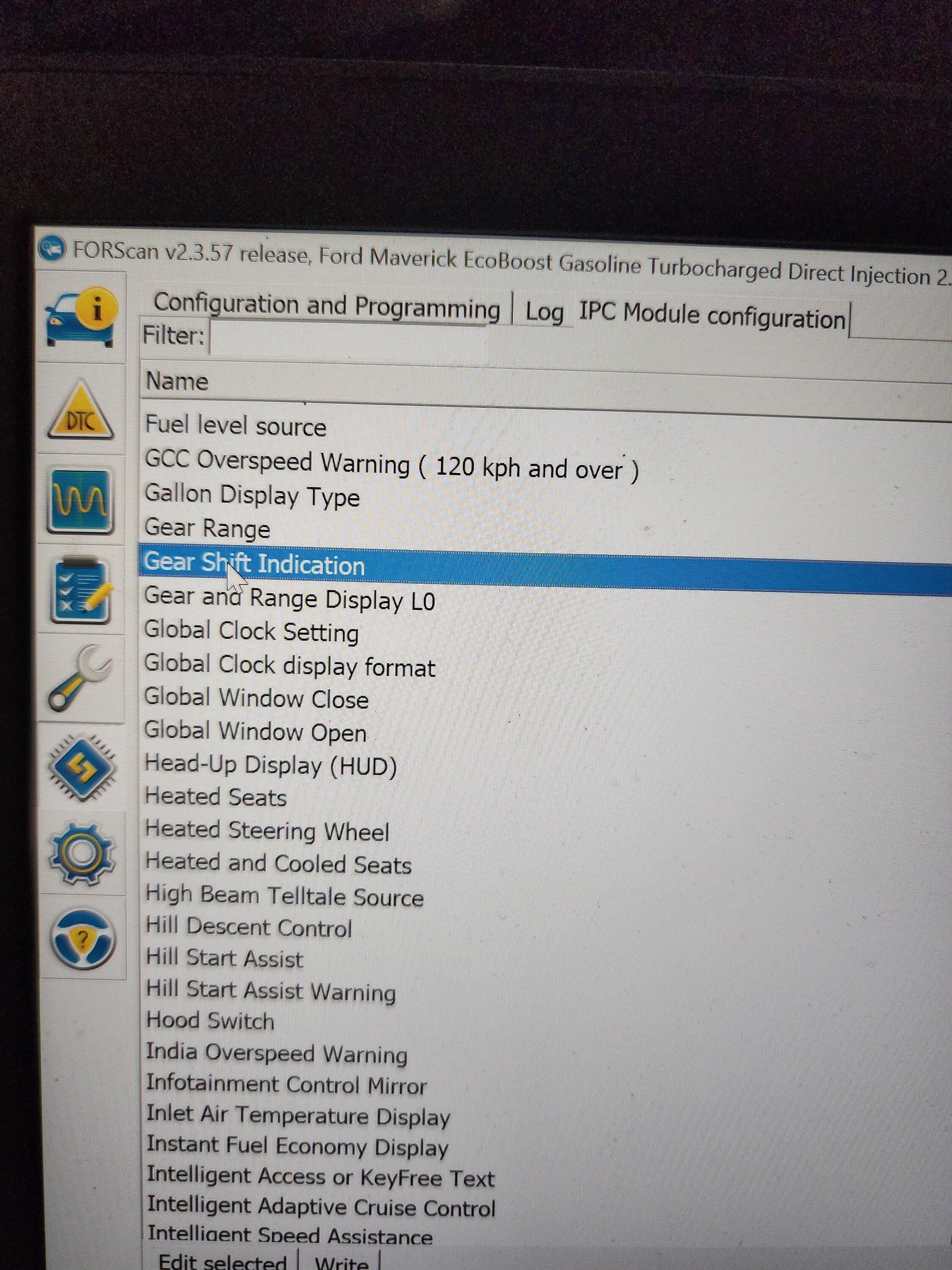

Install everything back toghether the same way you took it out. Next i will post Instructions for enabling with forscan. be patient with me.

I got everything wired in and somewhat working. I'm waiting on a forscan license mine expired. But the shift up works but not down shift.
I tried to switch the wires around to diagnose it and then both didn't work. Not sure if it's a issue with my paddles or how the down shift actually functions. Up does work tho. I'm kinda confused. I'm going to unplug the connector and run a 12v through the wire to see if there's a good connection on both ends.
Weird . Make sure you put the pins on the right place dont trow power . A better test i suggests doing its and ohm test. More safer with but conectors disconnected too.

I just got my forscan done. And still same thing. No downshift. Hmmm weird. Now I was tinkering with deleting stuff off my explorer dash I don't need like navigation in the menu that doesn't work and after changing a few things I'm getting a 4wd error
