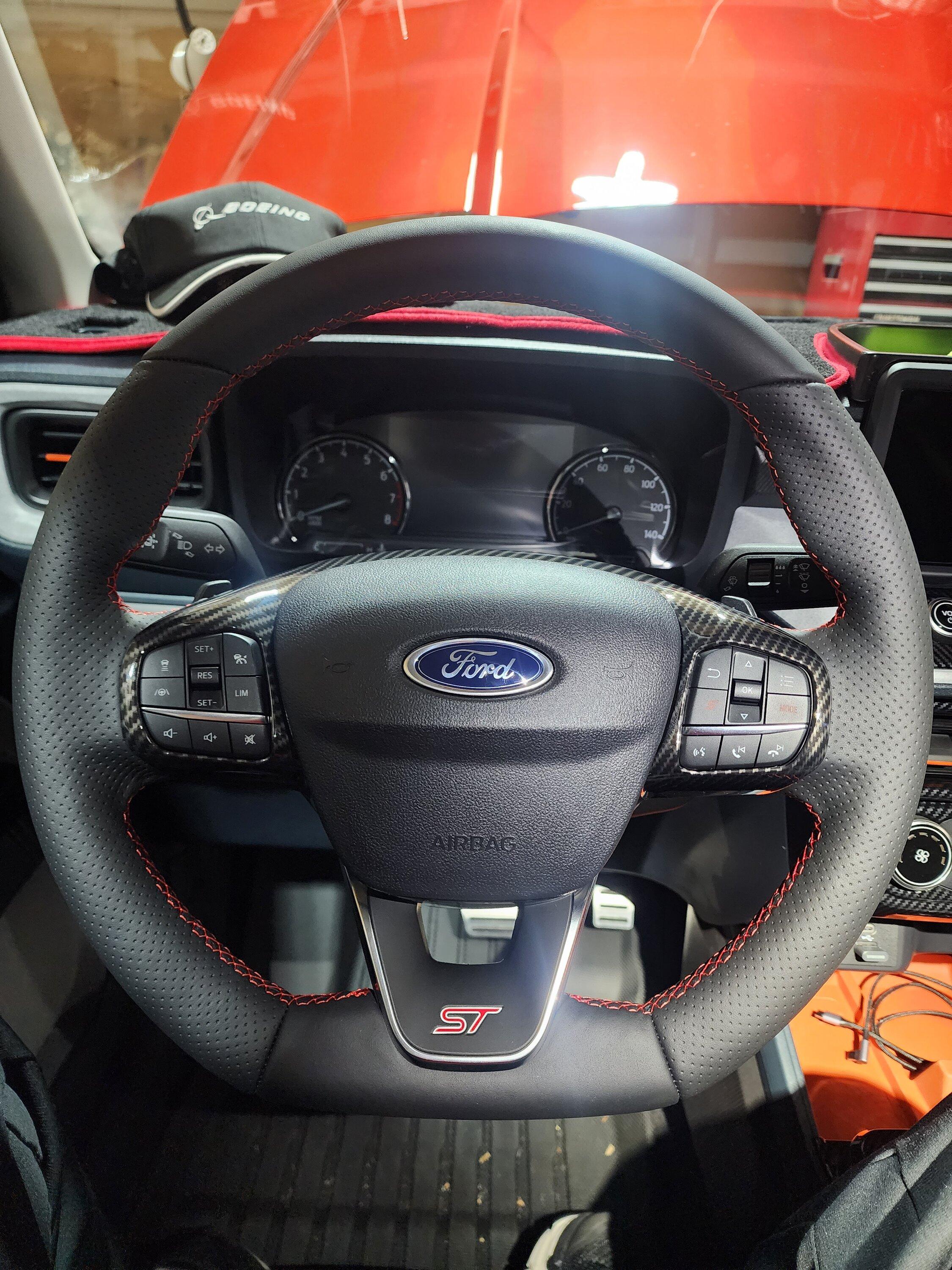

Finally had time to install the bezels and steering wheel covers lol.
Did you swap the switches cable from XL steering wheel to the ST wheel or did you leave it as is?

Thanks.. I just got my installed
I left them as they whey came with the steering wheel
Thanks... just got done installing my as we speak. Going to wait till spring/summer to do the wiring

Carbon bezel looks great.
Thanks.. Just went for a test drive and notice all of the steering wheel buttons not working. Does the ecu/computer needs to reset?
You need to put the codes for the swiches on the steering control module or swap the switches that you had before . With forscan
Thanks I was hoping it's a plug and play.
No those switches has diffrent codes and will not work with factory configuration. The codes are behind the switches . If i where you take the switches off and writte down the codes on a paper so you can find them for programing.
Thanks.. decided to switch stock switches and all is working now.
