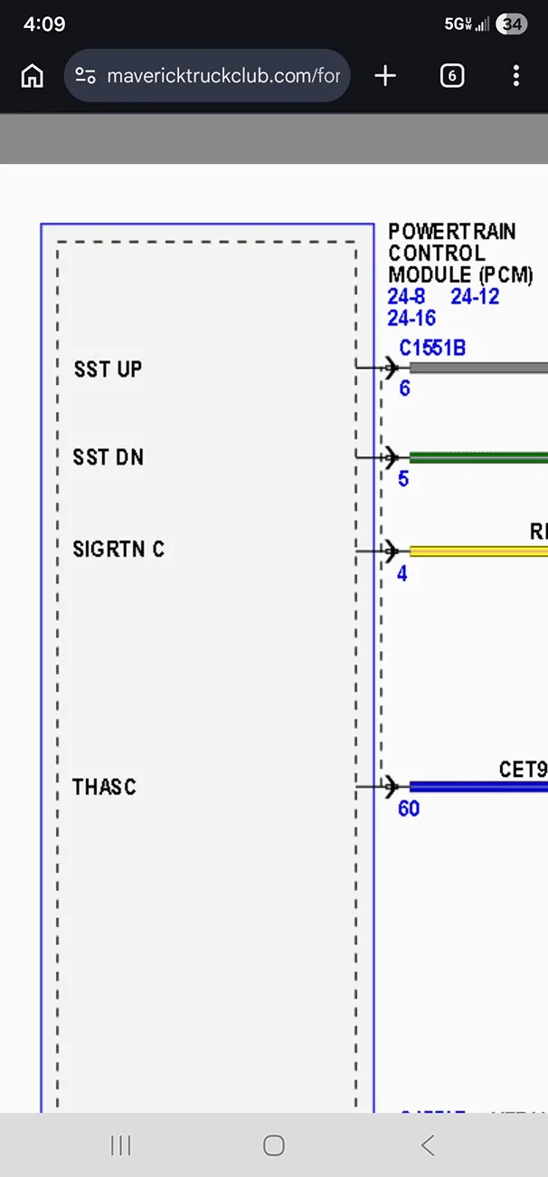

Awesome! I have a p0443 code now. where do I find full diagram of the right pcm cable? Is cable 1 and 3 the only cables for the evap purge valve? Might have to check the harness I didn’t touch those so I don’t know what is happening
Pin 6 and pin 5 on the Pcm conector
Sst shift up pin 6
Sst shift down pin 5

4 for signal return?
