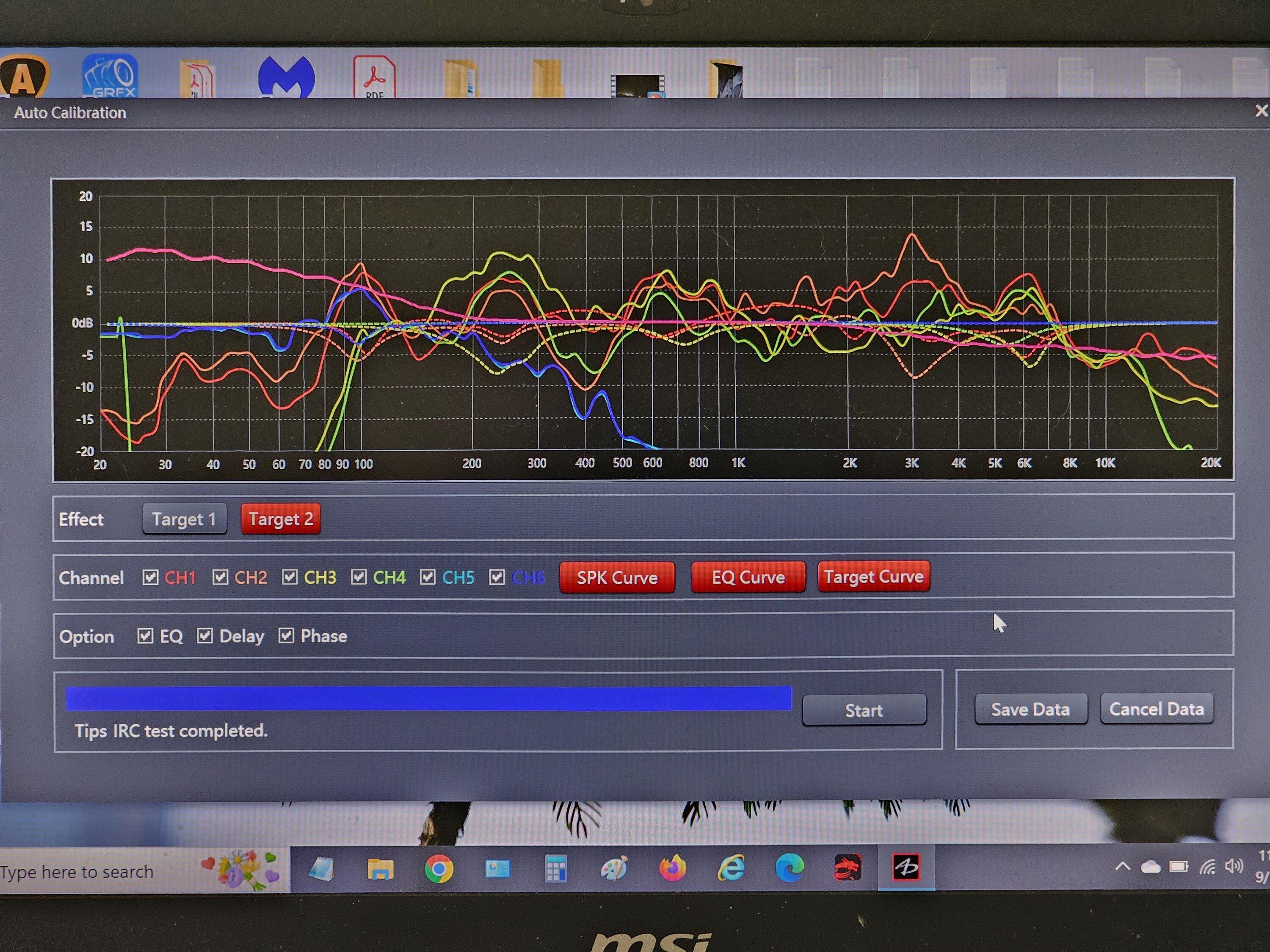

I think we might be overlooking something here. How is your input to the amplifier set up? Are you using high level inputs? Which speaker channels did you tap into? Are you using any type of line out converter? I think there's an issue between the source and the amp causing your problem.
Using high level inputs directly to the amp. Used both the front and rear speaker channels to retain the factory fade function, etc. The amp creates the sub output from all 4 input channels. I bought a custom harness that simplified the hook up and pretty much made it plug and play.

Sorry for temporarily taking over this thread, I should of made my own.
One weird thing is some FM radio stations sound real good, compared to me using a USB drive with WAV files on it. Why would that be? I guess if a DSP or Kicker key is setup using the USB as the test file source it would be tuned to sound good using that input .
