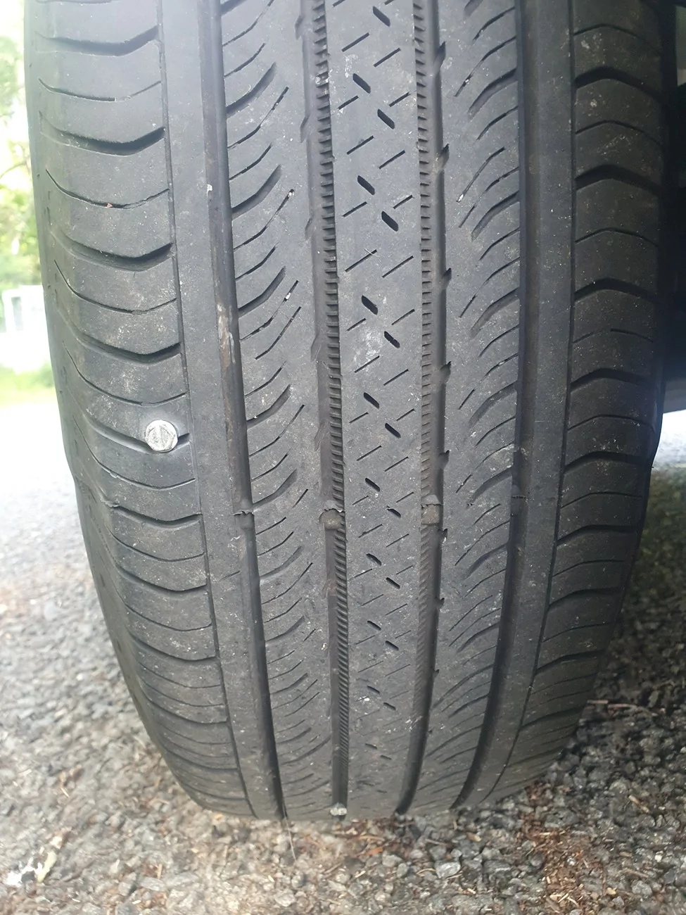

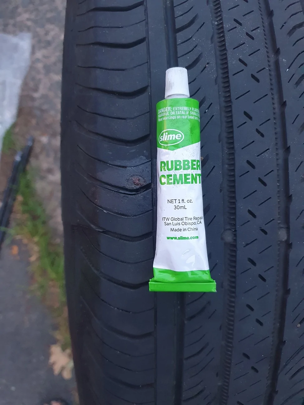

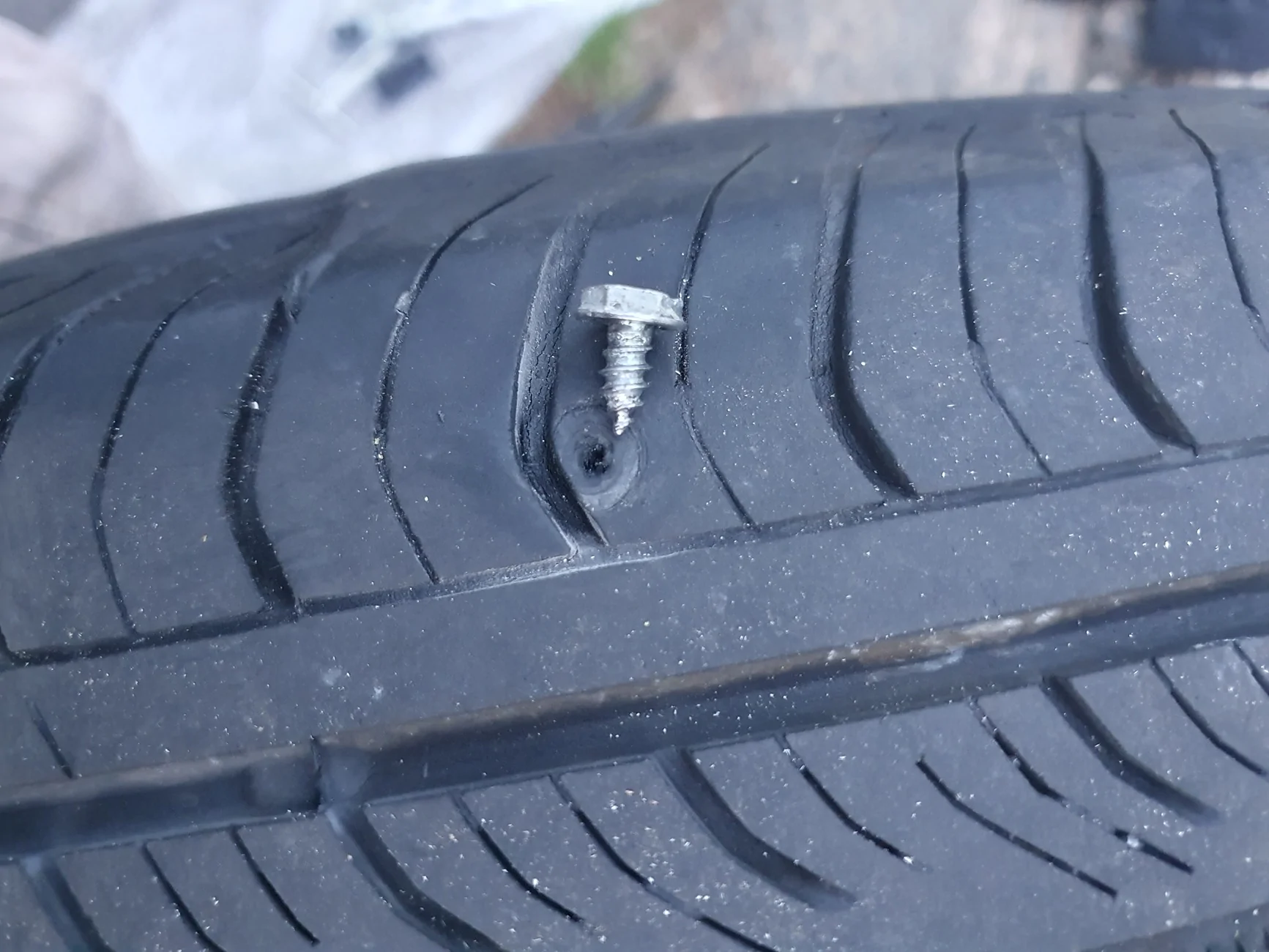

Had a screw in the tire, but no bubbles and steady pressure reported. Tires have <30k with 50k on odo. I should have just put the jack under it and removed the screw. Ended up being a 3/8 long machine screw in the shoulder and didn't need a patch. Instead, I barely drove for a day or 2 then took it into the tire shop on an appt. Waste of time. I grabbed a *patch kit on the way home and set it up in the street. Could have called roadside I suppose too. *I never actually had to patch the tire.

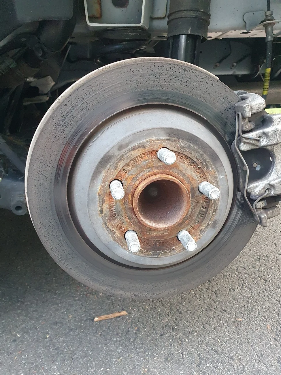

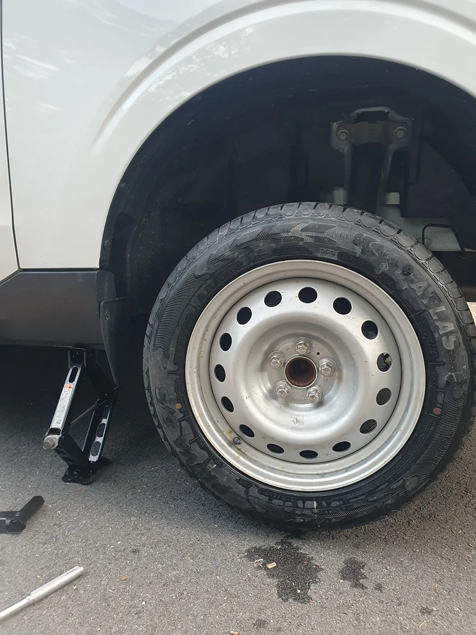

I decided to drop the spare and rotate the tire to the rear. Again, totally frivolous besides gaining experience. I rested the spare on my head so that 2 hands were free to undo the blue cone and metal retainer. It does get easier with practice. The only tools I used were from the car besides 2 bricks to chock the wheels. So 2 extra chocks are on my list to buy and put under the seat. I've added 5-10 tools including a small 46 piece set, breaker bar, extender and lug socket, flex head ratchet, universal socket and gloves.
Tire seems ok but now it's on the rear driver side. Somebody said that might be worse to have a rear blowout. I can get a used tire for about $50, or just monitor. Still have to torque both wheels to 148 lbs.

First off, a hole that size wont cause a blow-out , second is, that tire will be worn out before it ever leaks again .I have plugged many tires with a hole like that and ran them many years and mile after. Just keep a watch on the air pressure .

I agree, and if the plug starts leaking it will likely happen during a seasonal temperature change. If that happens, just plug it again.

Replace 2 tires at that point, right? Plugs work. It’s not a sidewall puncture.
I wouldn't replace any. I would just keep driving on the plug and checking the pressure, especially since, as you mention, it's not a sidewall puncture. I always replace 4 tires at a time unless I have complete loss of a tire at low mileage.
