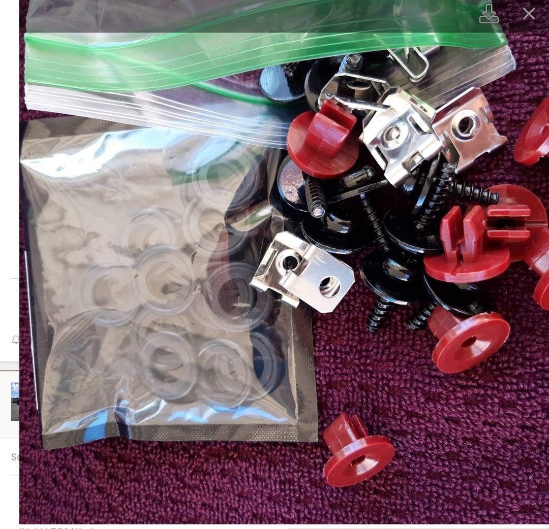

I am sorry, I do not have the link anymore either Amazon or Ebay.
I bought a bag of metal spring nuts. plastic push nuts and screws, along with a bag of oil and drain plug washers. Just to have on hand.

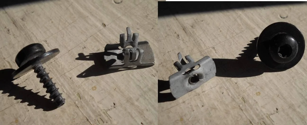

Unless yours are different..
They are "Metal" not Plastic...
Ford Maverick Oil pan shield bolts stripping out Engine Shield fasteners
I forgot one, on my last oil change... :confused:
They are of a "Cheap" design..
I have seen these before, (I did post on these in another thread, sometime ago.)
This setup was/is used for attaching interior trim panels... (Rangers).
I will "Hand-tighten" the screw/bolts before snugging them tight. With any kind of wrench.. ;)
You would have to find, a "nut" that will stay retained in the sheet metal.
Of the underframe...

Amazon bag looks like:
https://www.amazon.com/dp/B0CN3BW9Z2
Engine Splash Shield Guard Undertray Cover Screws Bolt Nut Clip Torx Pan Head SEMS Tapping Screw for Ford W702413-S450B W702438-S300 Lincoln Continental
Ford's inserts and screws:
W702413S450B - Fender Liner Screw - Ford (W702413-S450B) My XLT are TP27 Torx Plus
W718770S439 - Lower Shield Nut - Ford (W718770-S439)
