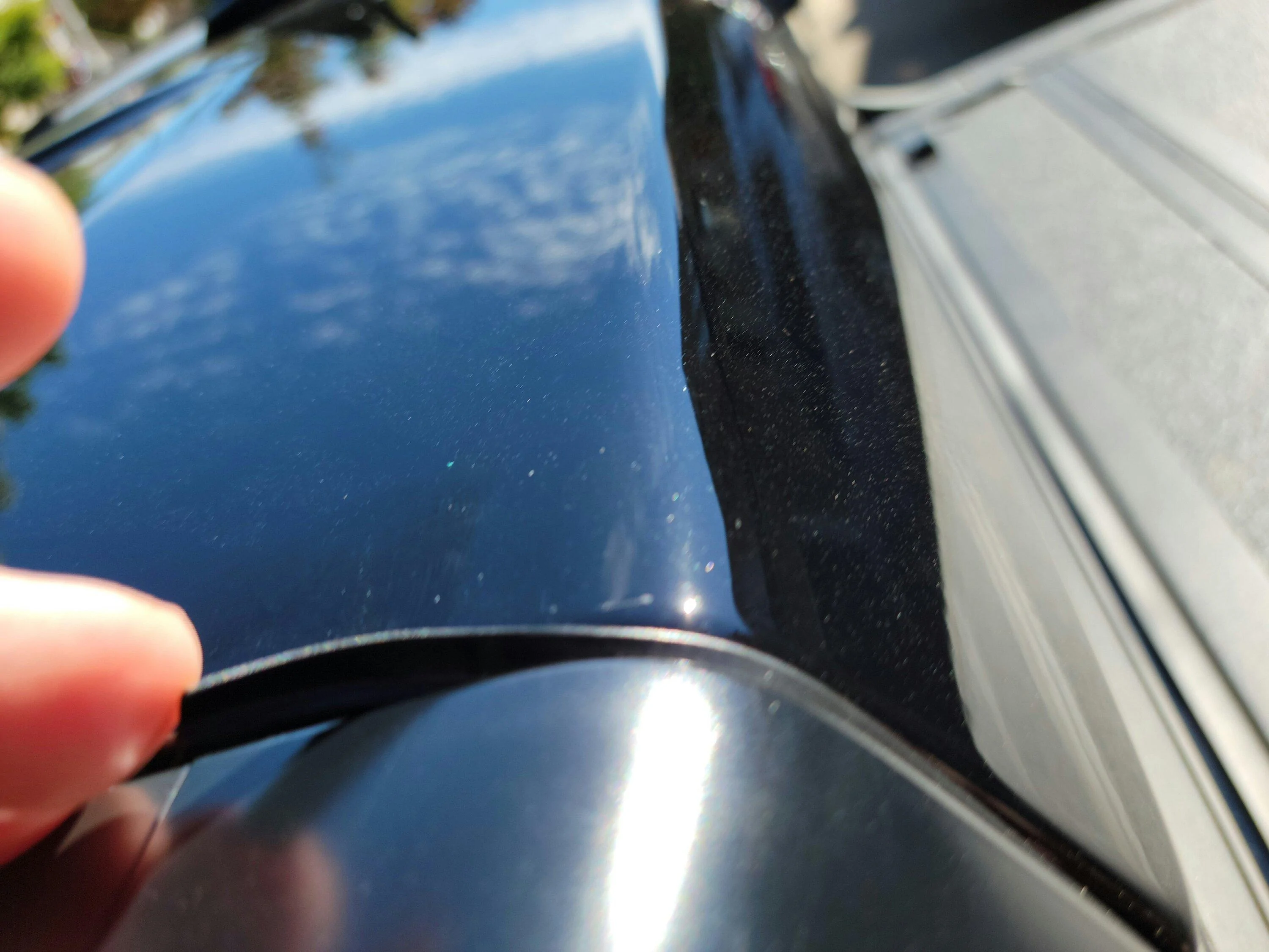

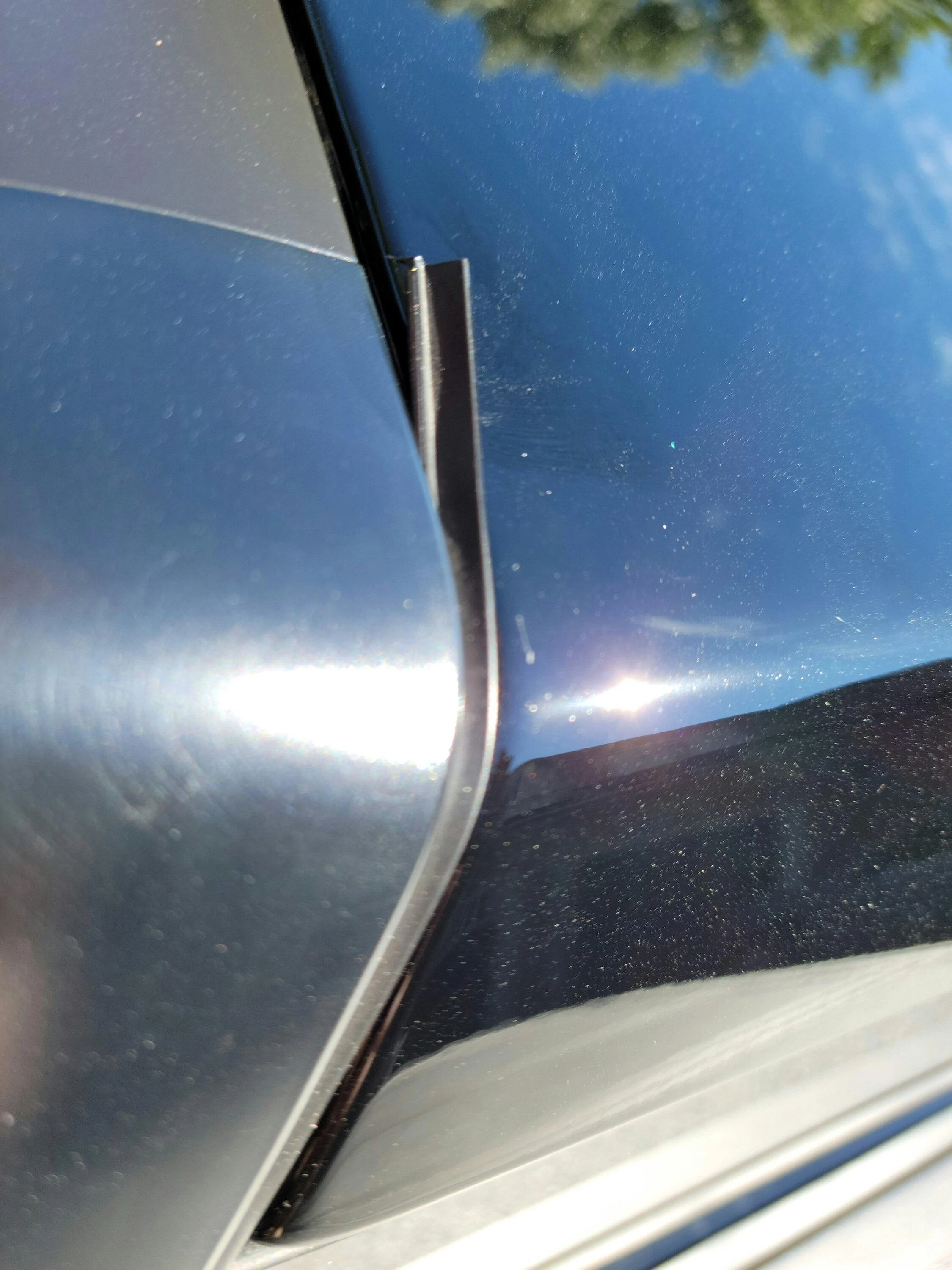

See pics. Near where the back seat and back window meet on the driver's side.
Not really sure what to do about this.

Maybe try some 3m double side tape or gorilla glue.

I've got the exact same thing happenning on the same side, no idea how to fix lol, I've trided popping the plastic trim off to reseat the rubber but it feels like it's going to break.

mine also came up, It has a small tab on it, I used a small thin screwdriver and pushed it back down, its holding for now. Will use some black rtv to secure it if it comes back up.

I would bring it back to the dealer. It should be covered under warranty,

I've restuck weather stripping with Flex Shot before, worked like a charm.
It should be, but I'm not going to wait a couple hours for them to fix something I could fix in a couple minutes. If it was in for a recall or something like then yeah, have them fix it.

Mine as well same side just pushed back in for now.

Ya most of ours is like that.

Same issue on mine. Didn’t someone say previously that the dealer replacement requires dropping the headliner?

Yep, it’s a known problem many have this (mine included) I had 1 side done at dealership & had a dirty headliner 😞 they took care of after I complained. Now the other side is doing it too. I have seen other posts on here if’s you search of many different “fixes” members have been using.
