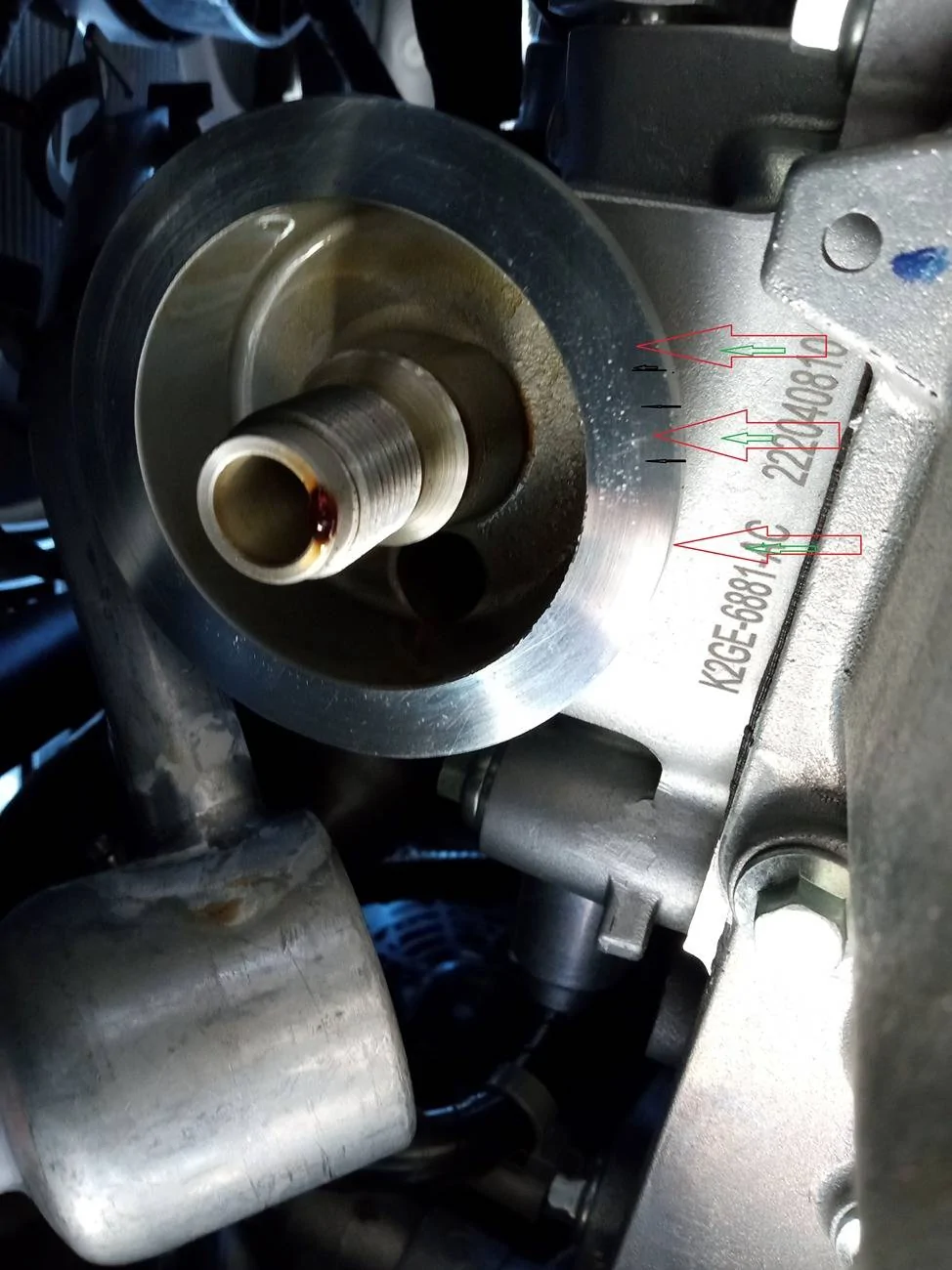

??????? No visible oil leaks or puddles in the skid plate or shield when you take it down? Any oil residue inside your tailpipe? The only thing that I have found on these engines related to leaks are porous oil filter housing surfaces. On my Tremor I noticed it on my first oil change and on another Maverick that I checked. The filters might be under tighten at the factory from what I have found. Make sure when you do your next oil change and after adding you 5 QTS that the reading on the stick is correctly calibrated.
Ford Maverick Oil light and engine light came on.. Maverick oil fiter housing
