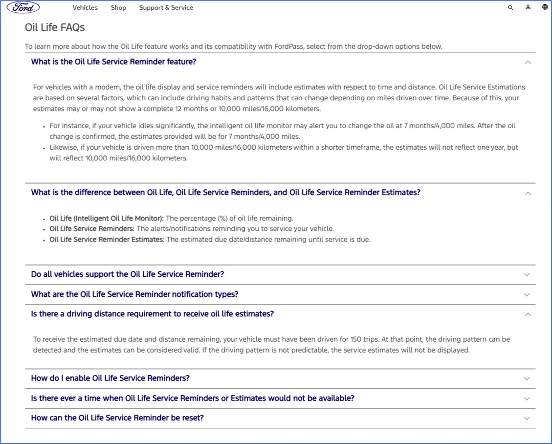

Ford/GM/many others – to my knowledge their OLM systems are strictly algorithm-based. Different companies, different things measured/calculations made. Engine temp, ambient temp, driving style, engine load, engine hours, idle hours, engine revolutions, number of engine starts, mileage from last OLM reset, time from last OLMreset. And probably others.
I don’t drive my vehicles much (~5k or less miles/yr each?), my OCI’s are basically time/convenience-based. Do an OCI at least once a year whether I need it or not. What day is good schedule/weather-wise for my DIY change, my Mobil1 EP on sale at WallyWorld, etc. Don’t do Blackstone-type oil analysis because in my case don’t require it. During the year, to make sure nothing amiss, periodically (every ~2 weeks or so) pull and check the dipstick for level/oil color. When driving watch my oil pressure gauge for any ‘anomalies’. Show a passing interest in what my OLM says I have in the way of remaining oil life but pay less attention to it than I do to physical checks and actual miles driven.
Believe that Mercedes and BMW’s (and Lexus?) do utilize actual oil condition sensors (measuring electrical conductivity, viscosity, contamination levels, sometimes even moisture content and acidity levels in the oil). Fords don't use these - If I’m wrong someone please give me a Ford part number (for any model) for any such sensor directly measuring oil quality. Ford’s still have dipsticks (thank god), if you have a car/truck without one then you’ve also got some sort of ‘oil level sensor’ (different than the check engine/oil can picture when you’re seriously low on oil/oil pressure).
And then there’s the FordPass app stuff. Found it mildly interesting that you need to have driven 150 trips to get estimated due date/distance remaining to have the Ford nanny remind you to get an oil/filter change. Not a fan of this (have something similar in my ’24 Silverado), but it is what it is.
