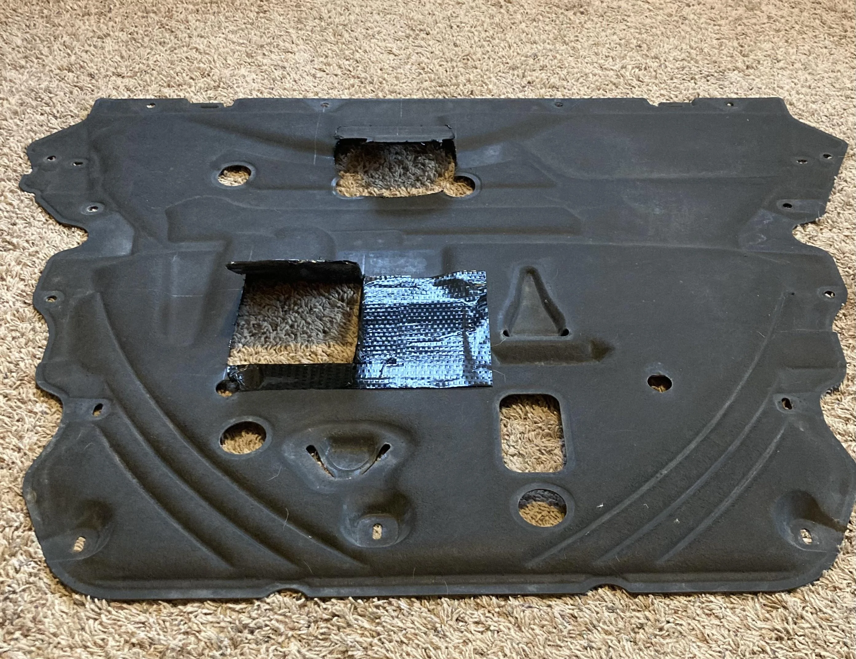

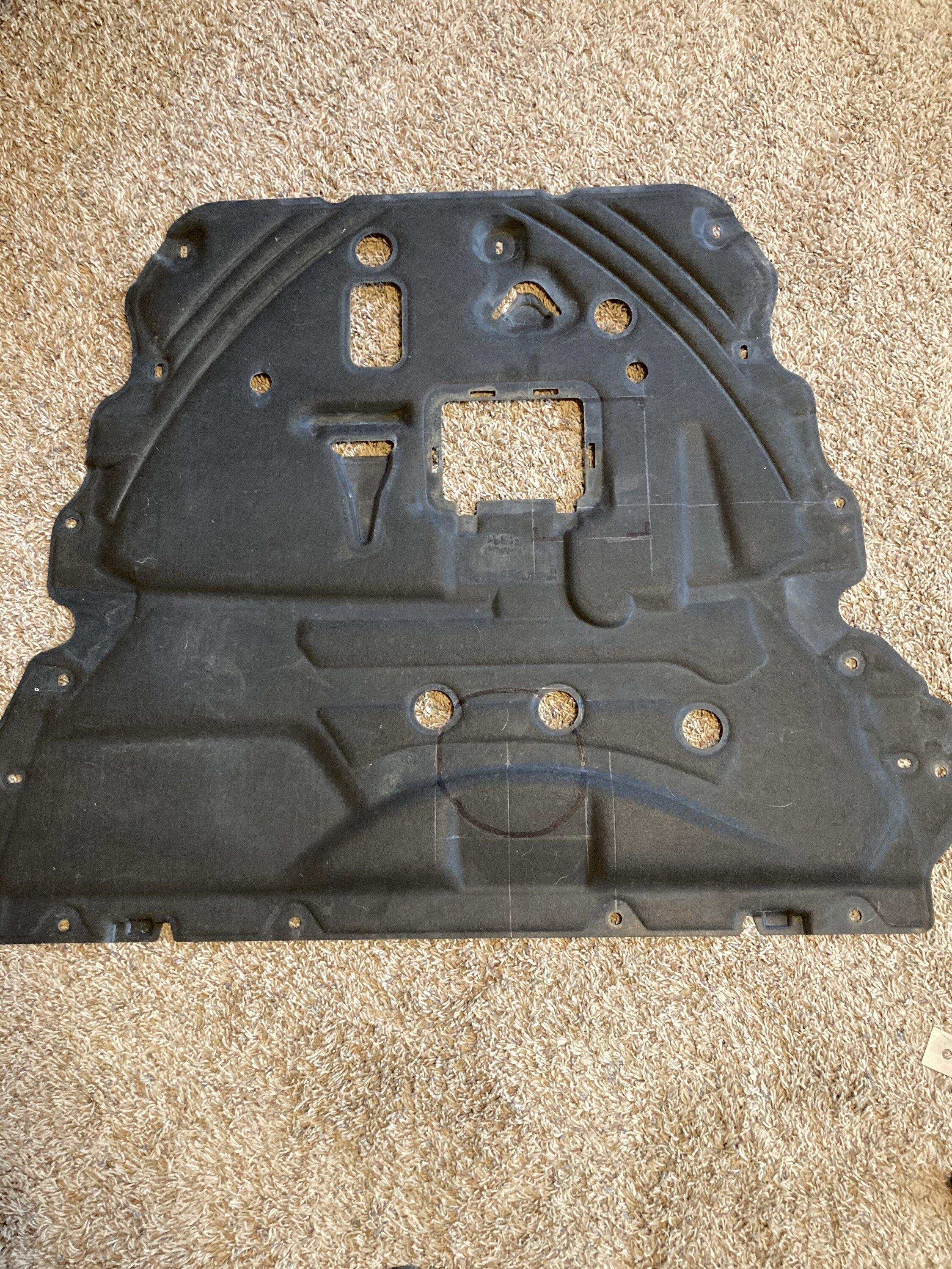

Had planned to cut access panels on shield under engine for oil changes. Wondering if filter and drain plug are in same location on both engines? I Have template for hole locations on the ecoboost motor?

I slid under and did some measuring and it seems both the filter and drain plug are in the same place as the ecoboost. Needed to cover up the large hole in the shield and then cut the access panels. I didn’t cut the shield pieces out completely, left part there and creased it to make “doors”
Ford Maverick Oil filter and drain plug location on hybrid? 1701576504381
Ford Maverick Oil filter and drain plug location on hybrid? IMG_9691
Did you also create a way to hold those "doors" closed?
Otherwise, if the "hinge" is at the rear, it looks like they'll be flapping in the wind as you drive.
I have some thumb latches coming to still install in the “doors” to hold them closed, supposed to be here Tuesday
What did you dover the filter access hole after cutting it that part of the shield out?
I desired to cut out a hole also. I looked at that section several times and the issue appears to be that the section is not flat which would make it difficult to cover after cutting out that section>
Did you just leave the hole there without covering, which would be an option.
I though about cutting out three sides of the square and creasing the fourth side and taping the slices with tape that you have in the picture.
Before I had the access panels printed, I cut out almost all of both holes and just creased the liner and put Quarter turn catches on them to keep them closed, exactly what you’re thinking about, here’s my post and it has some pics:
