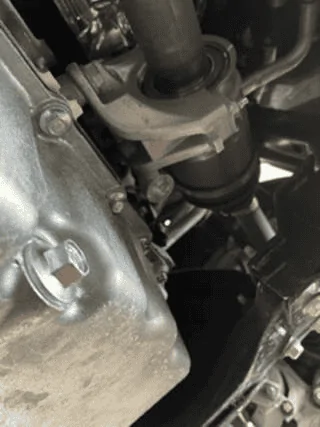

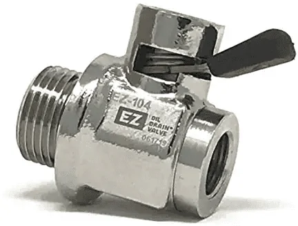

Does anyone know the size of the oil drain plug on the hybrid engine - not the bolt size but the threads. I want to replace it with one of the Valvomax or EZ drain valves. Does anyone with experience using them recommend one over the other?

Thanks. Fumoto calls for the M12-1.75 for the 2.5L L4.

Looks like the drain plug is recessed, so fumoto recommends an extension. Still plenty of clearance though.

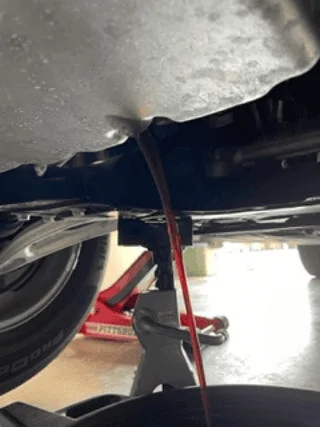

I changed the oil today at a little over 2,500 miles. It looked good for the factory oil. I also checked for clearance around the drain plug. It did not seem too restricted.

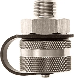

I use Valvomax in my 2020 Honda CRV, 2008 chevy avalanche and 79 Trans am. Love it

I use the valvomax on all my cars including my 70’s T/A, 56 F-100 Panel
