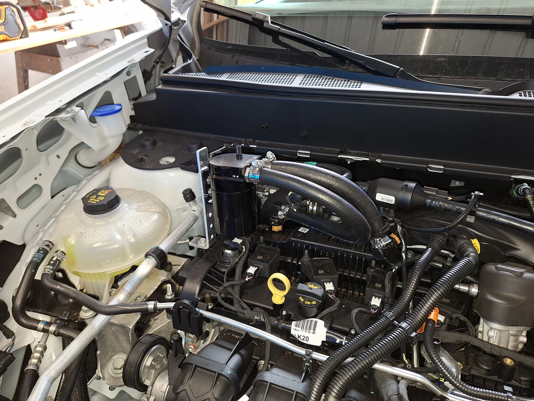

Oil catch can installed
catrikejoe
joe ramirez
Jun 2, 2025
60
76
MO
2025 maverick XL
It is supposed to help with carbon buildup on intake valves.
Separates oil and air from the mist coming from pcv . Oil drains into can and cleaner air to intake track to burn.
