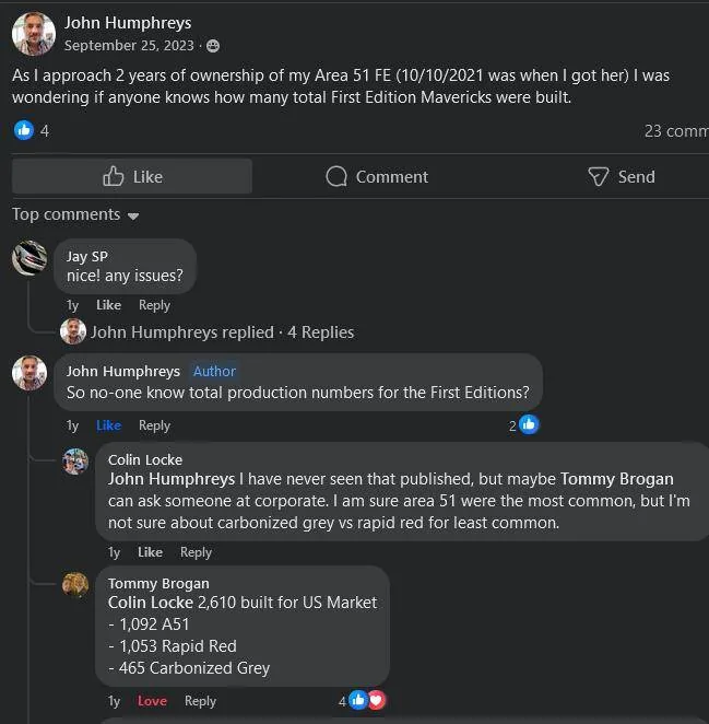

that is probably the rarest maverick you'll ever see. 465 made in that color.
Especially since 317 were exported to Alpha Centauri . . .
Only of the first edition- ours is a '23 CG and we've seen plenty of other Carbonized Greys around.
right, yes. the rarest color to date is certainly Rapid Red.
