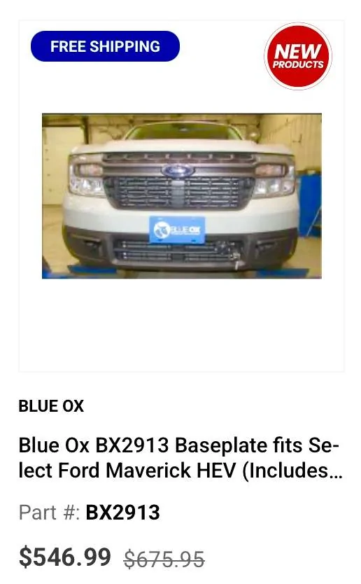

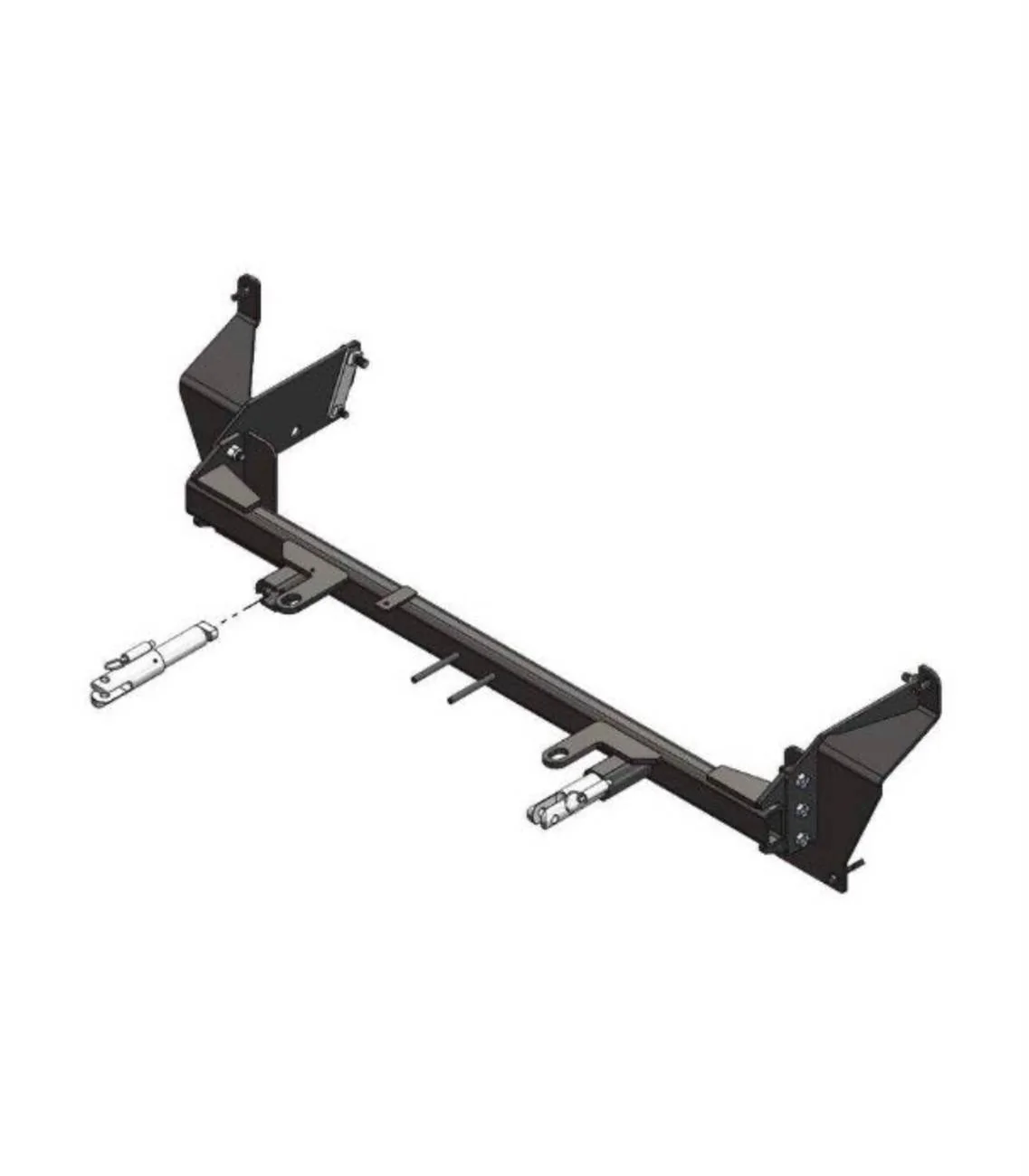

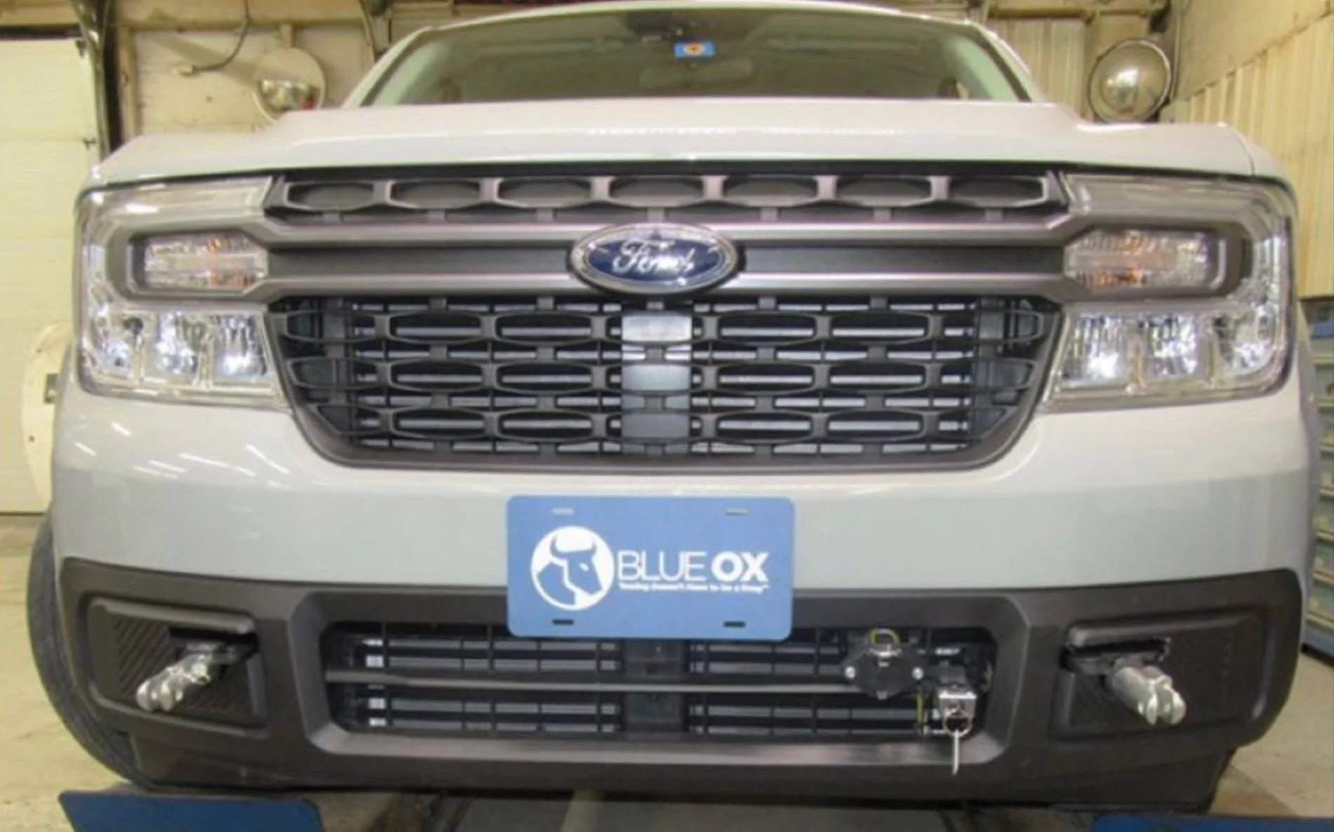

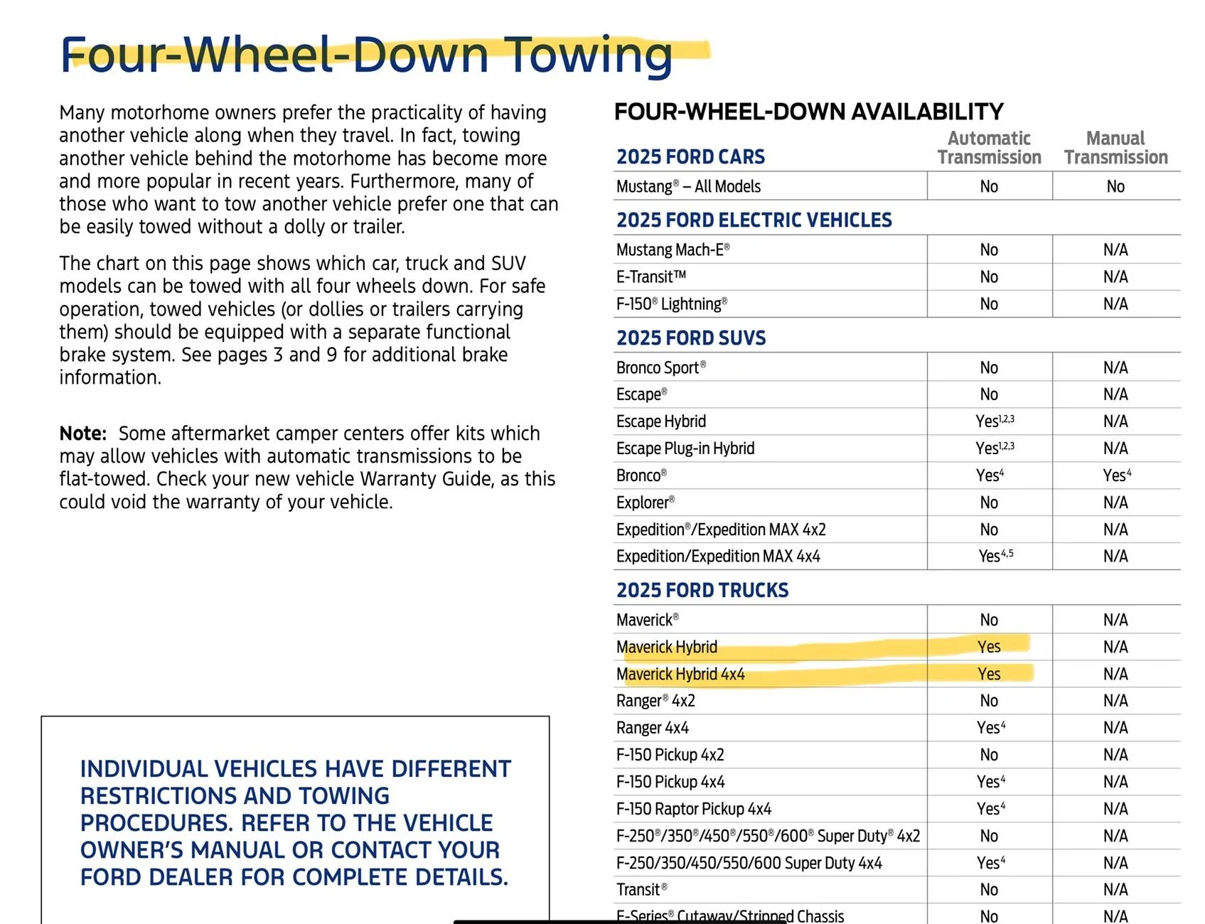

Great News - Since all the rumors whether the 2025 Maverick AWD Hybrid is flat towable has been put to bed and it is confirmed that it is indeed flat towable four wheels down.
i was contacted today by BlueOX that they have completed the engineering and the new baseplate is now in stock and ready for sale and ready to be Installed - RoadMaster and Demco hopefully will also be ready to go to the market soon.

I'm not seeing it on the BlueOx website ???
I screen shot the photos directly from the BlueOX site today I also communicated directly with a BlueOx Rep that they are available- like stated I will wait on RoadMaster and Demco I want the cleanest installation with the least destruction to my front facial
