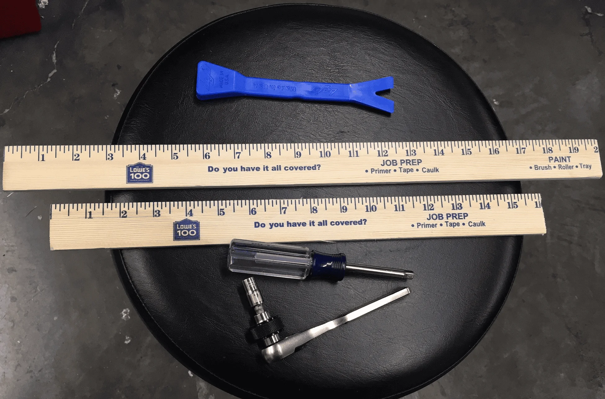

I recently installed new rear speakers and a powered subwoofer in my Hybrid. Sound amazing. Hopefully this helps someone looking to upgrade.
Is the install or approach going to be different if you have the B&O system?

Which aspect? Replacing the rear speakers methodology is the same. For a subwoofer you can just use the OE subwoofer output either through a LOC or to the amp directly if it's capable of high-level input. Either splice in parallel, Motorcraft WPT-1456 if disconnecting the OE sub, or a PAC APH-FD02 if you might also want to run the front audio through a different amplifier.
I have been searching hideaway subs (Kicker or cerwin vega) and wanted to make the install as simple as possible. I am not a pro but not a novice, but your videos have intrigued me. Still waiting on the delivery of my truck (next week) so it may have enough thump for me. Contacted the company for the wiring harness and that makes even easier. Just curious what the easier way to tie one of those subs into the system.
