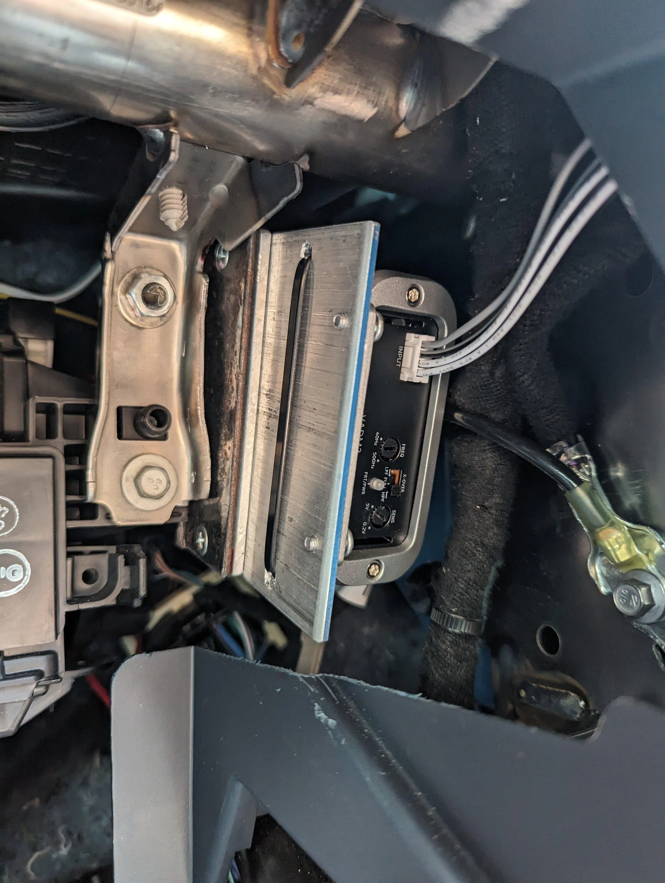

Another suggestion would be to have a better plan for upgrading than I did. After installing the speakers in front doors with new tweeters in dash, I decided I wanted more power and also to add a subwoofer. So I looked under dash, after taking out the glove box, and found a spot to the right of the glove box and the air handler where the cabin air filter is located. I ordered a NVX VADM2 2 channel amp. I takes the input from the front speakers and provides up to 220 watts per channel, I seriously doubt it really puts out that much power, But more than enough for my needs. Most importantly, it is very small as the space I had was small. I include a pic to show how it is mounted. It is a piece of angle iron and a 1/8 plate of aluminum. The clearance with the glove box is very tight, I had to space the aluminum plate over 1/8 to clear it.

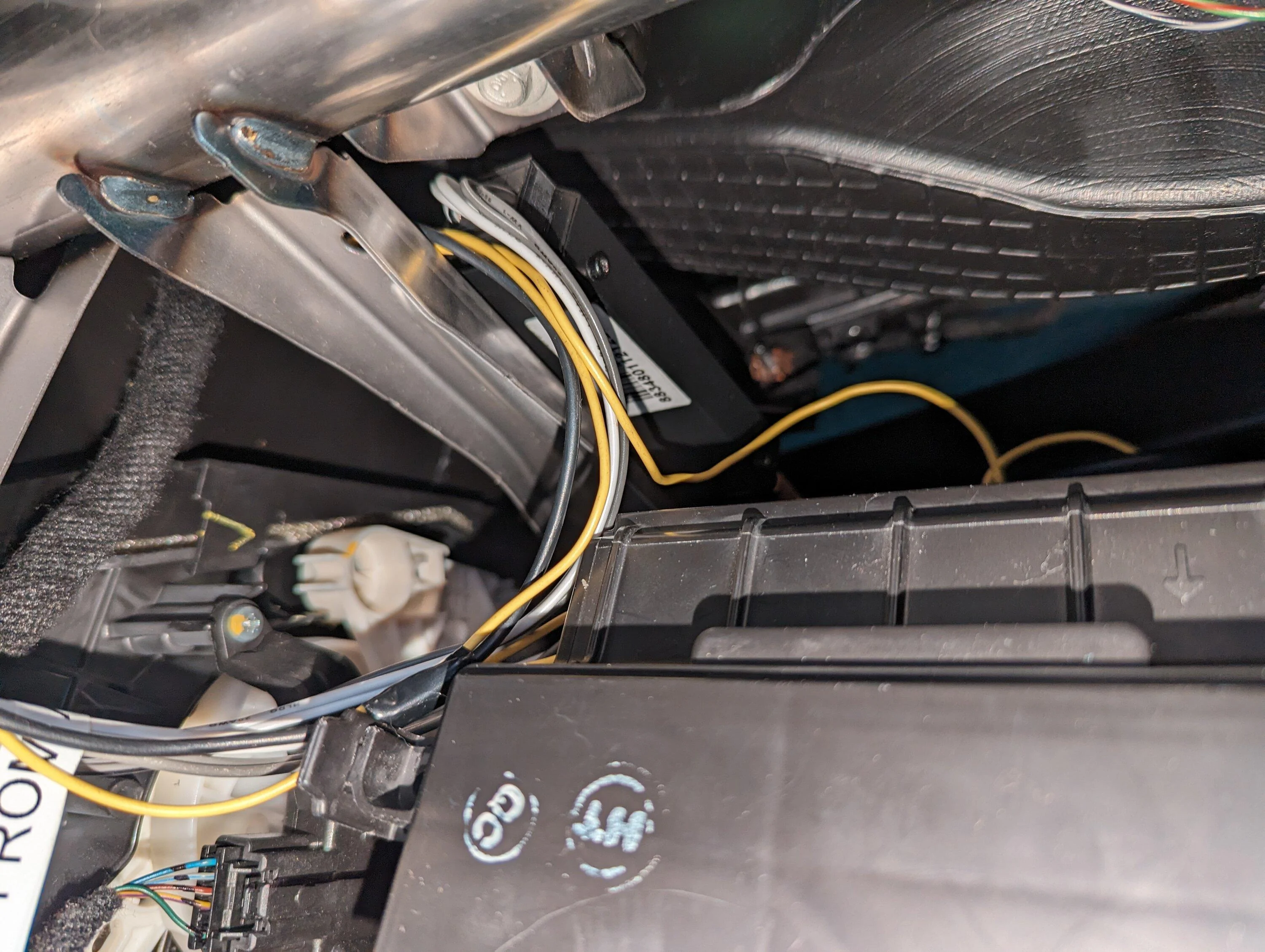

To get the signal to the amp I got a wiring harness from PAC Audio #LPHFD31. It attaches between the stock stereo head unit and the speakers. It also provides a +12 volt power and a ground. The signal then goes to a line output converter(LOC) from PAC model # LPA-2.4. This LOC takes the 2 channels and outputs 4 low level channels with RCA connectors, 2 for the front and 2 for the rear. It also has a low pass filter to feed a subwoofer amp. I used these channels for the subwoofer which I mounted behind the rear seat. The LOC also provides a turn on wire for the amp and the sub. I mounted the LOC to the left of the air handler box up real high on a metal bracket that is part of the dash support structure. (pic included).

With the Hybrid, the battery is under the rear seat so I connected the amp and the sub directly there with a fuse. I ran the 12v power and turn on wire down the right side of the vehicle and the low level signal wire down the left side to the sub. People have posted videos on running these wires.
