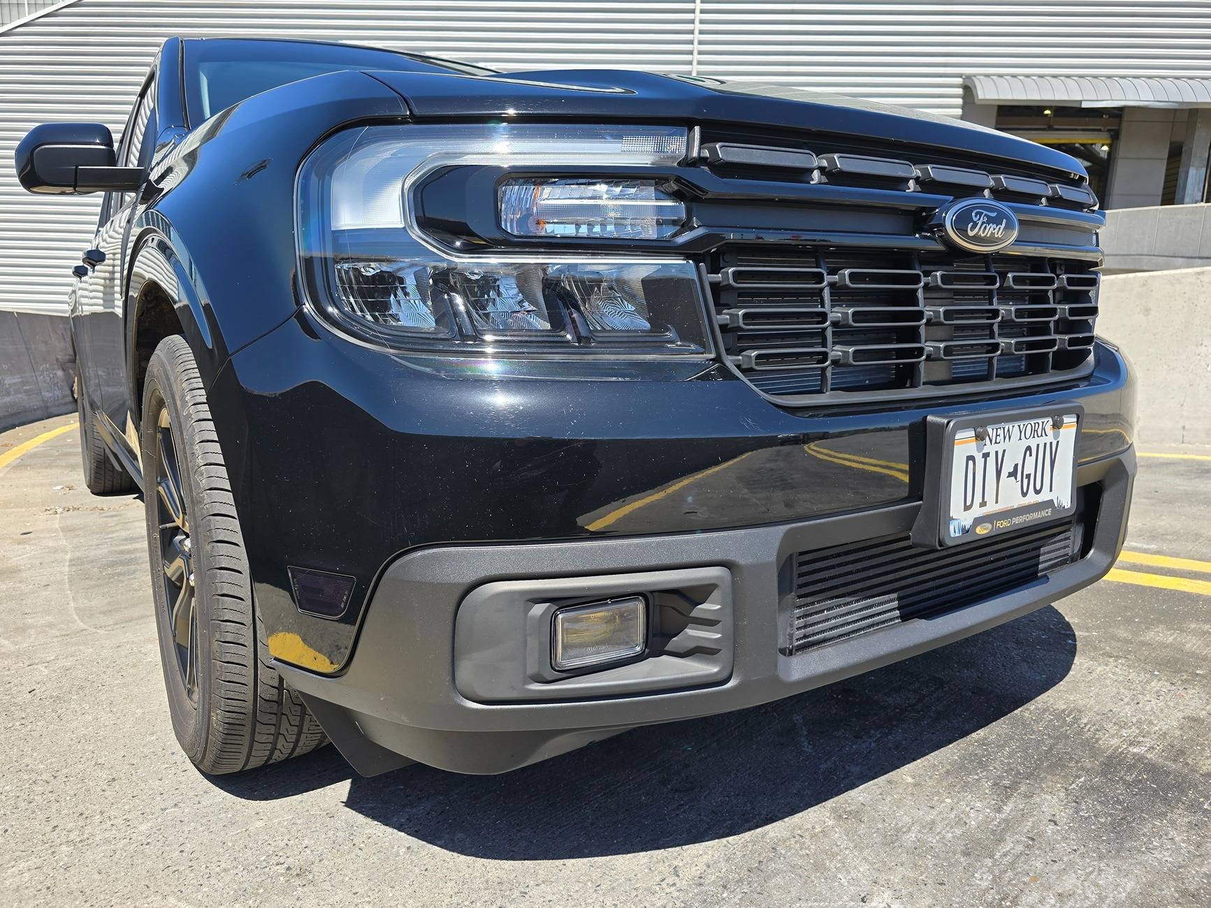

Some updates to the Maverick. Decided to cut out the front intercooler opening and added speedpro smoked marker lights.
