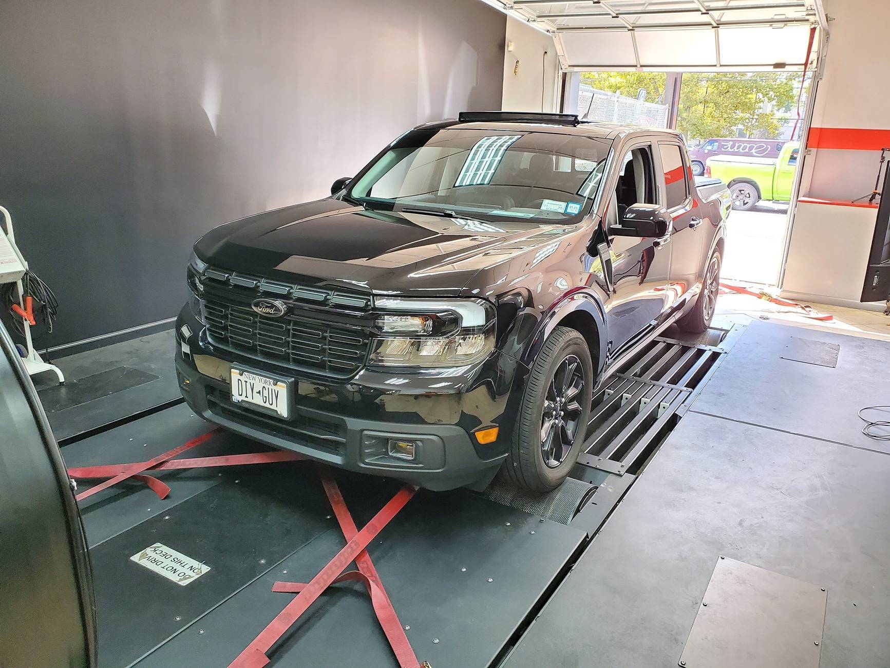

So now how does the dyno work if its an AWD?
I know the awd kicks on once and a while and more when in sport.
We had a lot of problems with the ptu overheating and the awd system shutting itself down when trying to dyno it in awd. We ended up disconnecting the rear differential plug so it stays in fwd on the dyno pulls. If I were to dyno it again I would just use a fwd dyno and save myself from the headache.

Wouldnt that effect the fuel delivery and trans shift points and all around performance you are trying to achieve with a tune being that it’s gonna be put back on awd when plugged back up, More of a load with the awd system engaging. Also dyno numbers would be higher on fwd since its pushing that power to 2 wheels instead of 4.

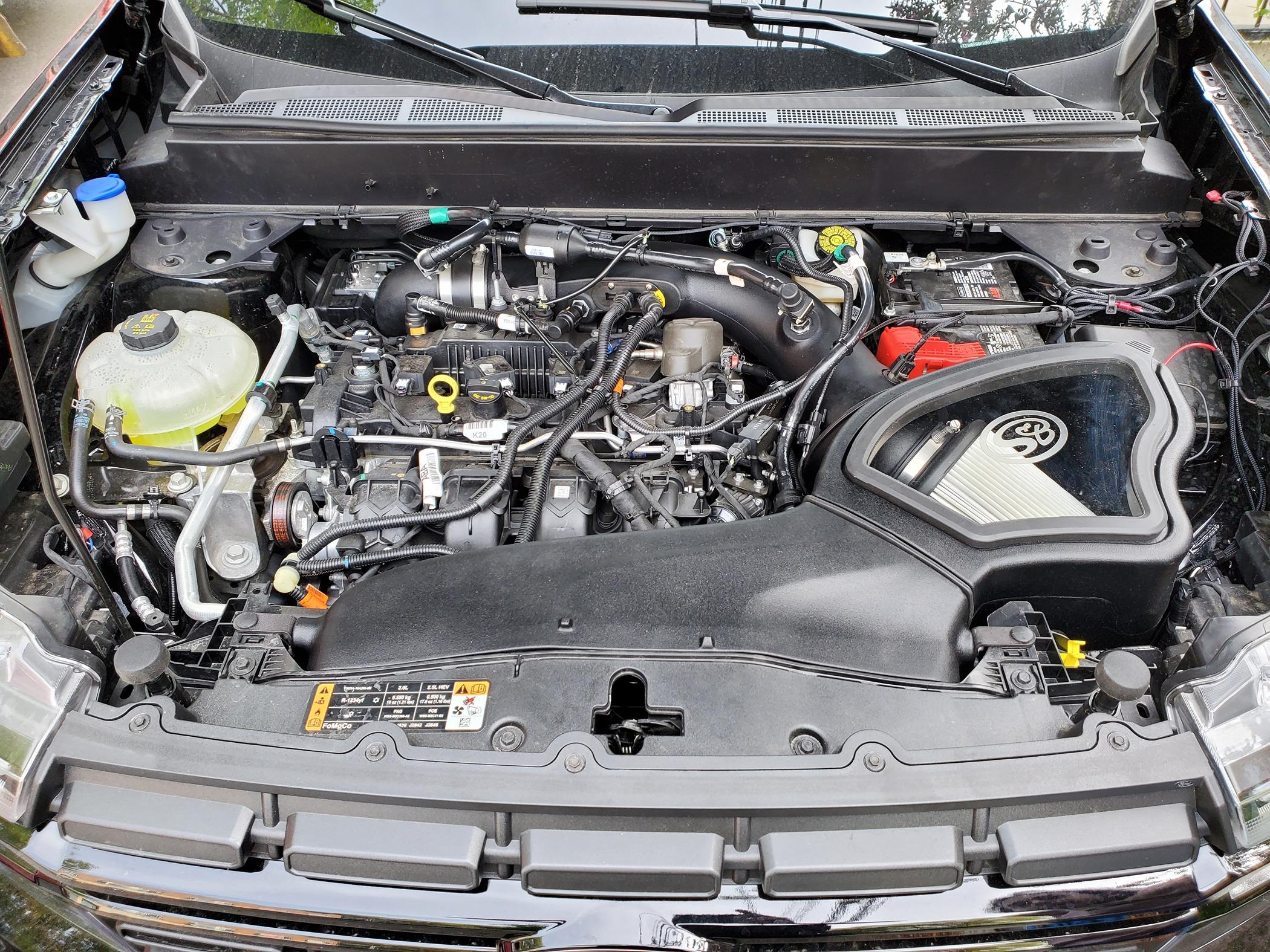

Purchased a Shadow Black 2023 Lariat 2.0L AWD back in January. Vehicle has BAP, LUX and 4k Tow. Was going to keep it stock but we all know how that goes... smh. Most pictures from this thread are moved up to this first post.
Current Mods
Exterior
*Diode Dynamics 6K Reverse, 6K Cab and 3K Yellow fog light kit
Suspension
*Good-Win Racing Lowering and Handling Upgrade (Rear sway bar at lowest setting)

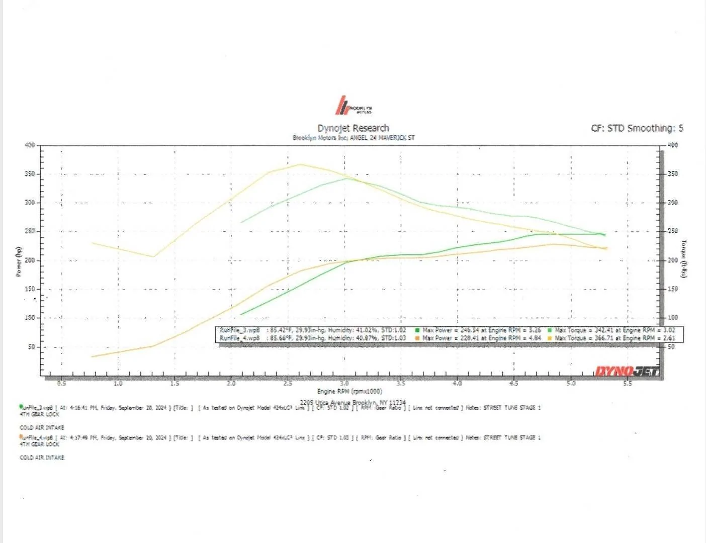

Performance - 247hp / 343tq to front wheels on Dynojet
*Cobb Accessport with Custom 93 Octane E-tune by Alan Jackson (EdgeAutosport)
*S&B Intake
*Stainless works downpipe
*Fast mavericks Intercooler

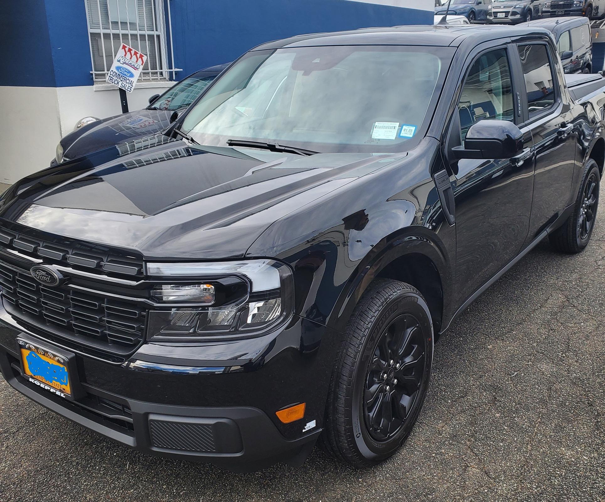

The day I picked it up

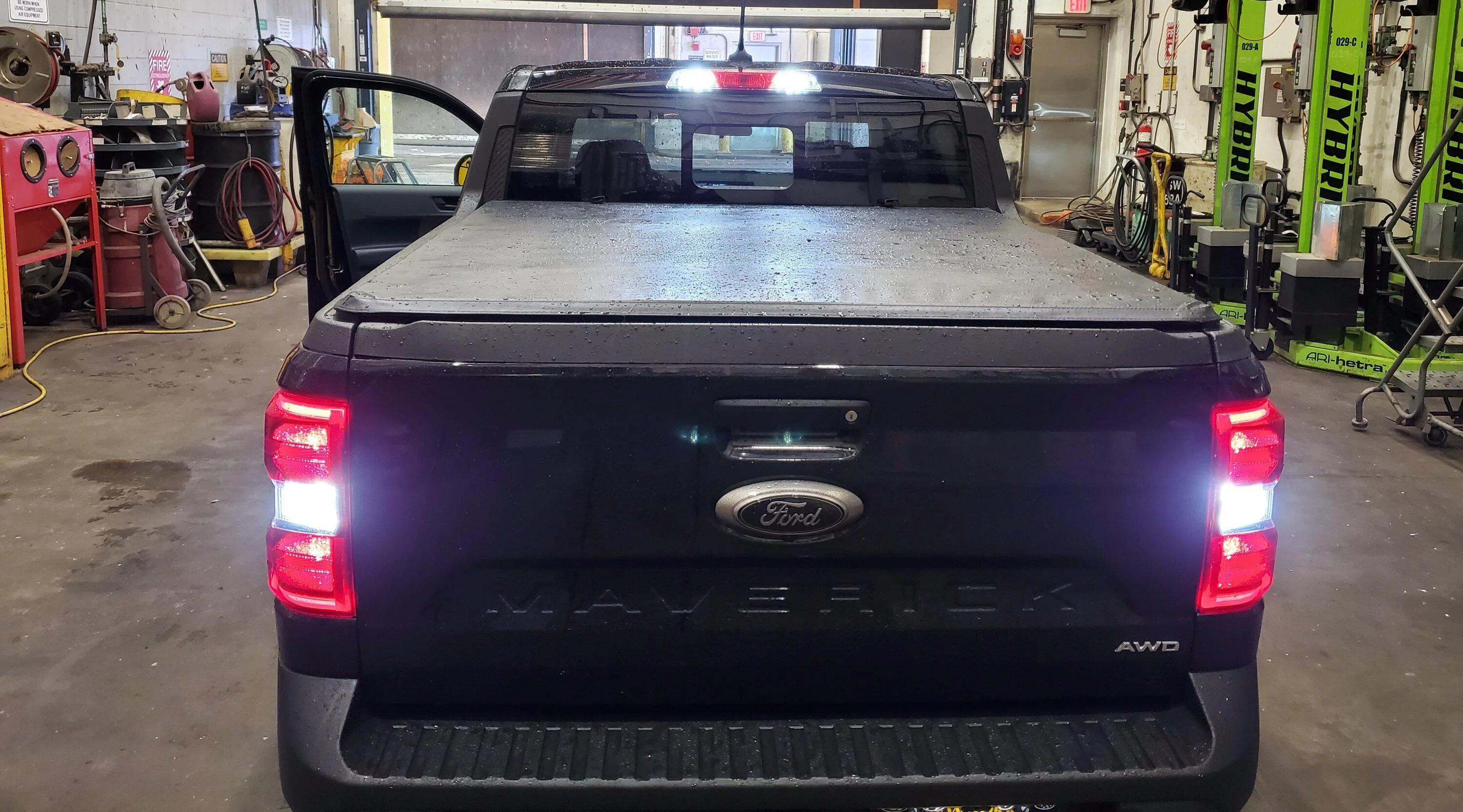

First mods were lighting. I purchased Diode Dynamics Reverse, Cab and Yellow fog light kit. Also got custom plates.

The day I put it on the rollers to see what it puts out to the wheels after mods listed and e-tune.

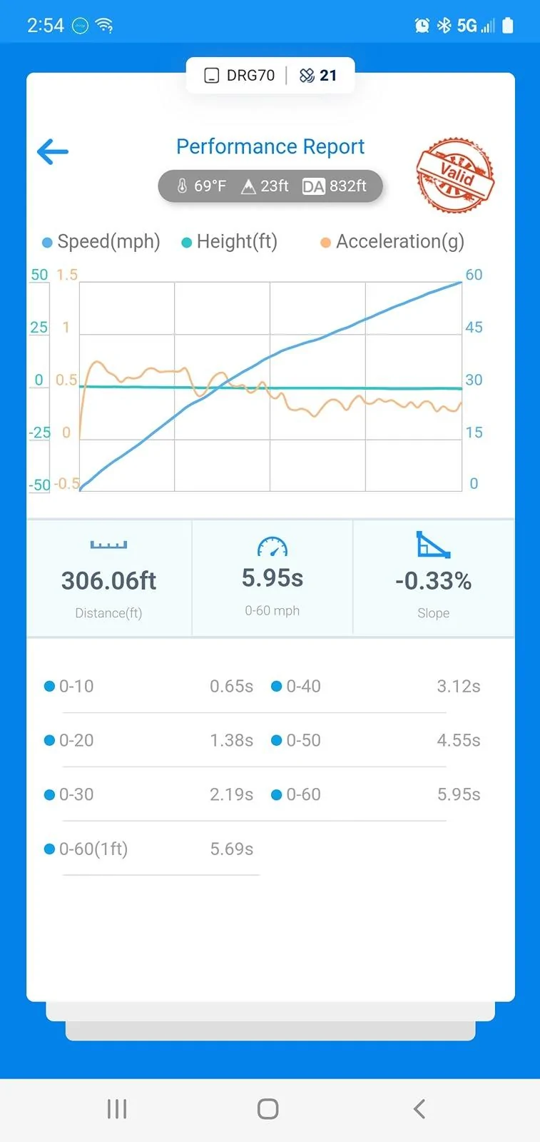

Here is my best 0-60 & 1/4 mile runs I made with my dragy.

Trans has its own tune. Engine was locked in 4th gear for a 1 to 1 ratio. I went to a shop with a new dyno so the numbers seem to be low since my front wheels were slipping on the rollers. Eventually I will get a dyno at another shop but want to do a couple more upgrades and get it retuned by alan at edge autosport.

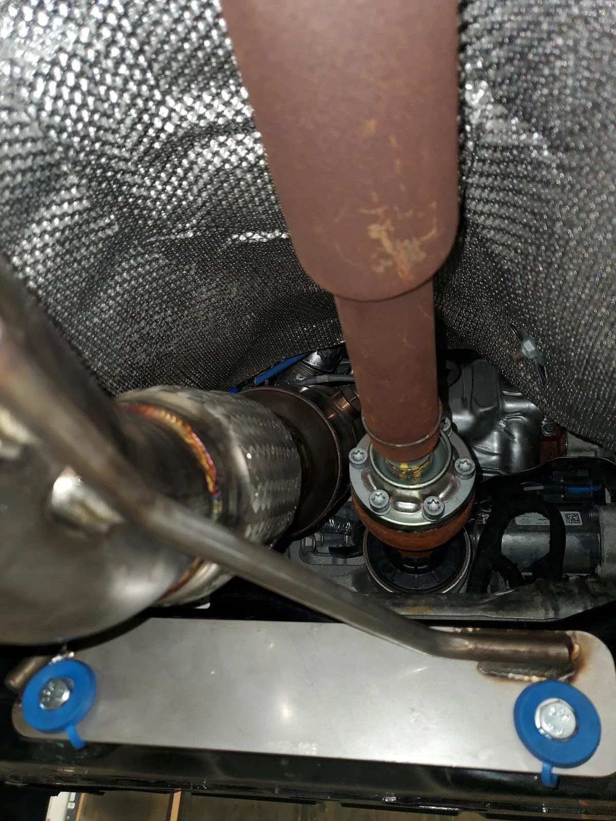

Is it?!

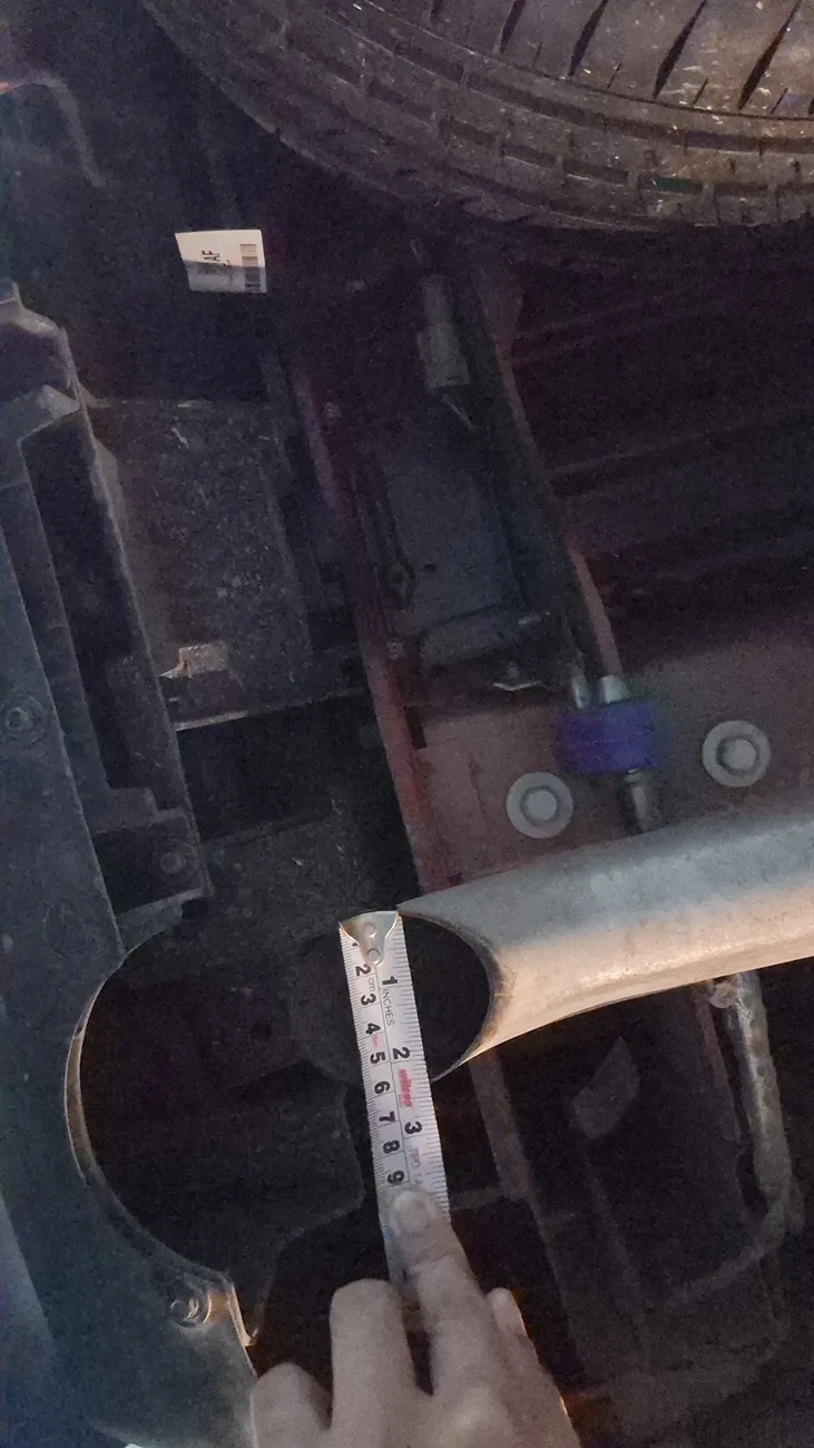

A lot of info, someone saying 2.25" stock, other saying 2.5" stock...
Take a look at the picture... 2024 Lariat Tremor, I'm saying 2.25" for me

Is it?!
I am driving a 24 XLT. Not sure if there is a difference or not but I just installed a 2.5 MagnaFlow catback.
