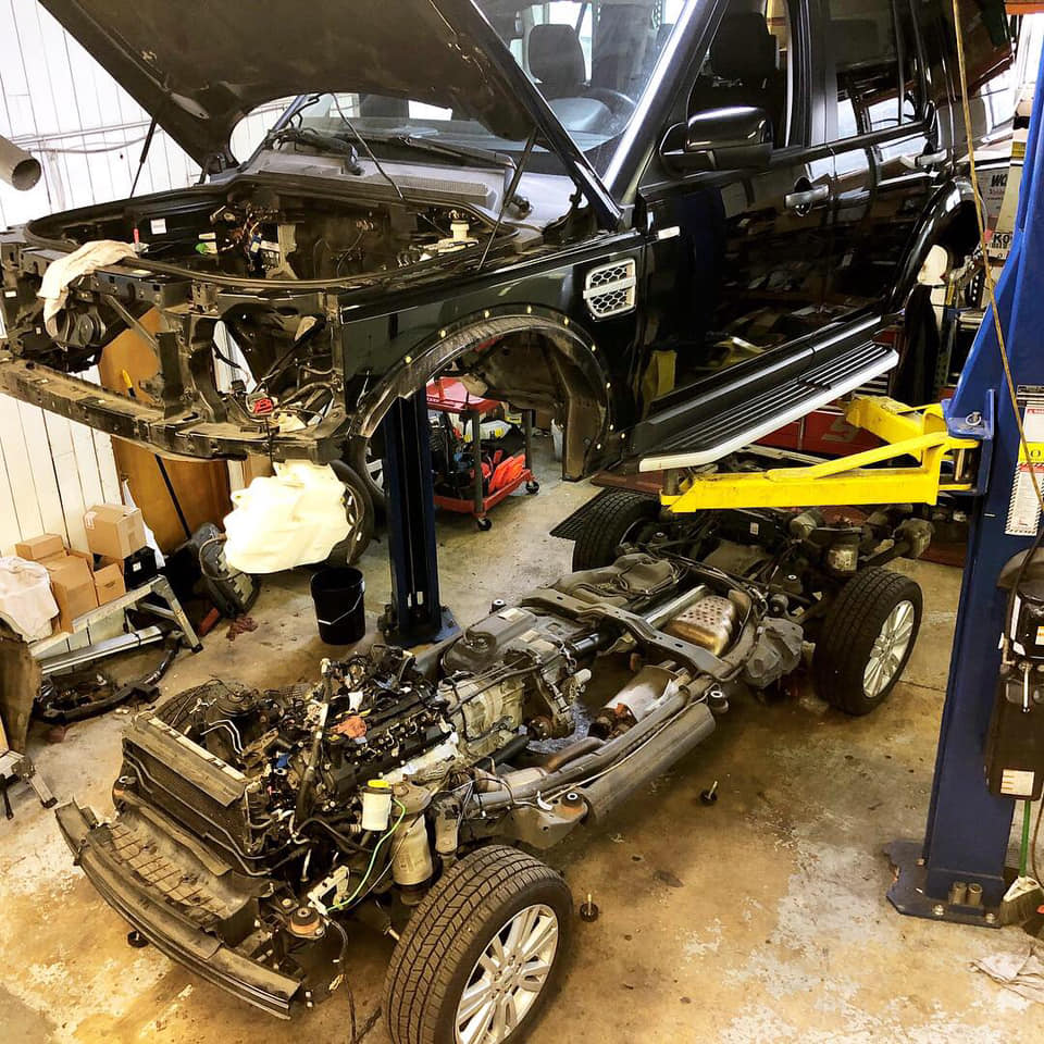

I followed this original post and actually piece it together.
Used a new stock Corsair turbo because I wasn’t gonna spend $4k for the CTR 57.
Injectors and HPFP just help unlock more from your engine and the turbo.
My mechanic dropped the engine completely out instead of taking out the AWD system.

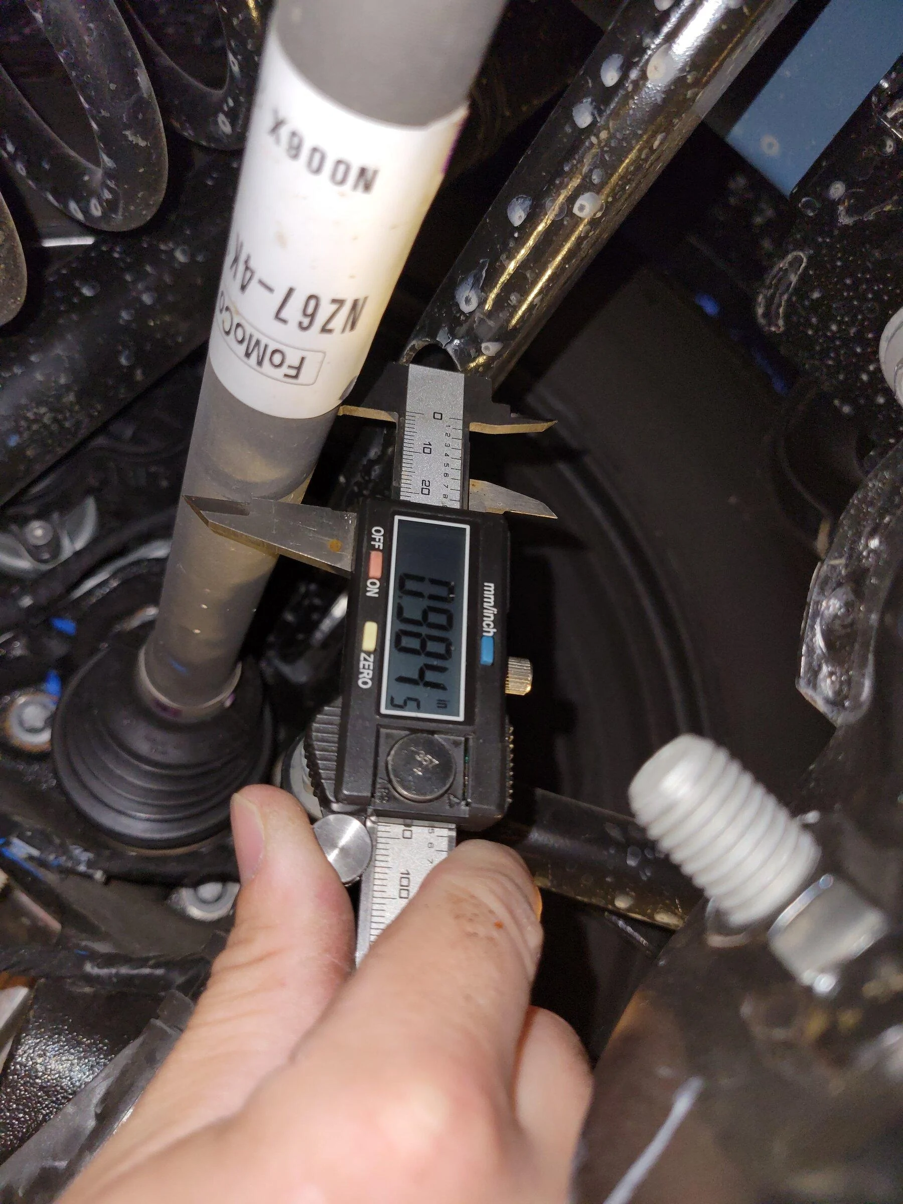

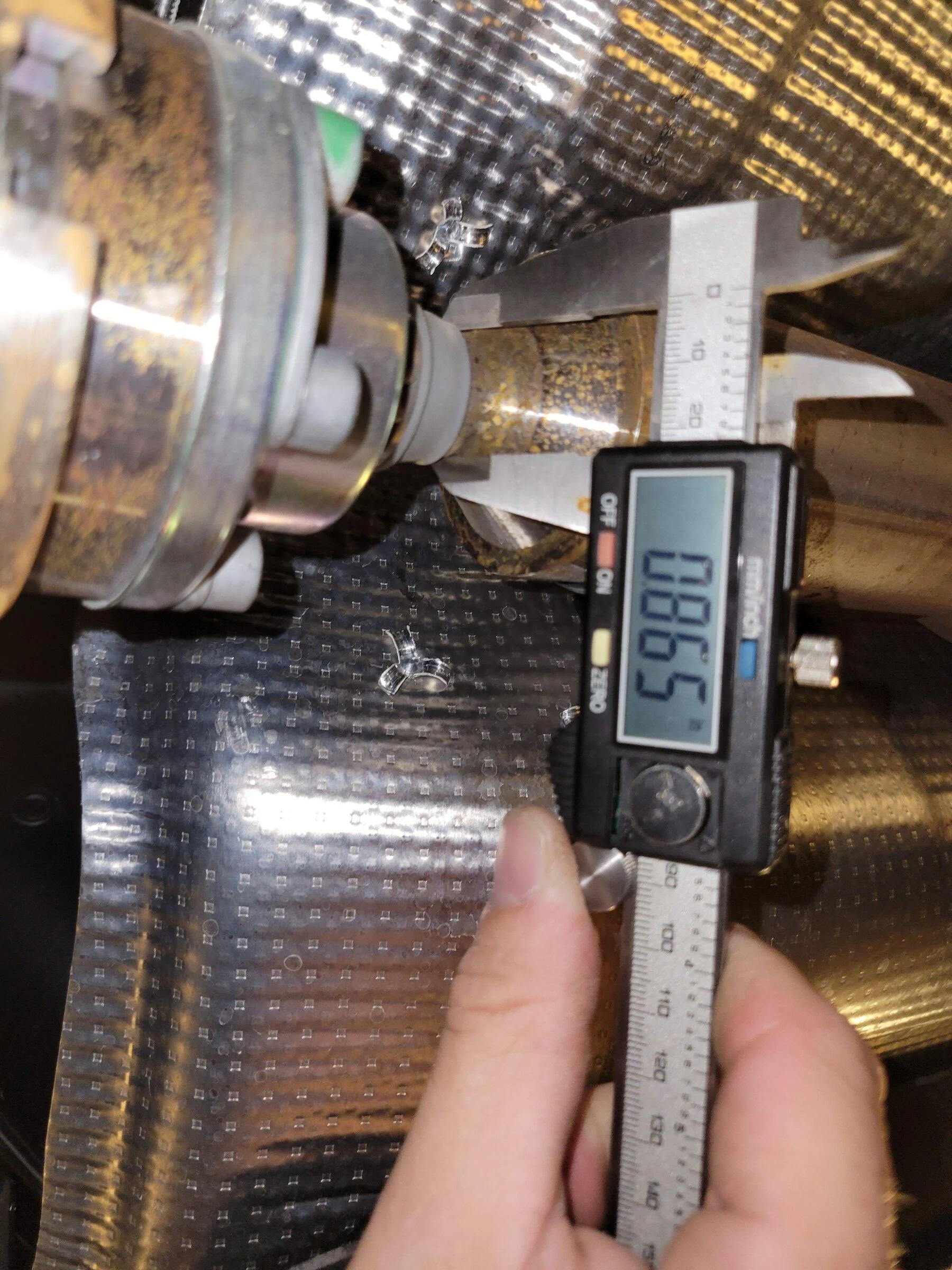

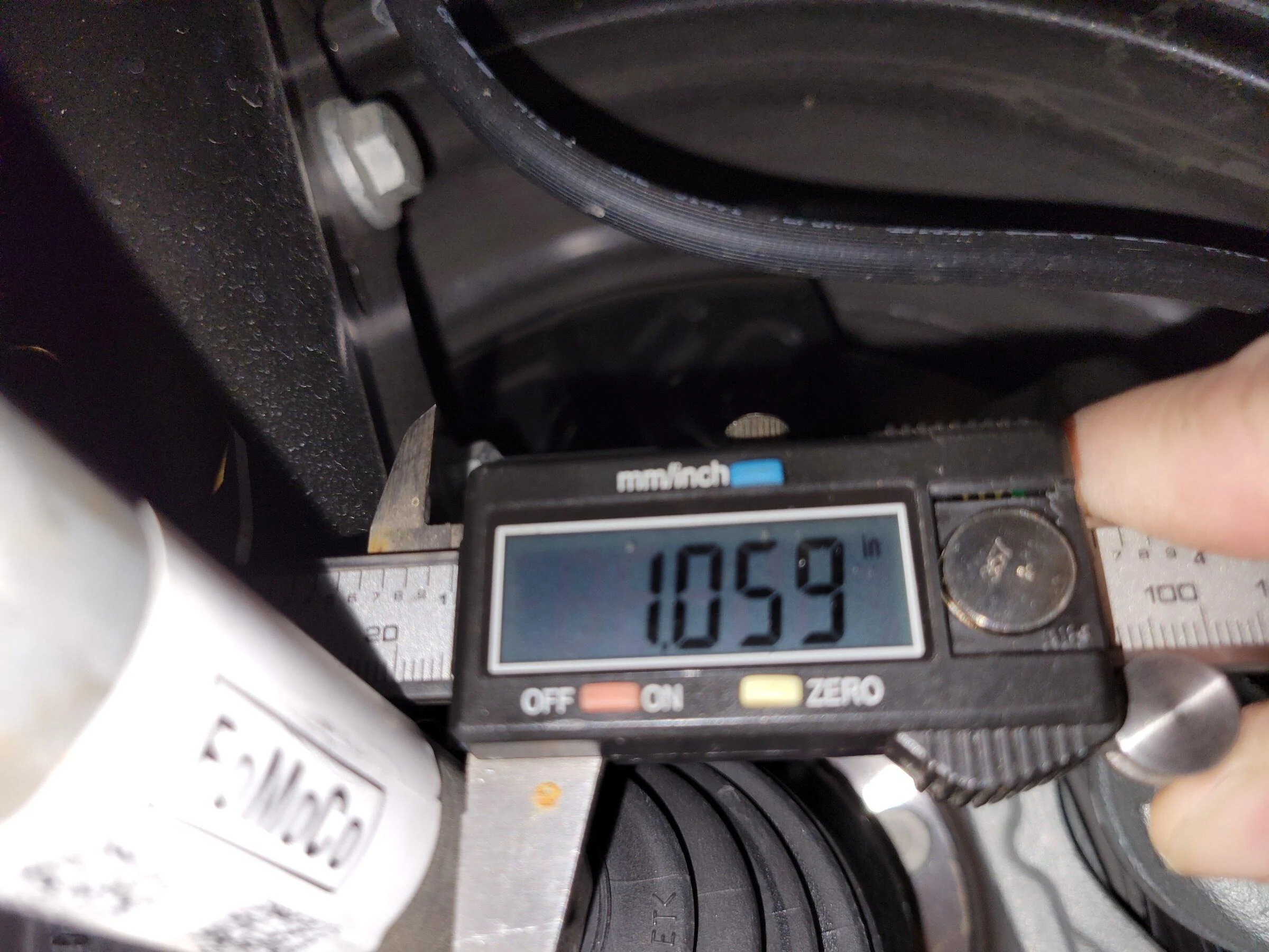

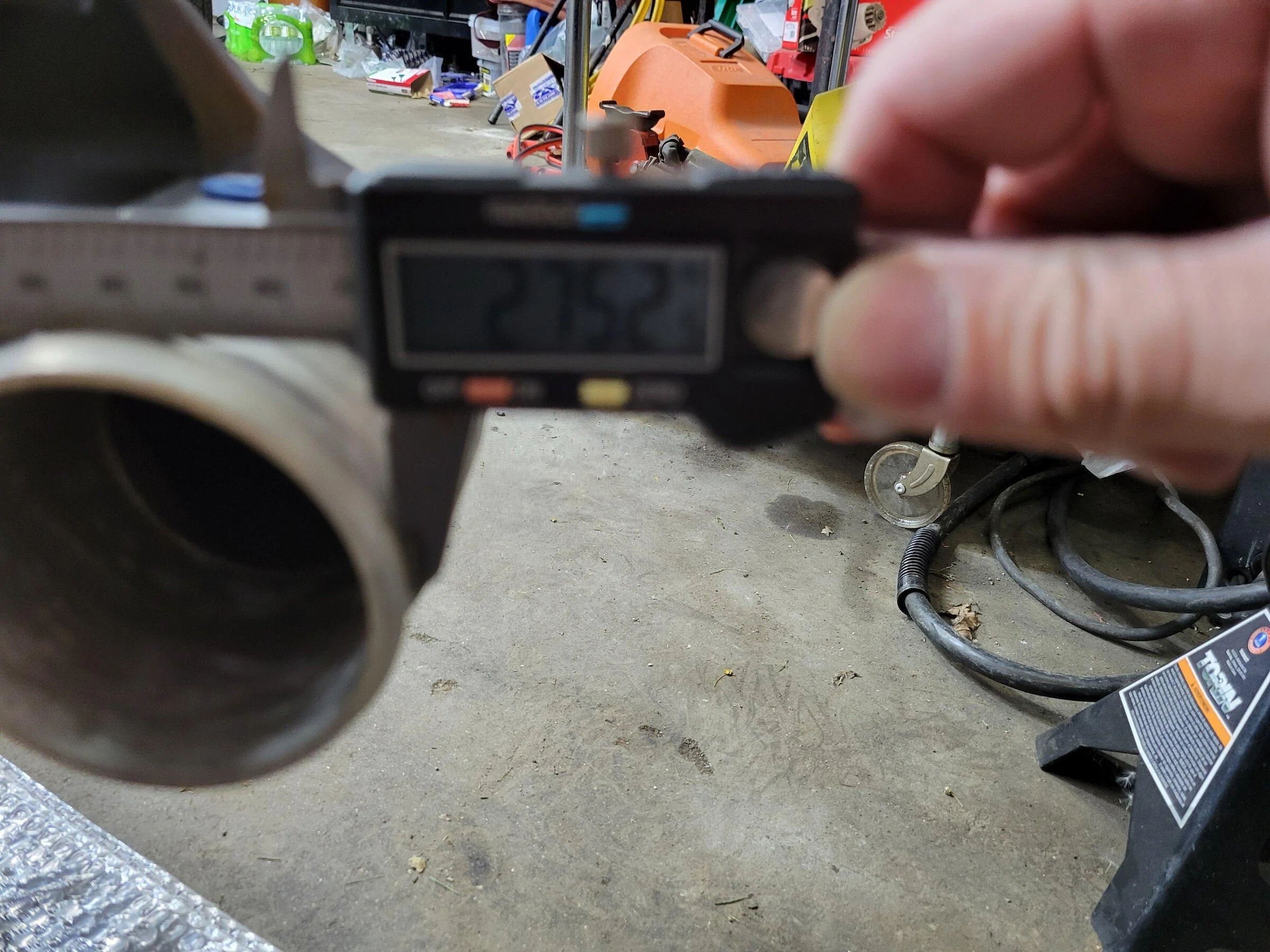

Here are some measurements for anyone interested. Front axles are just over 1", rears are just under 1", and oddly enough, the driveshaft necks down to .865"!!!

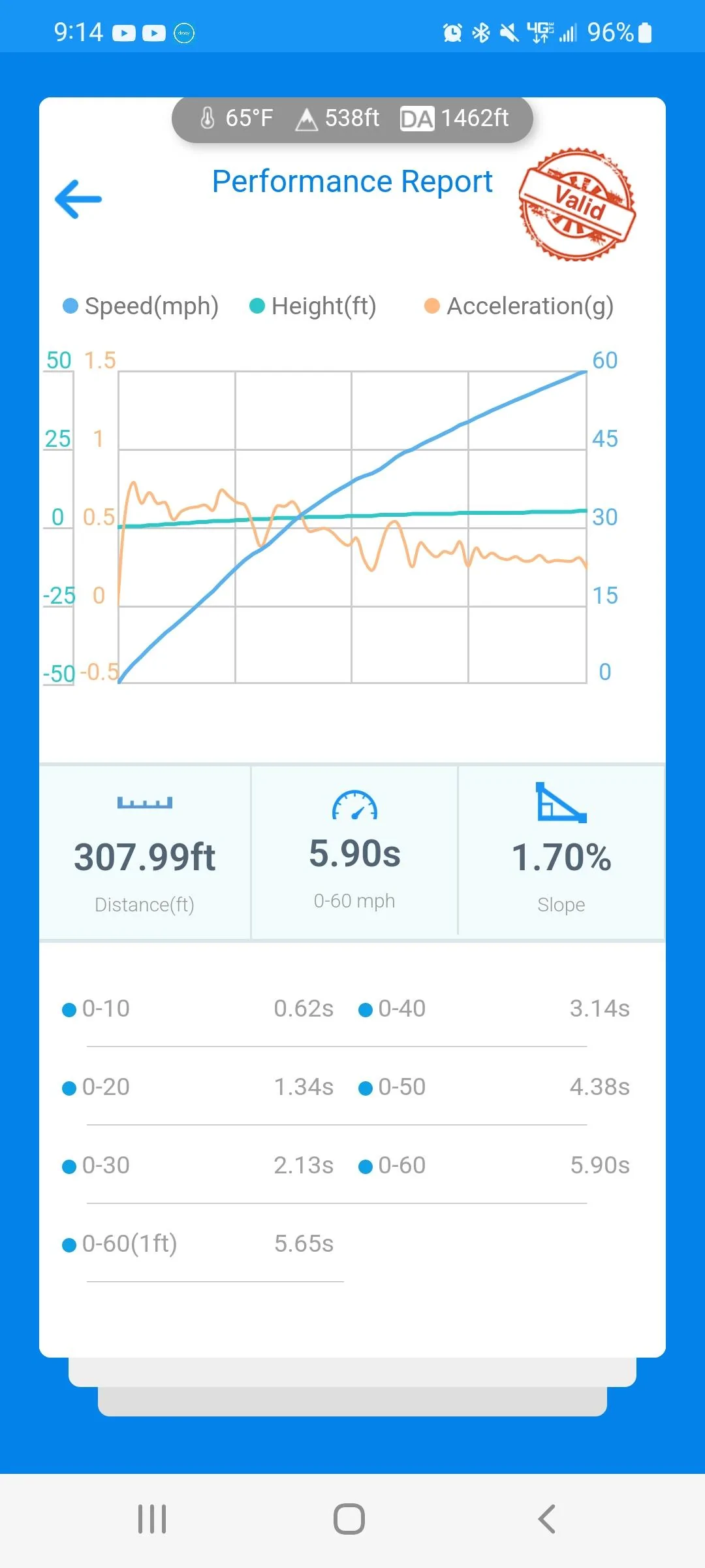

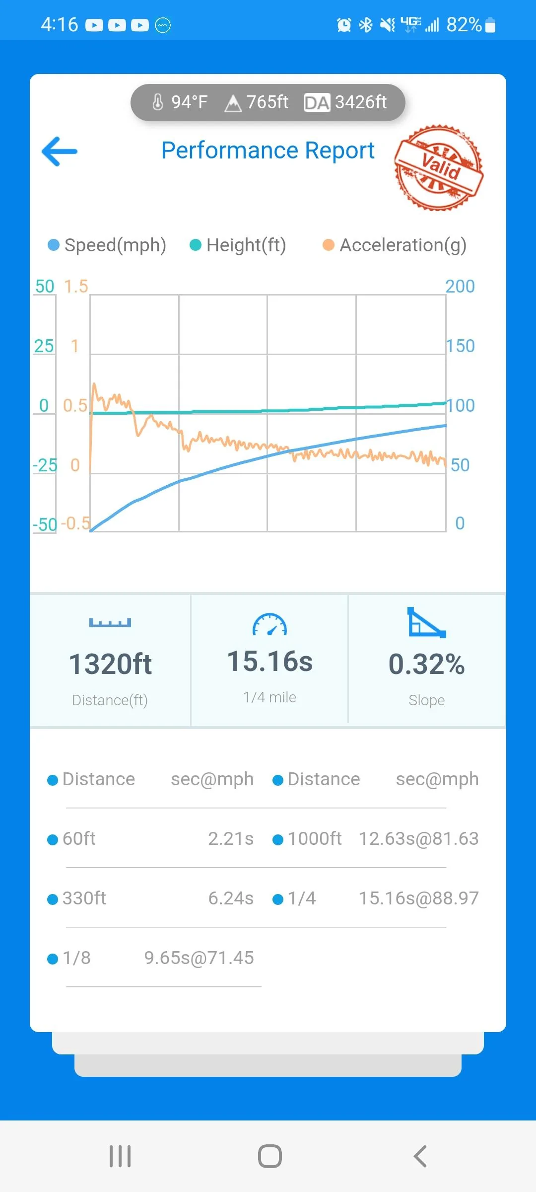

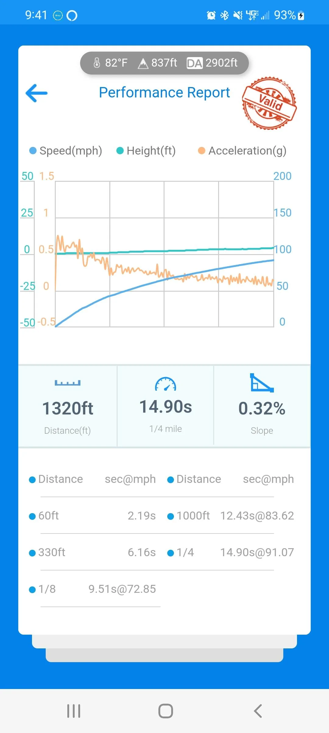

Screenshot is my draggy run today. Terrible run, but not surprising with it being 94° and a DA of 3400'+

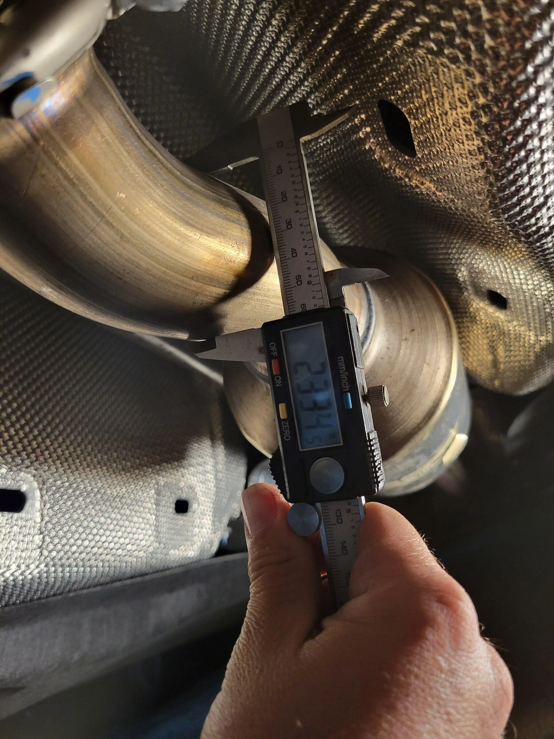

Is the exhaust tail pipe 2.25"????? Diameter

The OD was 2.3XX IIRC, so the ID was probably 2.25".
Yeah I can confirm 2024 2.0l ecoboost engine comes with 2.25 stock inlet pipe
