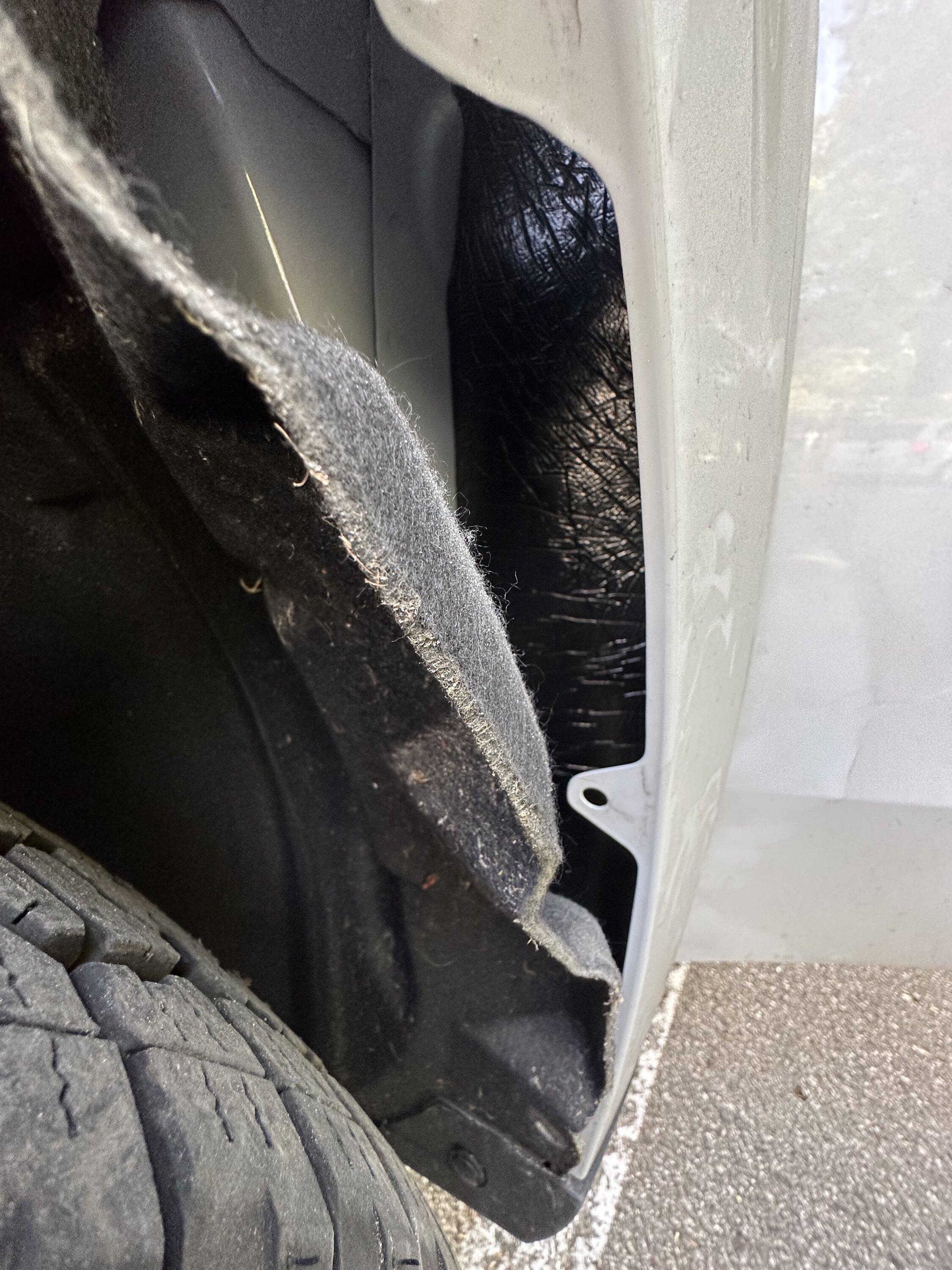

Another vote for this little part - it definitely seems to quiet down some road noise, especially the A/T tires on my Tremor.
If you think about it, the trailing edge of the front tread is inches away from your ankle - and this insulator is placed right between them.
Was very quick and simple to pop the three lower clips on the fender liners and slide the piece up. Less than 10 minutes total.

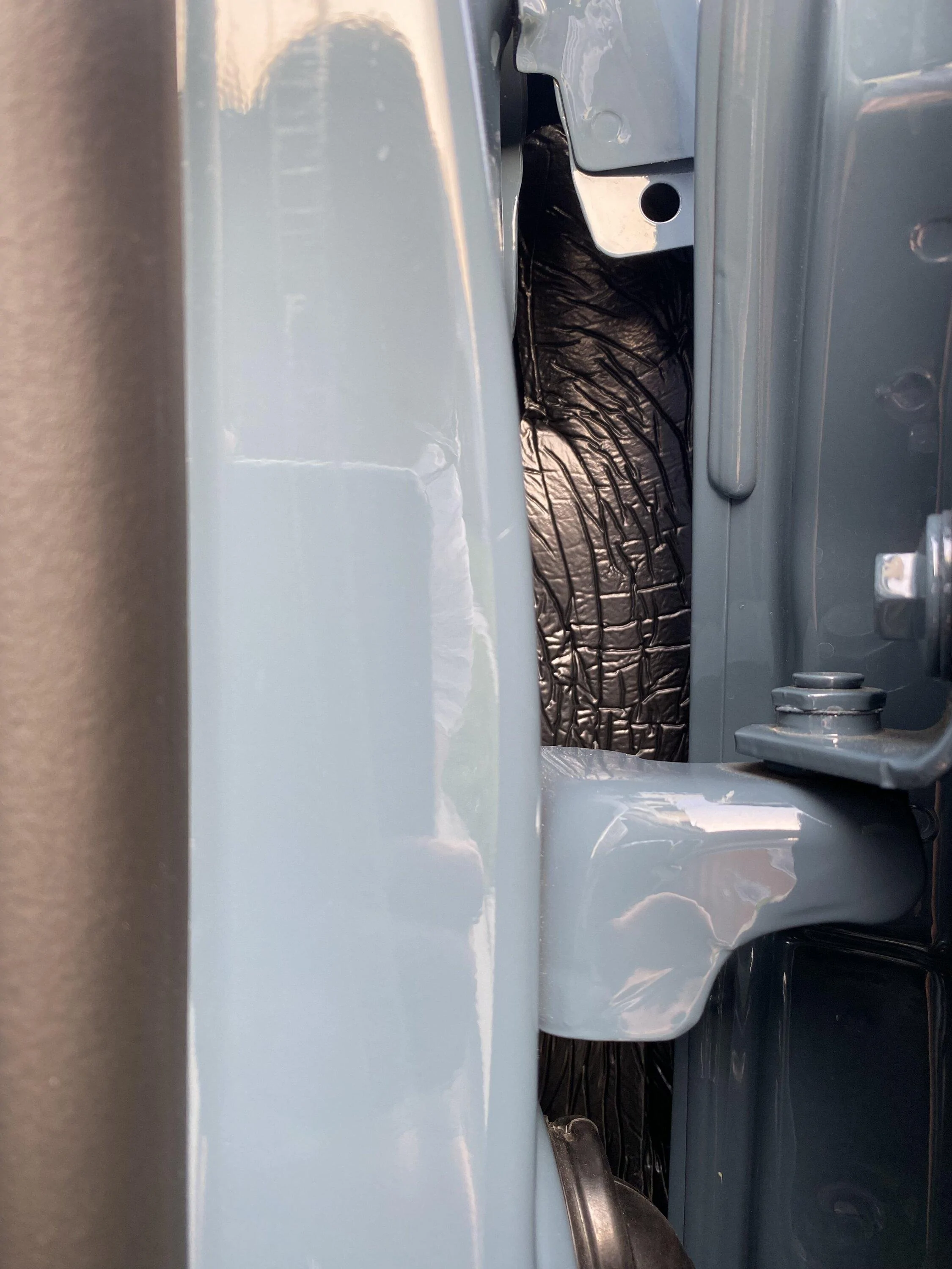

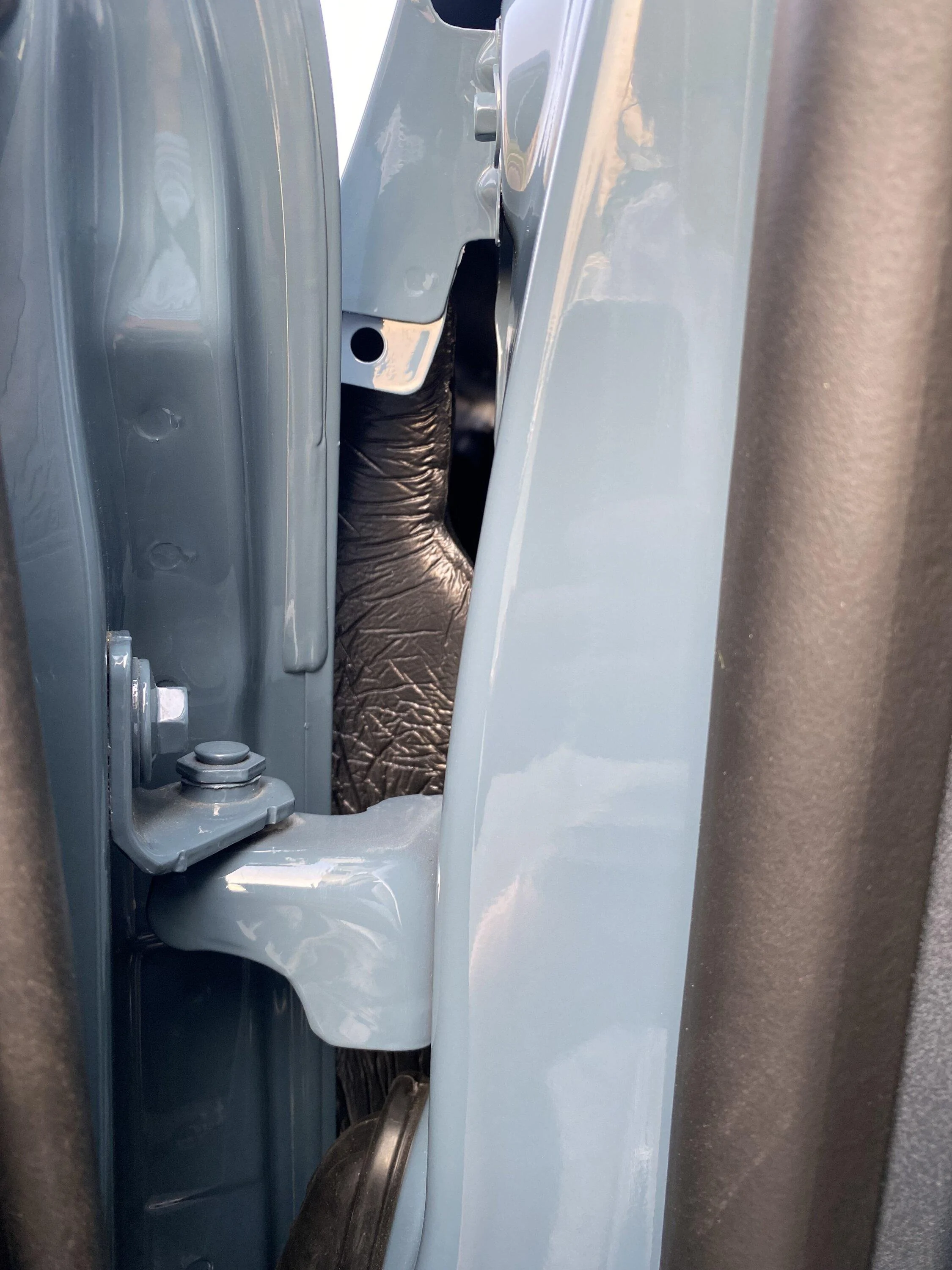

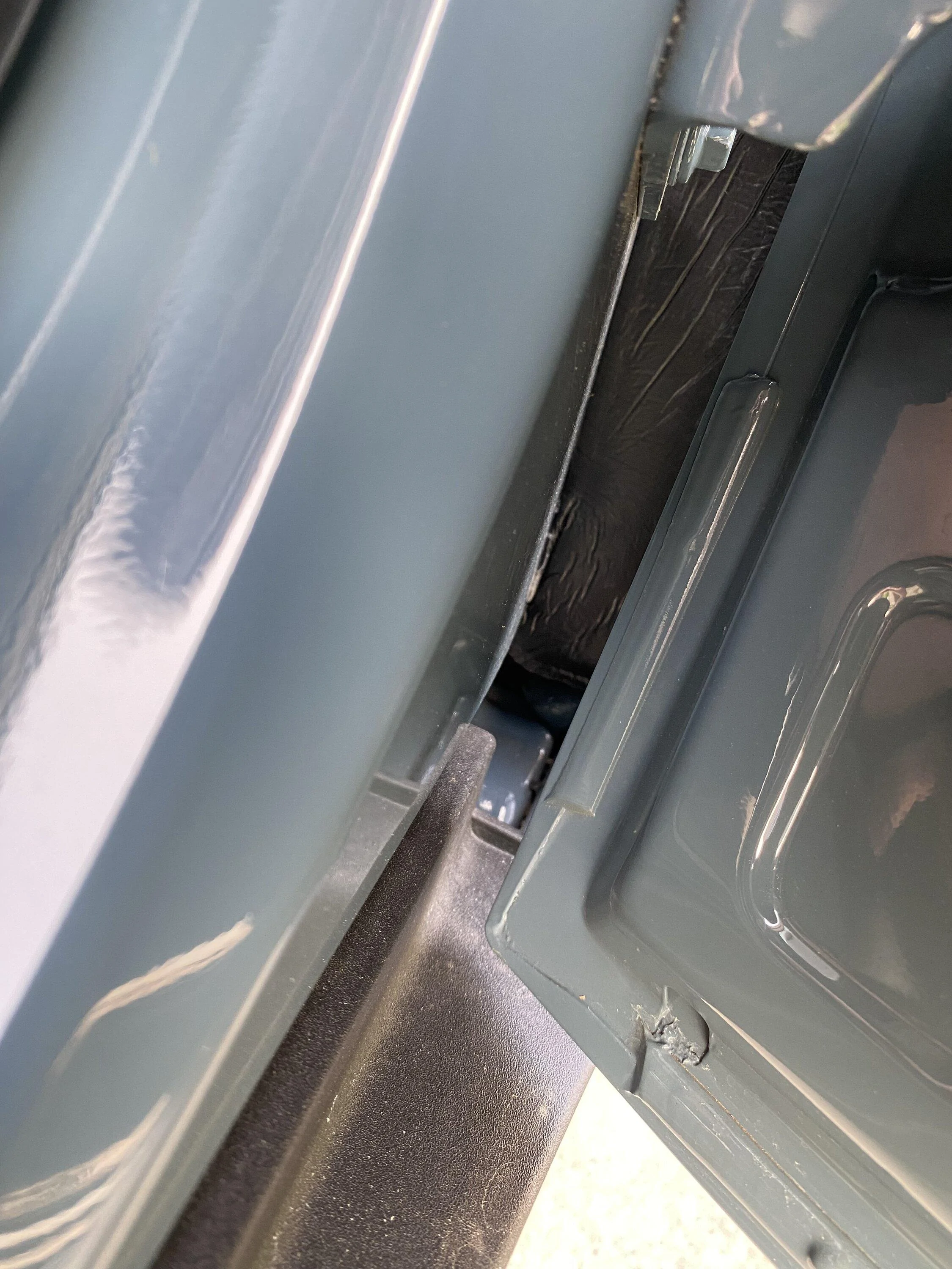

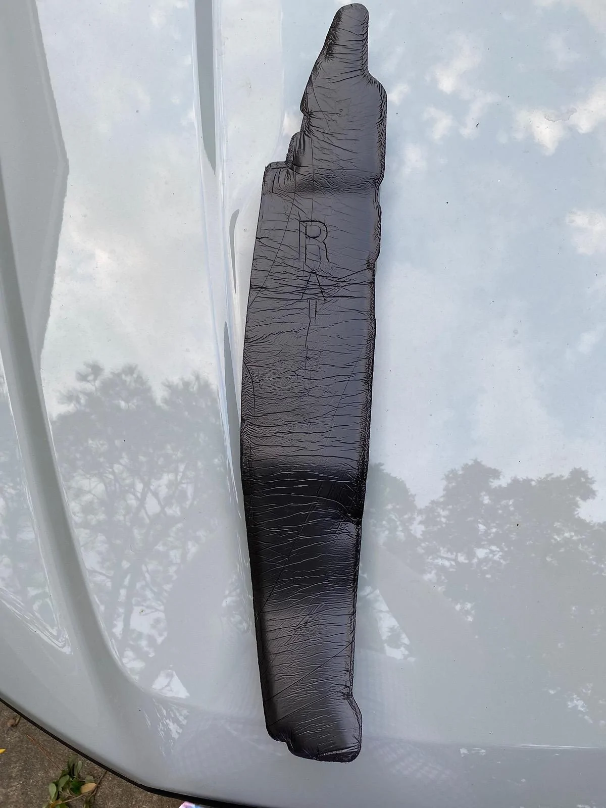

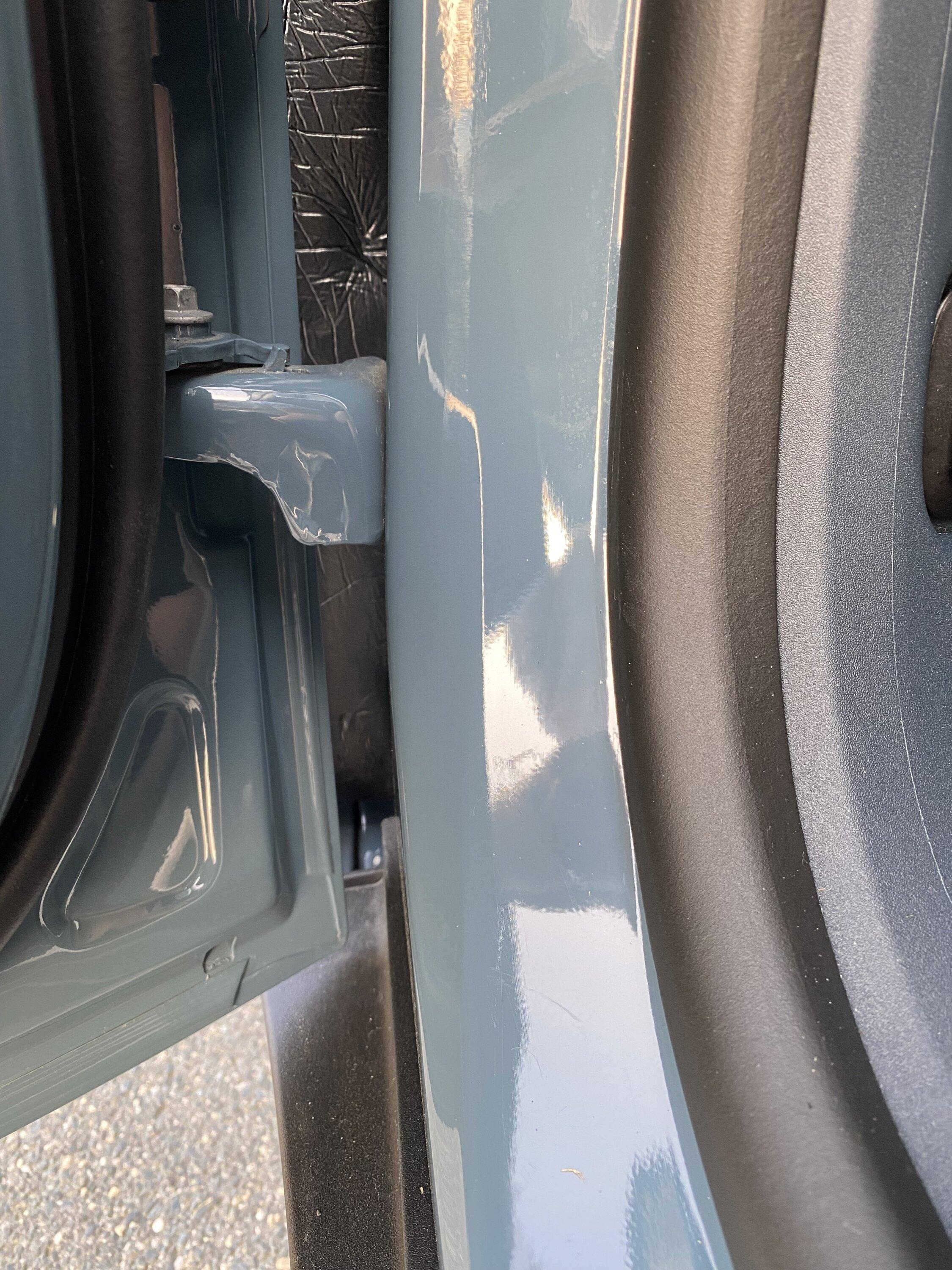

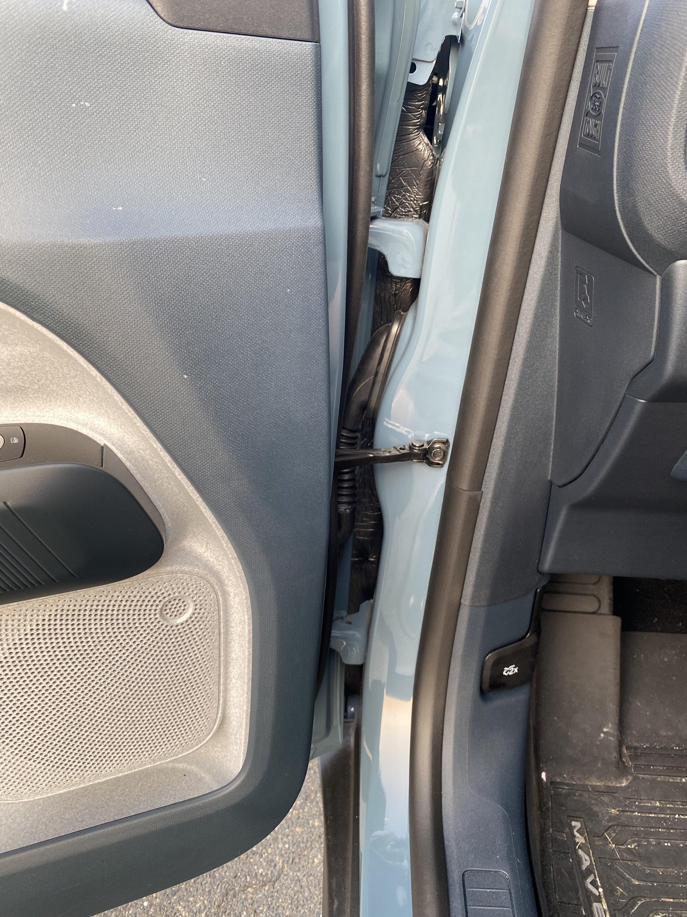

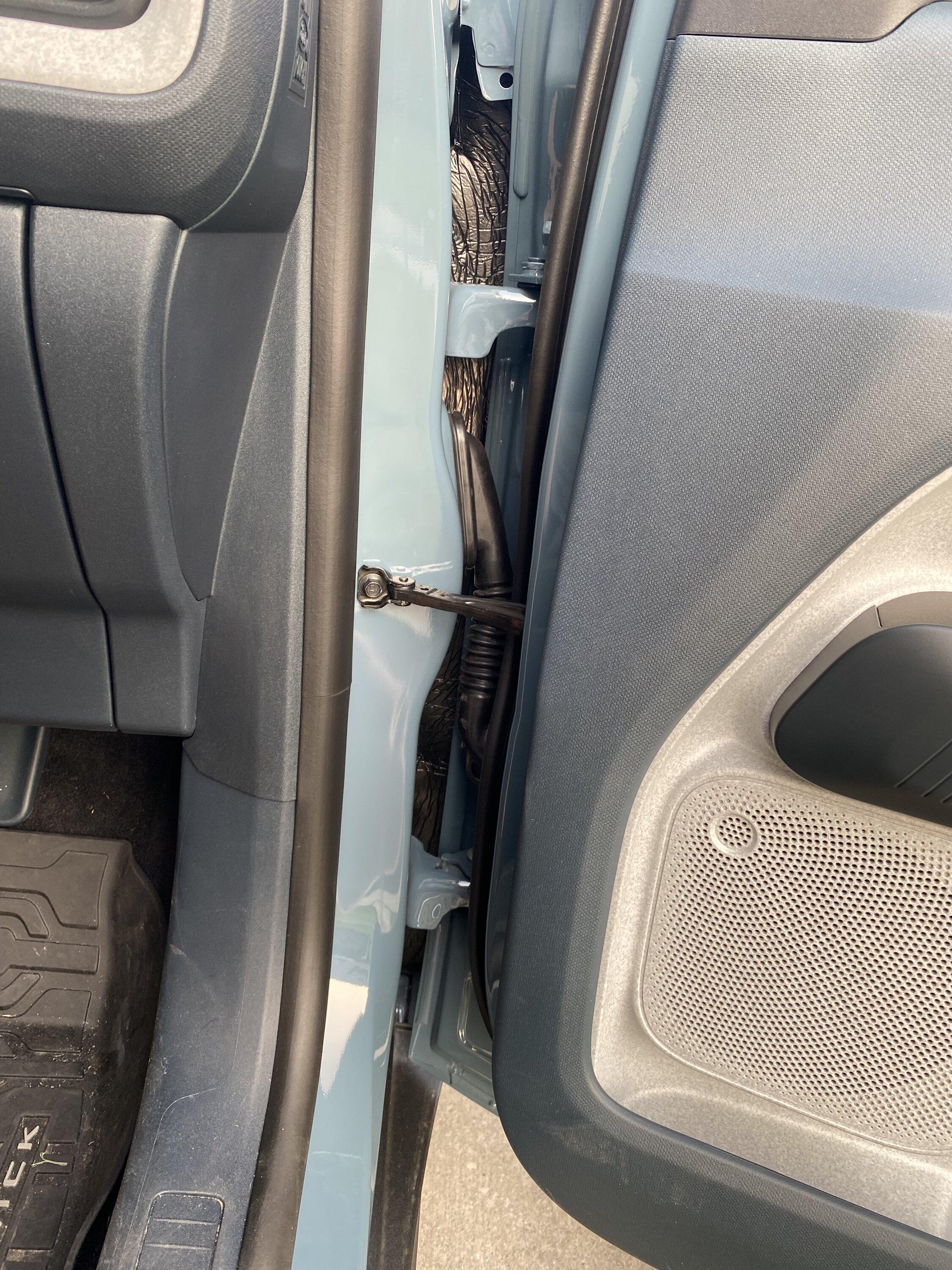

Got my insulators in the mail today and put them in. I will start by saying I installed them a bit different than what I see in this thread (even the ones from the factory).
I put the one marked “R” on the drivers side and the “L” on the passenger side. The smooth side of the insulators are facing the back of the truck, and the bubbly side is facing the front.
I did it this way because the dimples lined up perfectly with every screw and bracket in the fender. They fit tight from left to right and pretty tight top to bottom (the drivers side could probably be pulled a little north to fill the rest of the gap in, but my arms were scraped to hell so I threw the towel in.
I haven’t driven with them yet, and I doubt I’ll notice much of a difference, but it bothered me seeing the engine complement when I opened the door.

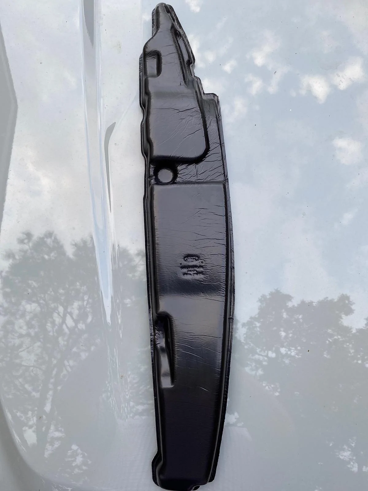

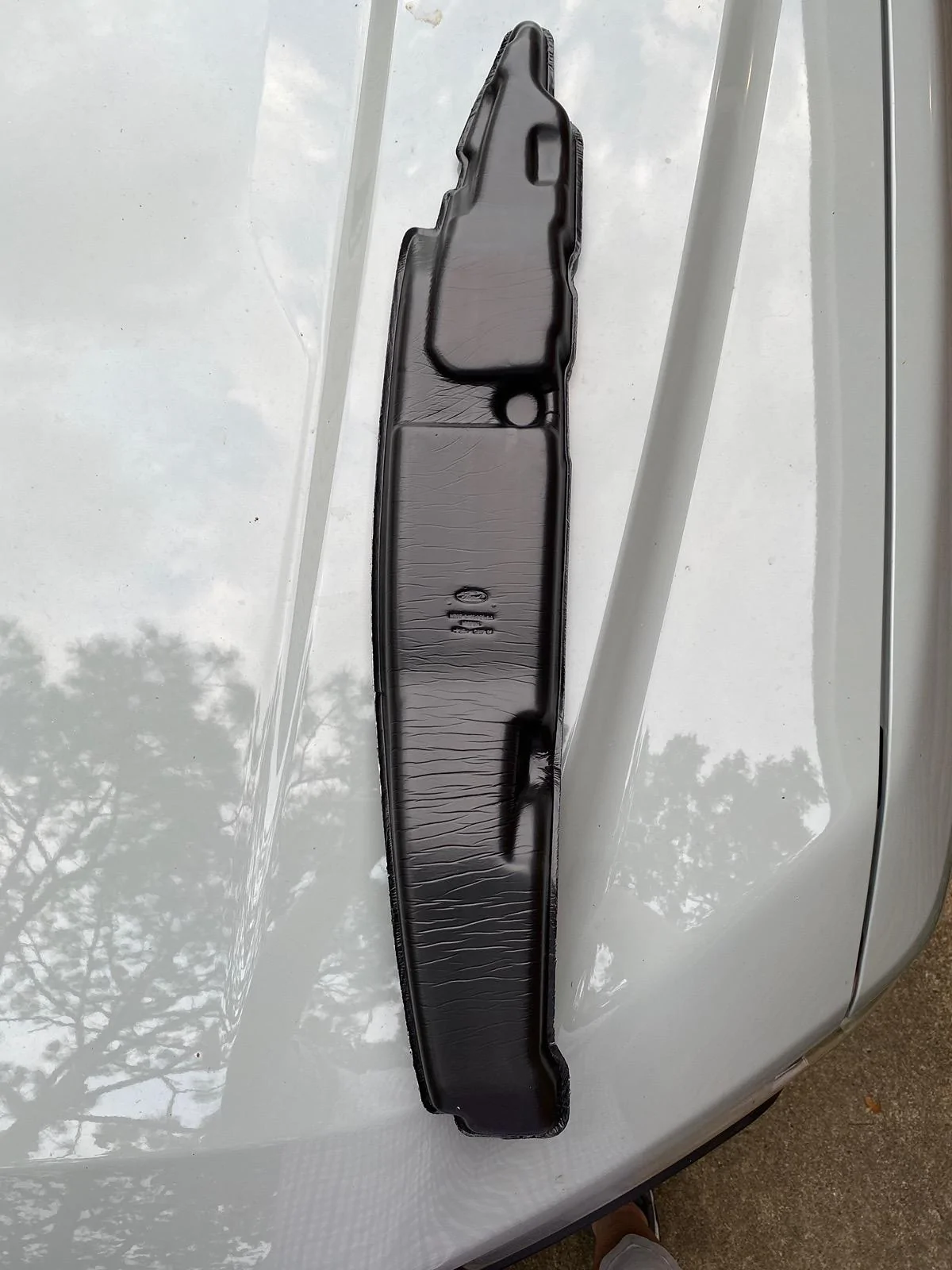

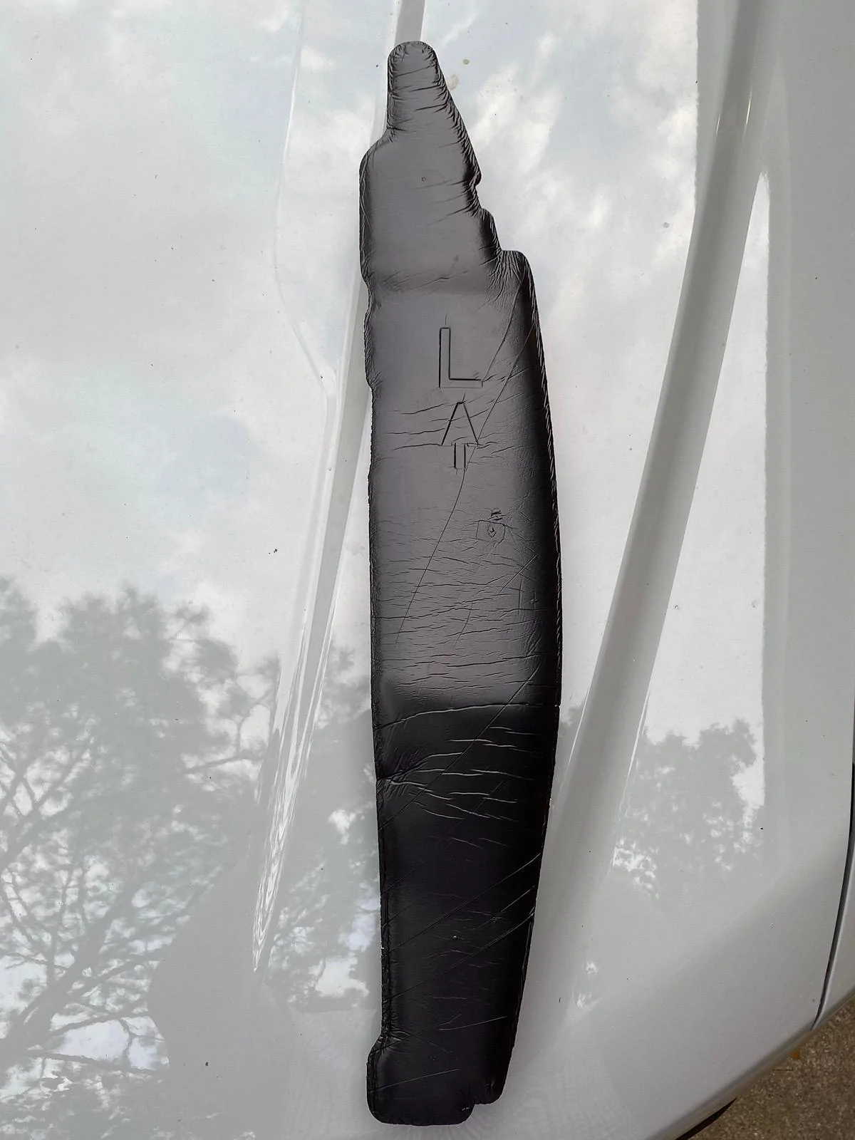

Thanks for this tip!! Got these in easy and quick by removing the bottom three clips as suggested. Im including a couple photos of how these are contoured for others. I was afraid it would be hard to tell how to orient them buts it’s really obvious.
