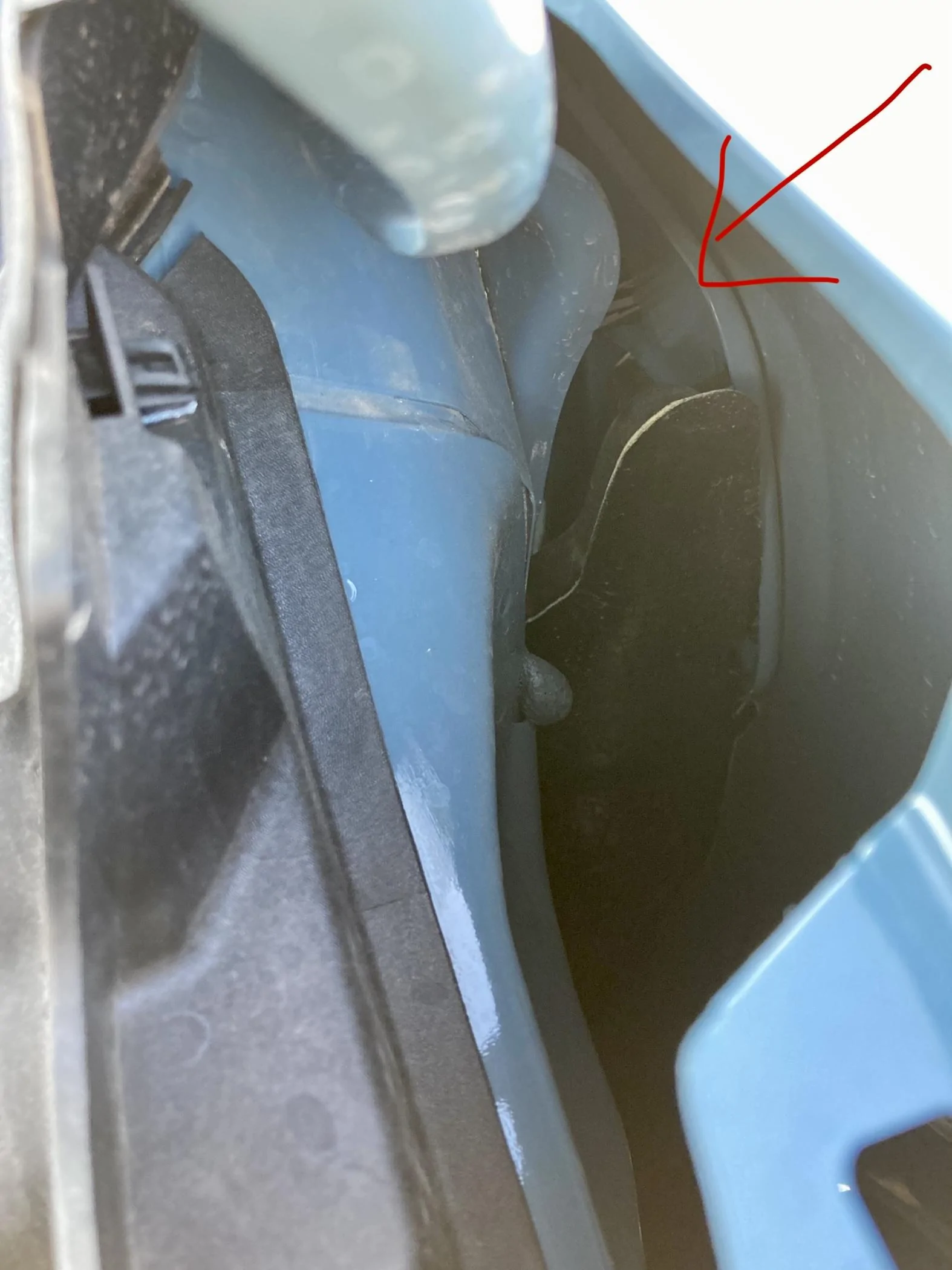

Fellow Maverick owners- I had noticed being able to smell oil/engine bay smell(s), when opening passenger door… come to find out the normal black foam/rubber or even insulated carpet material found on most all vehicles was missing!? This is the area behind both door hinges (driver/passenger) that is the fender to engine bay openings. I have attached a couple pictures. You can see where the insulation would attach with a retainer clip….? Is my Maverick the only missing these?, is your’s missing..? Is this another cost cutting? If cost cutting, I will have to add my own, one for noise and wind and etc, but also I don’t want to smell or hear or feel engine bay nuances…?? Never seen this before guys? This is both sides! As you can see the washer fluid reservoir passenger side, and driver side is the same….
Same here on my Maverick. However I had a 2013 mazda 3 you could see into the engine compartment and I can see the same for my 2007 Corolla. It's just that the space happens to be larger on the Maverick. Seems normal to me.
