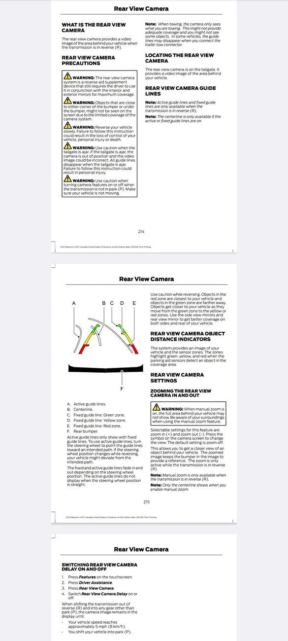

Anybody have this problem? I have no guidelines shown on the reverse camera. I have checked all the settings indicated in the owner's manual. My Maverick is a 2024 XLT with only a towing receiver for an option. Are the guidelines only included with some other option package? The manual is not specific as to which items are not included. My truck has a 6/6/24 build date, I bought it in mid July, I have just a little over 1,000 miles on it so I am still learning the controls

Are the + or - symbols showing on the reverse screen? If it shows - then it is zoomed in and will not show the lines.
The lines are for all trims, it should be available. I know people had issues if the system wasn't taken out of some kind of demo mode by the dealer, but I haven't heard of it being a common issue.

I have the plus and minus and those work if you touch them. A demo mode? That's more than I knew this morning. Thanks, I will check that out and see if that's the problem.
Try looking through this first.
Ford Maverick No guidelines shown on reverse camera Screenshot_2024-08-26-08-07-43-22_e2d5b3f32b79de1d45acd1fad96fbb0f
If the above does not work.
Your Maverick is still under warranty. I would take it back to the dealership, before I would start messing around with reprogramming anything. It is Fords responsibility under warranty.
