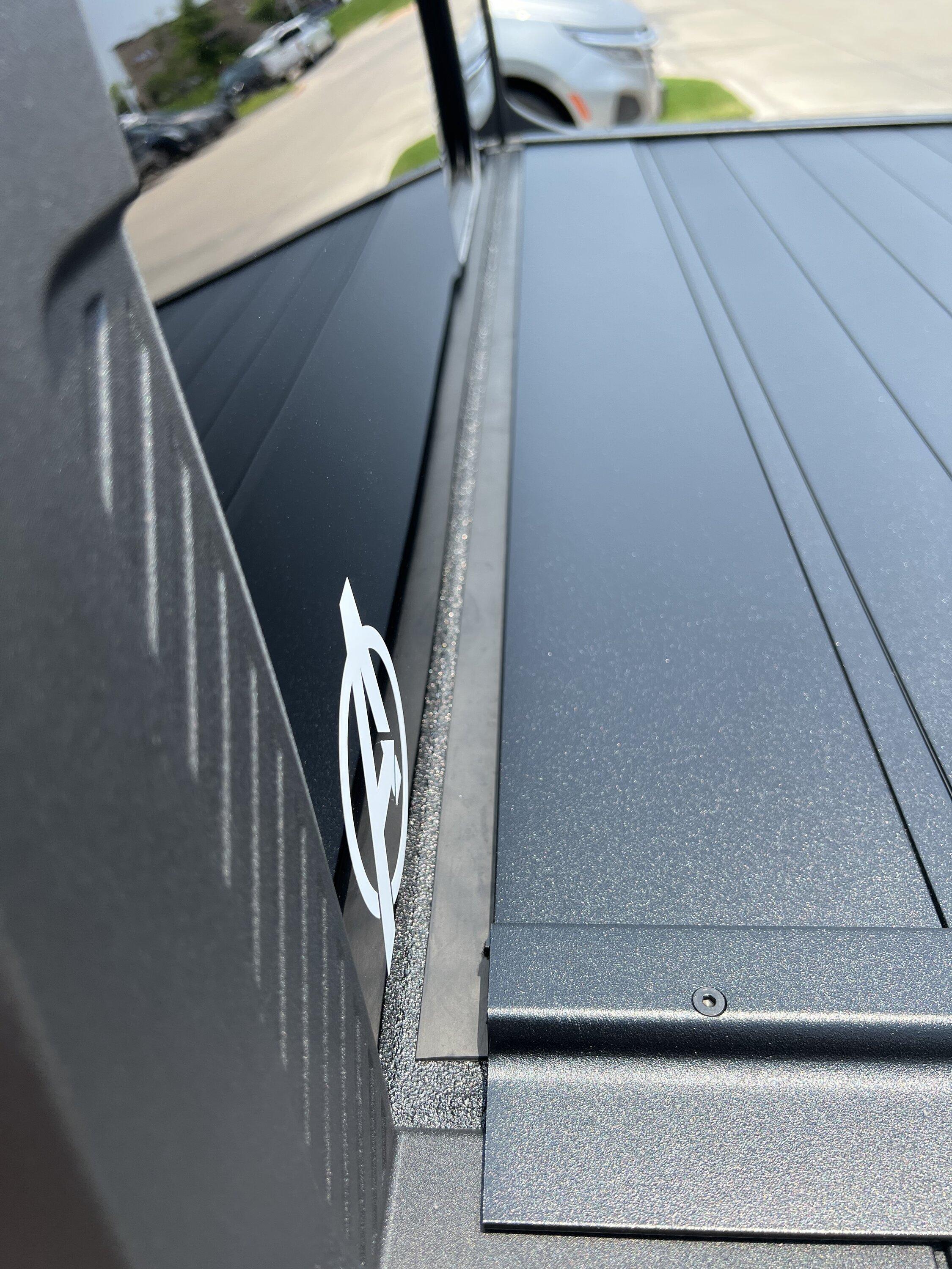

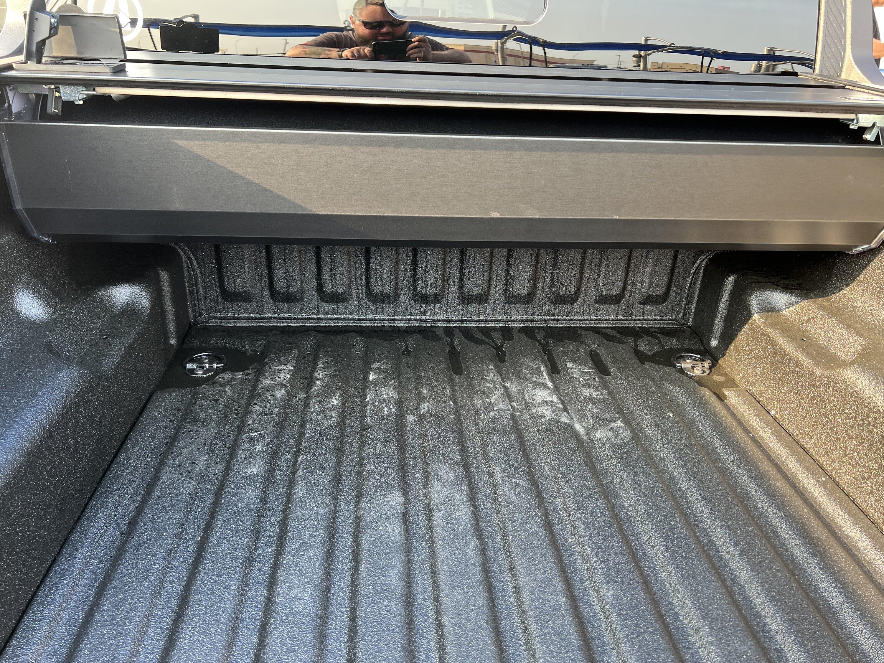

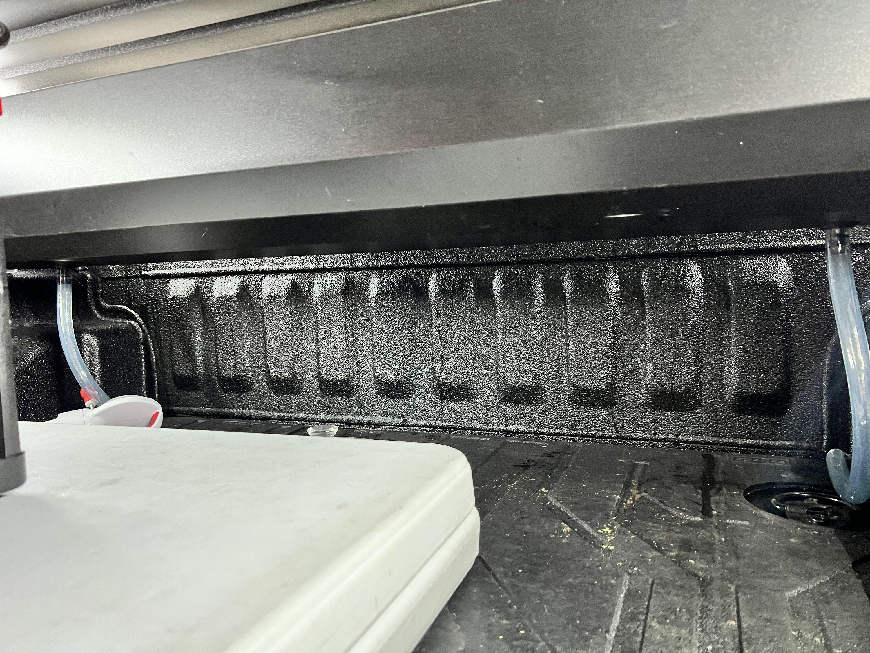

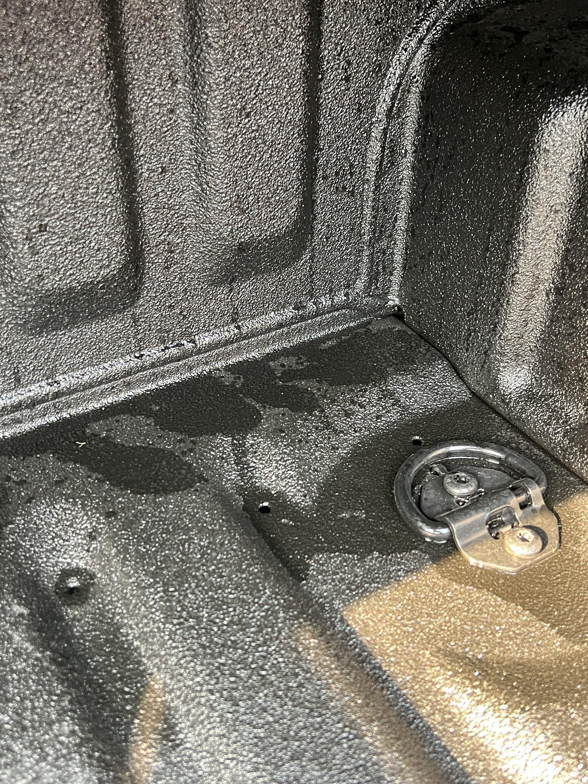

I’ve bought the RetraxPro MX bed cover and had a Retrax dealer install it. I’ve expected some leaking issues around the tailgate but not at the front of the bed. There is not a gap between the bed and the cab, so I’m thinking that’s why water is leaking down the wall. It may also be in combination with the spray-in bedliner. Are y'all experiencing the same? If so, did y’all put weatherstripping towards the top-front of the bed?
Also, the drain tubes that came with the bed cover are too big for the pre-existing holes. Have y’all used alternative and compatible drain tubes?

I have a undercover trifold, it seems just a little closer towards the glass than your pic and has a rubber seal thicker than what I see in your pic, rarely leaks in bed but has been times of minor leak, factory drain lines fit great In factory bed holes also have factory SIBL

So my bed cover is retractable and the dealership sprayed the bedliner. Is your bedliner the same brand? If so, those 2 things are the only difference.

Thought the drain holes were on the sides right next to the canister (one each side), hidden from view in your photo. Is it routed to those?

Retrax will send you new tubes if you are having an issue. I siliconed mine in place.
The Retrax Pro is not water tight. I have water enter from the rails the slats run in on either side.
The top seal of your canister is also resting on SIBL and not a smooth painted surface.
A bead of silicone underneath may help if it’s not the drain tubes.

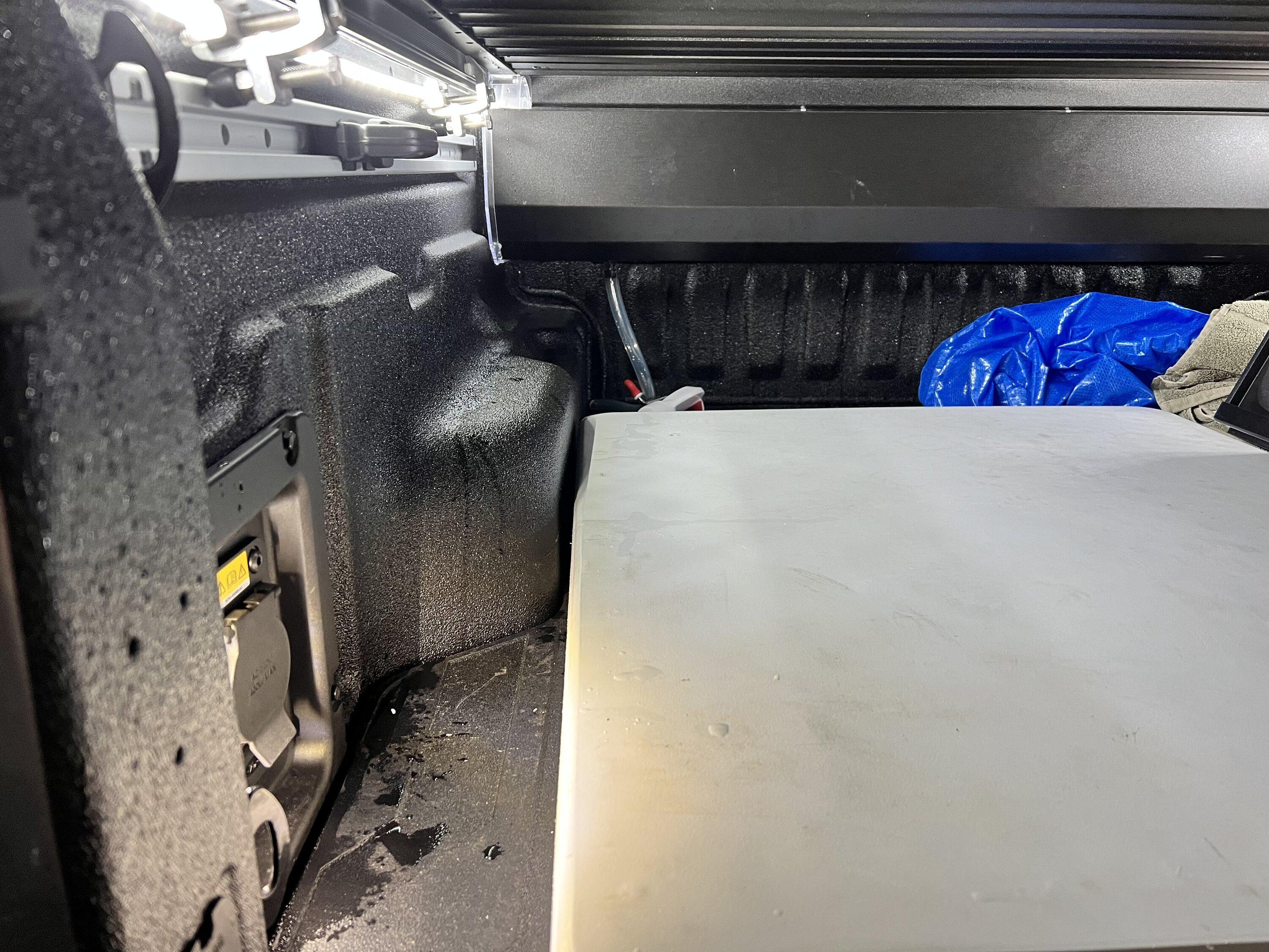

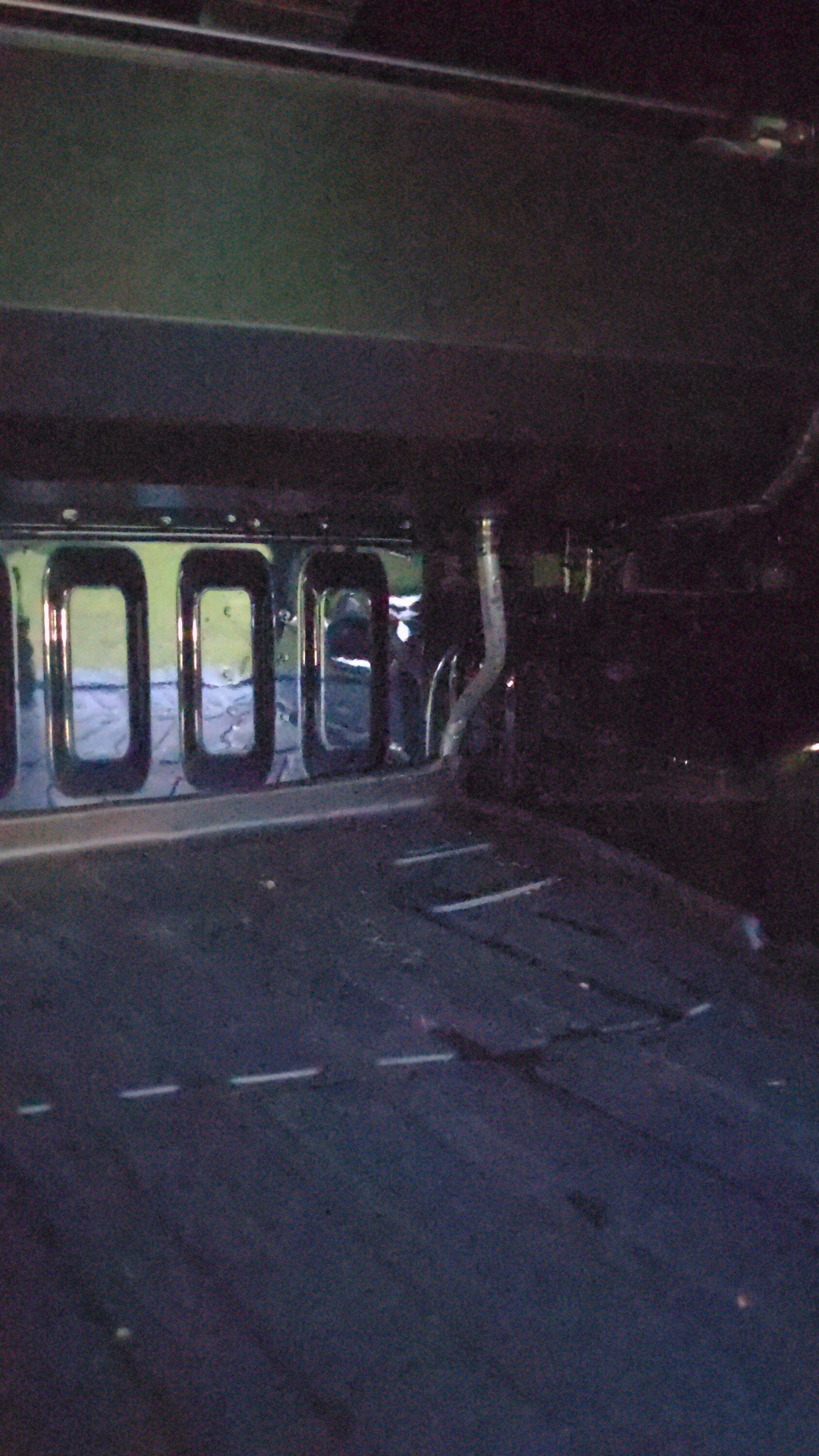

Rained here last night so I took a look in my bed.
My driveway is sloped so my truck is parked so that the left rear is the lowest point and right front is the highest.
Water has dripped down from the left rails as it collected. Right side completely dry.
Before I had my SIBL done at the dealer my front gasket was on smooth paint so It was a completely tight seal.
I did notice some water had made it past the seal and down the front of the bed but very minimal.
I run my drain tubes into the front two corners of the bed as the SIBL covers the drain holes (Don’t get me started).
The positioning of the factory drain holes and the depths of the canister make the drain tubes almost ineffective as the water has to go up to drain.
The bed mat allows for some water to drain underneath.

It could be from the Ford plastic panel seams at the very bottom right of your last pic. Water will infiltrate there if not fully sealed. Suggest having the installer pull up the rail in that area and lay a bead of RTV in and reinstall. Note, most all cover are water resistant, but not water-tight.

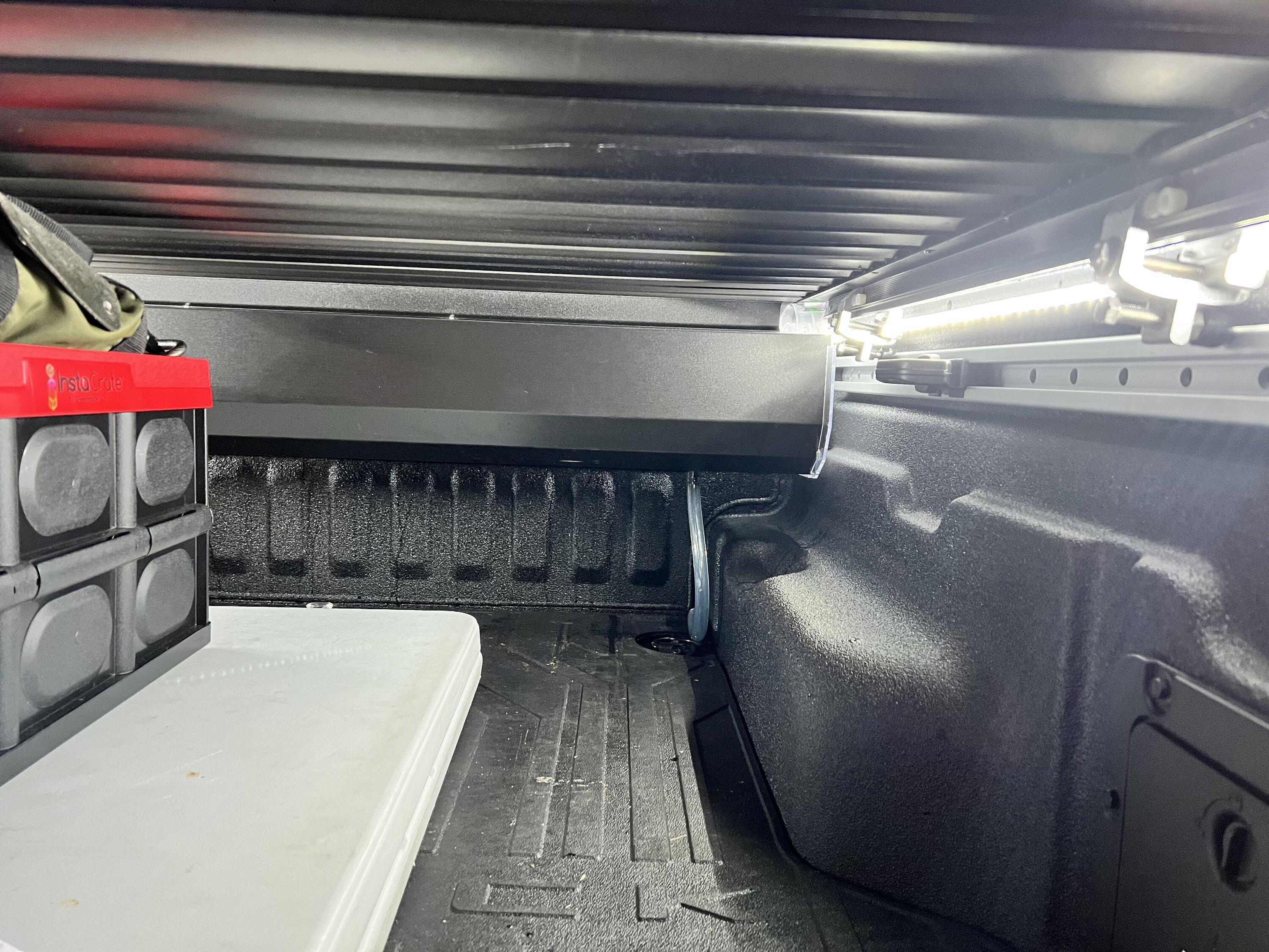

I have the Mixsuper bed mat from Amazon. It is really thin but has raised edges and helps hold my drain tubes in place in the corner. Still considering adding silicone or plumbers puddy or roll caulk to where tubes plug into canister and around head wall. I have it better than it was but still not weatherproof .
