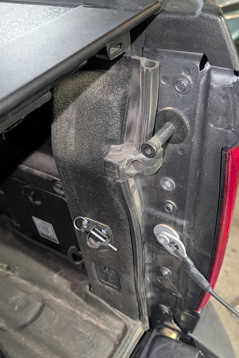

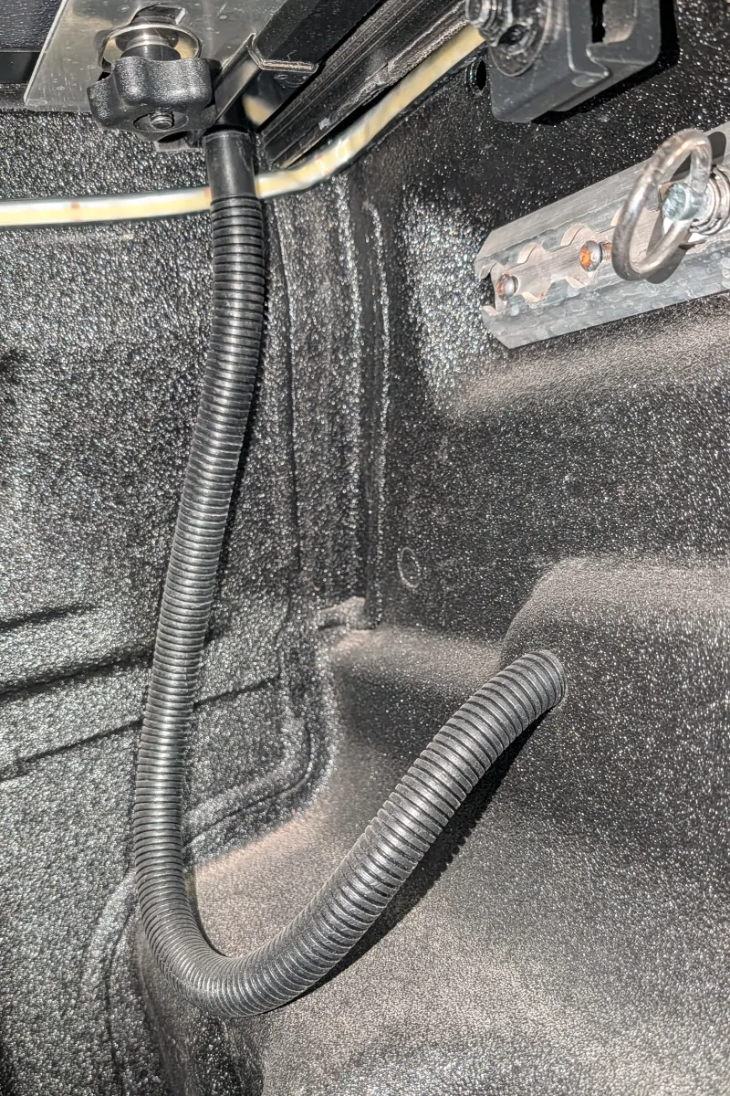

Agreed. It doesn’t accumulate ahead of the tonneau, BUT it also doesn’t leave water in the bed, driving or parked outside. It works just as it’s designed – drain tubes that lead to ports in the side of the bed. I’ve never had water leak in from the front or sides of the tonneau cover, even in torrential rain. I’ve placed tailgate seal along the bottom and both sides of the tailgate opening. That prevents all but minor moisture, which does appear at times through the top, where the tailgate meets the tonneau, usually at the carwash (manual wash). I’ve considered adding the same seal to the back bottom edge of the tonneau, but figure that would raise it enough to break the side seal. Maybe if I shave it thinner, or if I lay inside the bed with everything closed up I could place the full seal butted against the tailgate, but why give my wife a chance to lock me in there for a spell… :angel:
Ford Maverick Newbie questioning the low area between bed and rear window. Mav Tailgate Drain
Ford Maverick Newbie questioning the low area between bed and rear window. BakFlip MX4 drain
