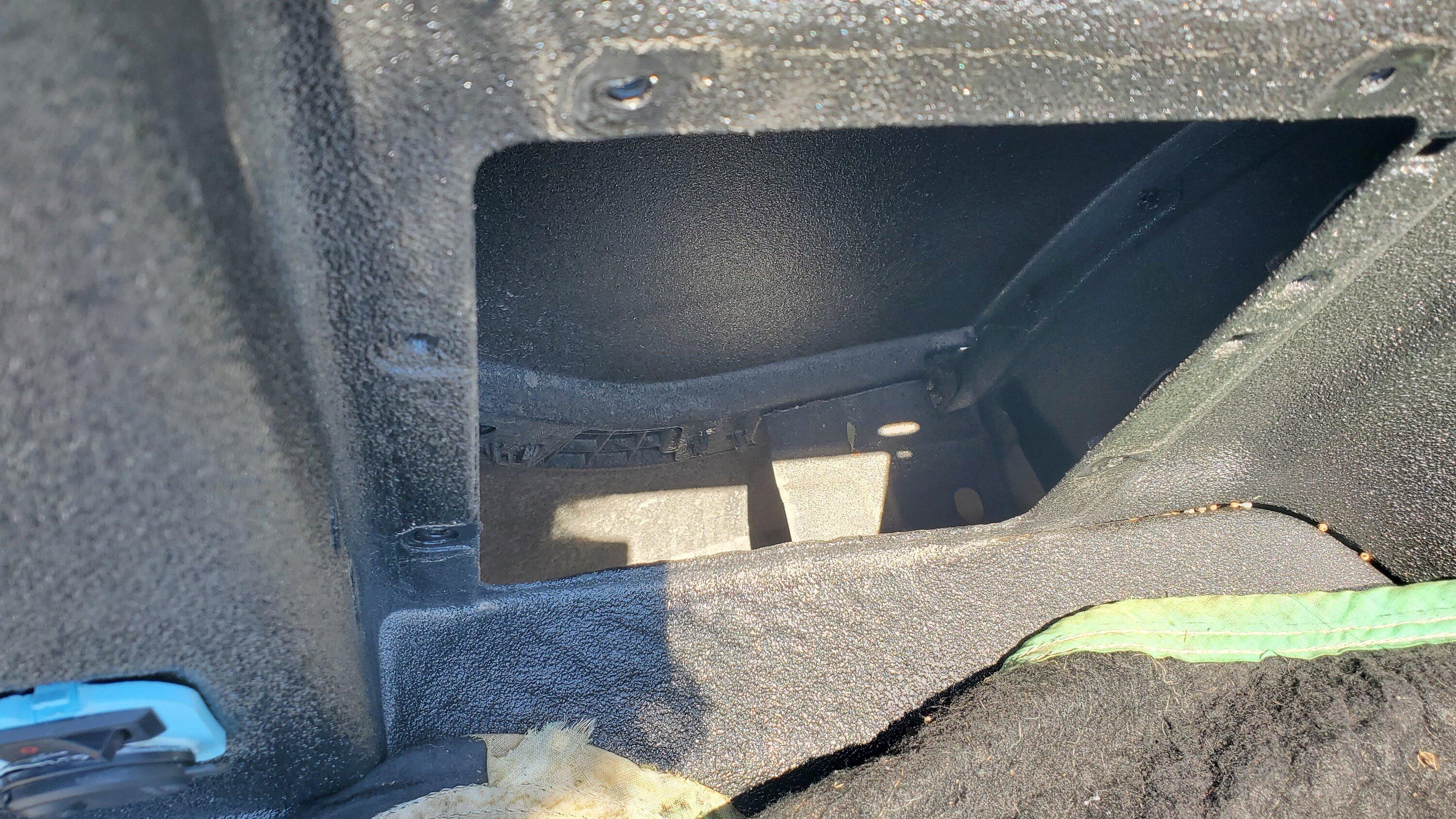

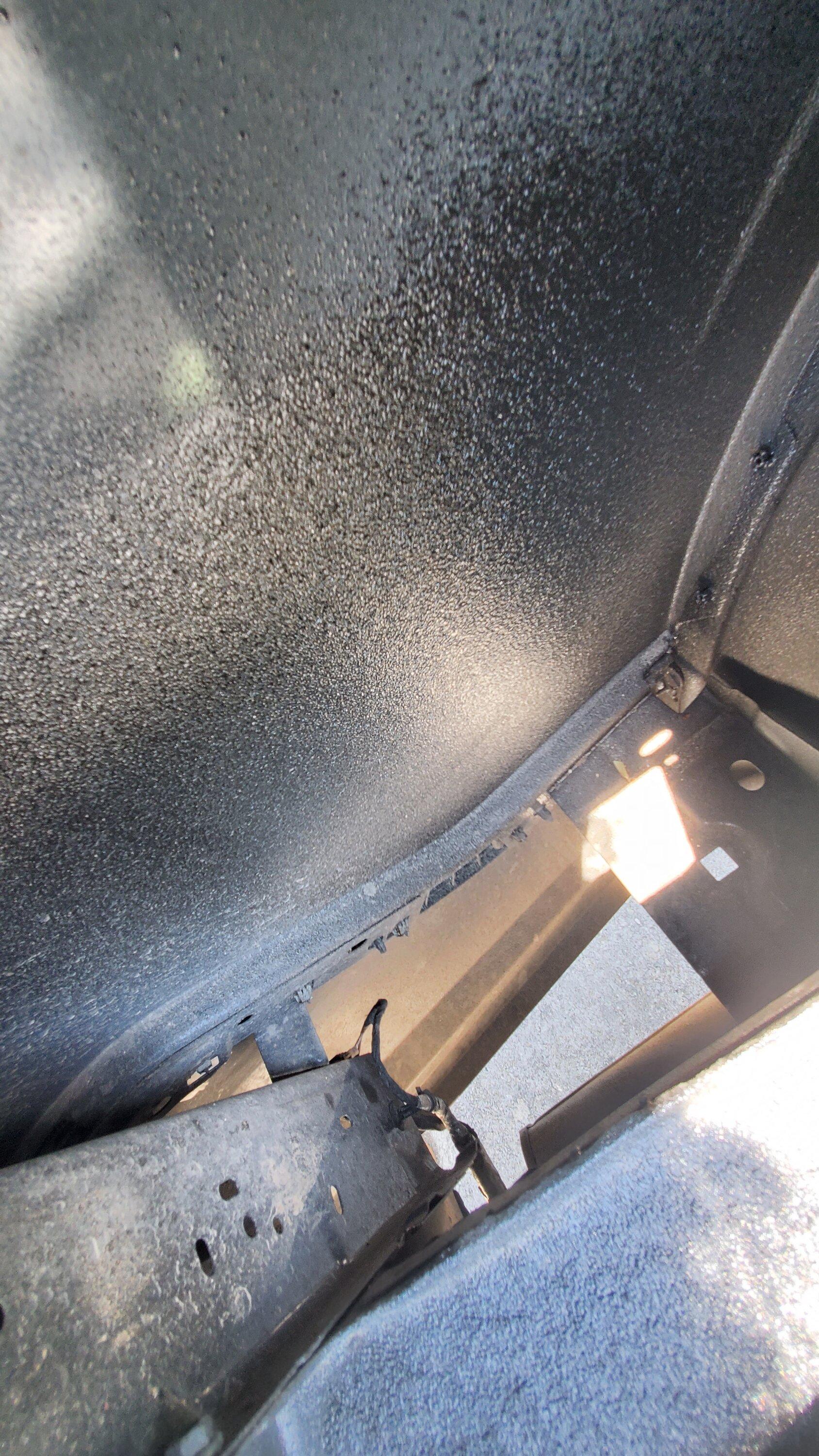

I actually just installed my second cubby yesterday and so looked inside the fender...there's A LOT of room there but little to mount to, you'd likely need to fabricate an entirely new cubby that mounts to the existing 6 threaded cubby mounts.
I'll update this post with photos later today if no one else does by then

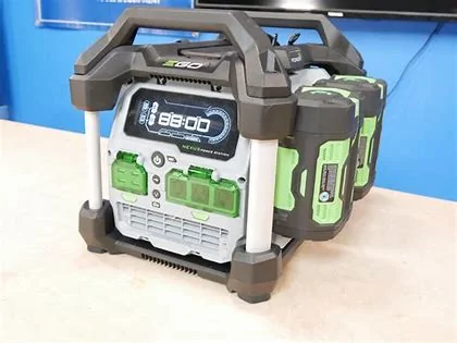

I am thinking about doing the same thing. It would be interesting to potentially dissassemble and repackage one of the existing "portable solar generators". We are installing a cap and will likely have room for a flexible solar panel on the roof of it. So we would probably do solar input but may also use the 12v charging aswell. The 12v is fairly low powered but should trickle charge a battery atleast. Another question is should we use 12v, paired small 6v, lithium, or maybe power tool batteries like the 5ah 56volt EGO batteries I have? Granted the Maverick wont be my work truck, but the concept of having a couple of my wacker and chainsaw batteries ready to go.

Given that the 4 batteries are mounted on the outside of this. It makes me wonder how much smaller the packaging could be on this? If one came up on craigslist or ebay cheap, I would consider breaking it down and seeing what to do. Maybe even extend wiring and run the batteries to behind the rear seat panel. They run power that far on some of the tools anyway. Just have the guts and hookups in the cubby.

Yup that's about what I'm seeing, a bracket could be fabricated based on what little mount points exist but there's plenty of room
