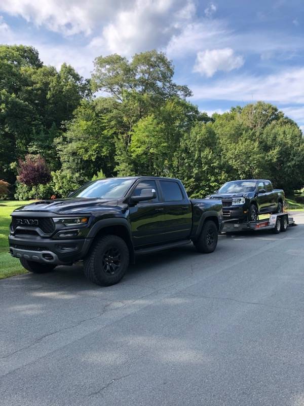

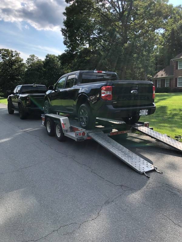

[edit] here's an off topic fun pic when I towed my 2nd hybrid Maverick home (with my TRX off all things, LOL).
