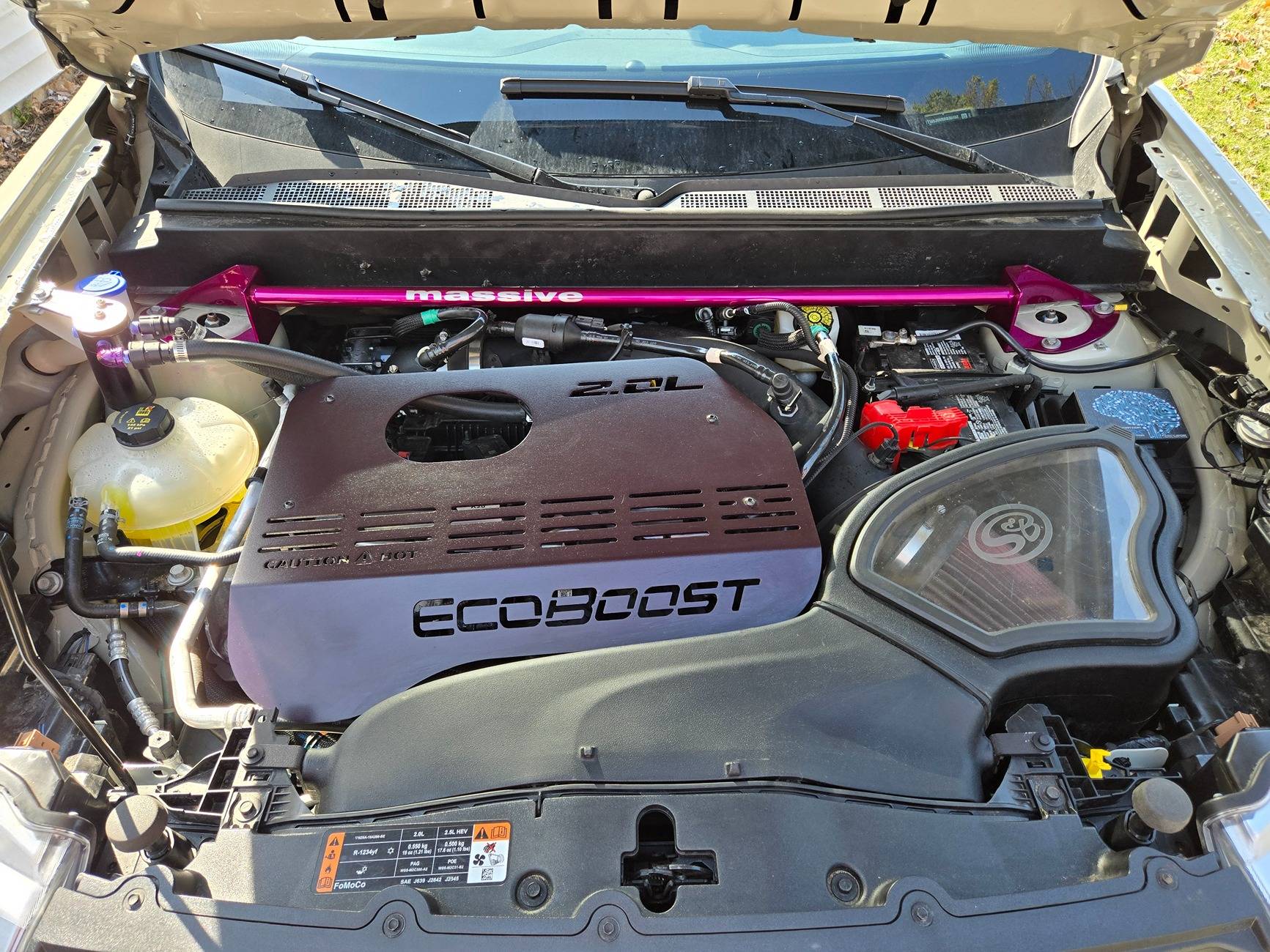

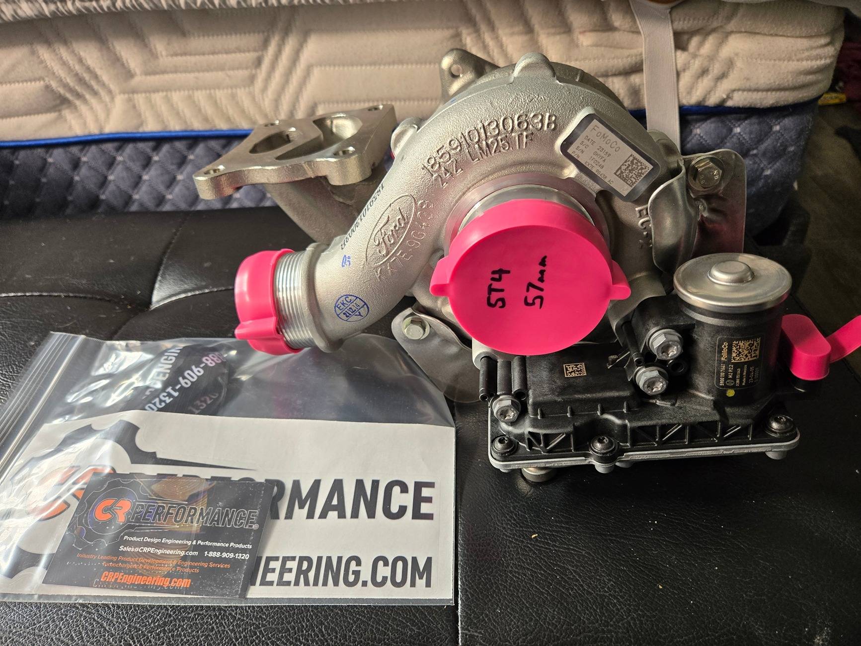

Dyno numbers yet? Pulls? Draggy? I just installed my nostrum pump and injectors and will start tuning my 57mm turbo on e85 this week.

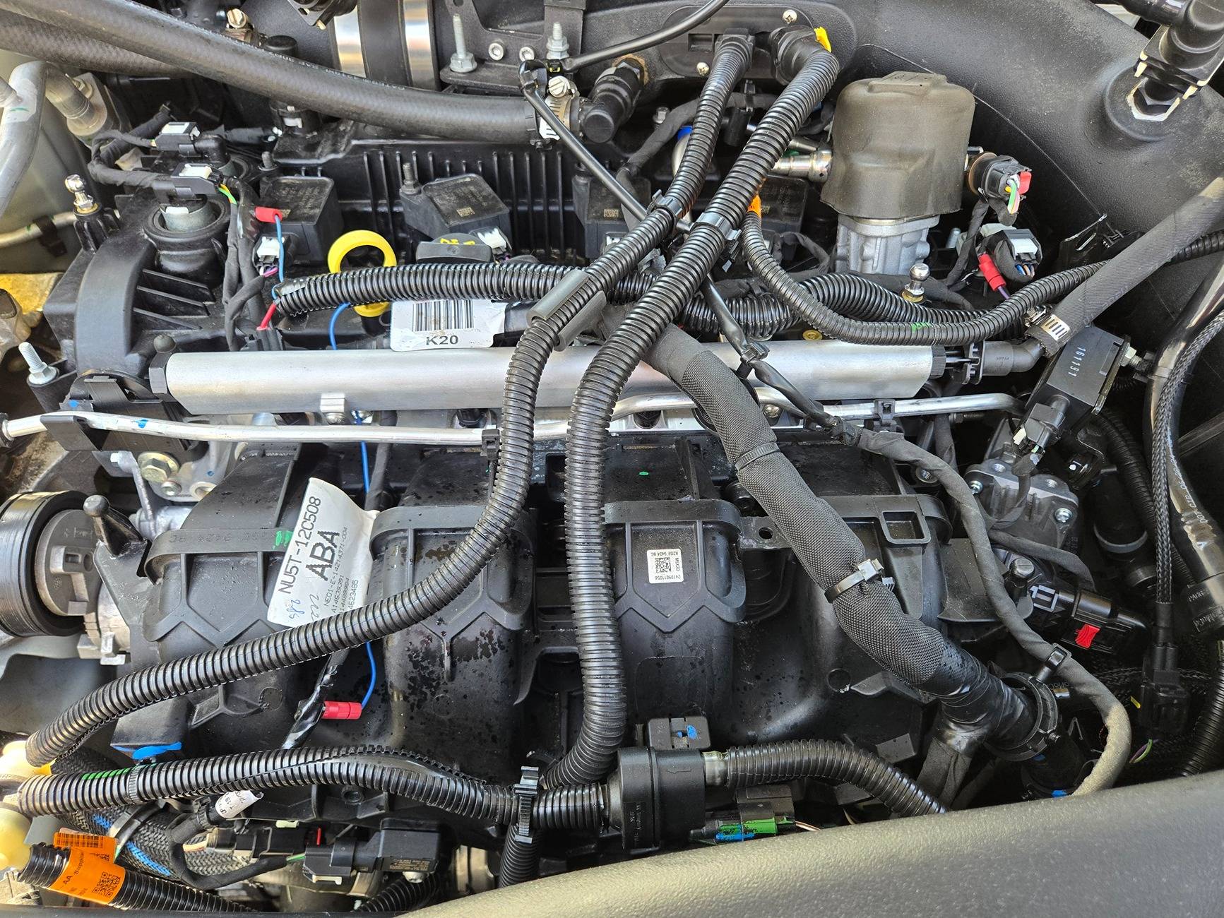

I got the only set of DI injectors available for the maverick from Nostrum. Should support more than 500whp.

Pretty sure they would be the same ones for the focus st or the rs.
