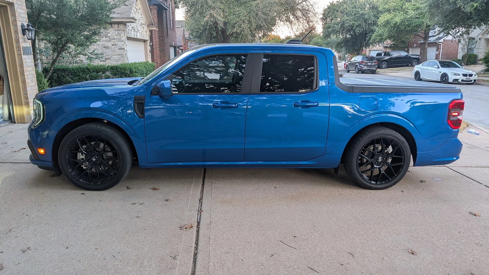

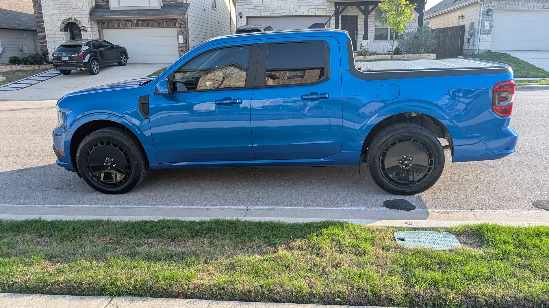

let's see if this works... if not.. I'll host them on my website. Also got truck back from shop. 1.5" drop on top of factory. happy.
What kit for 1.5" drop?
I sorta want springs, but don't want the drop...maybe .5" on the front, Max. The rear could be dropped a bit more, but I need clearance on the front.
The ride height looks great form a side profile now. esp the rear.
Looks are partial to the observer, and I do like the unique turbofans, but I want a light wheel...And likely in Bronze, and wider.
What wheels and size are you running?

Silvers Coil Over kit with upgraded springs. It's technically a 2/3 drop. Lobo already dropped from factory.5 inches up front, 1.12 inches in rear. I basically went 1.5" lower in the front, and 2.0 in the rear.
my assanti rims are 20"x8" wide rims and tires are about the same weight if not less than the stock 19"x7". running nitto 245/45s. rims have a 40 degree offset. zero rubbing at full lock. tires stay just barely under fender. 38 degree offset may have been better but may have rubbed at full lock.

This was after tint. basically the day after I bought it and today. Man. those factory rims were ugly and stupid.
Might consider caliper covers now. I had no idea the disc brakes were so big. I'm keeping my turbo fan dinner plate rims. I like different. Great job all around BTW 👏
