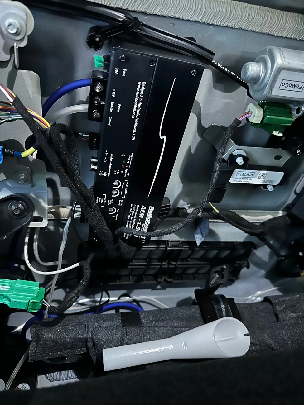

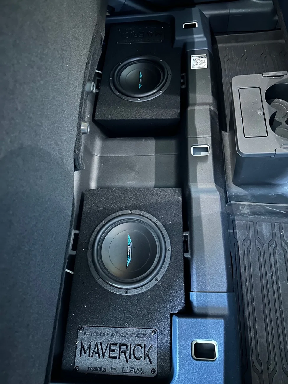

Added some Sparco Gravel 18x8 Wheels in bronze, tonneau cover, tinted the front windows,
(2 ea.) 8" Image Dynamics Subs & an Audio Control Amp (ACM-1.300).

I have a Hybrid Lariat. and a couple questions if you don't mind.
Where did you get the sub box from?
How did you wire in the Amp?
did you bypass the B&O sub or just leave it?

I got the sub boxes off of Ebay, it is made by Ground Shaker (ground-shaker.com). I just tapped into the factory sub for the signal & yes, I did keep the factory sub. The Audio Control Amp has high-level inputs.
There's no benefit and only a drawback in keeping the factory sub when using a real sub. The spl produced by the underpowered 6x9 is mostly irrelevant, but if you did hear it, it would manifest as a midbass boom.

It's trivially easy to unplug the 6x9", try doing that and listening again. I'd wager you'll realize that it does contribute more than you think. It won't dig deep into the infrasonic range due to limitations of the infinite baffle design, but it does work in the mid and low bass range.
https://www.kicker.com/app/misc/support/tech/tech_papers/docs/InfiniteBaffleGuidelines.pdf
It doesn't stand up to the 600-watt 12" Kicker Solo-Baric L7T I had prior to the Maverick, but I didn't expect it to either. I do wish that the B&O was the stock system and there was a higher end "premium" system but it's a competent enough system for what it is.
somewhere here on MTC, someone had done a RTA of the stock system but I can't recall if only 22-24 base, or also B&O.
at any rate I'm pretty certain that the B&O 6x9 does not do jack sheet below 100hz, even though it's electronically crossed over at 35hz. I know this because 3 years ago I did listen to it carefully, and I thought about replacing the 6x9 which a few have done. it's not worth replacing because while the factory B&O amp does well with replacement front speakers, it just isn't giving enough watts to the 6x9 to bother.
just use it as a line-out source for a real amp & sub.
