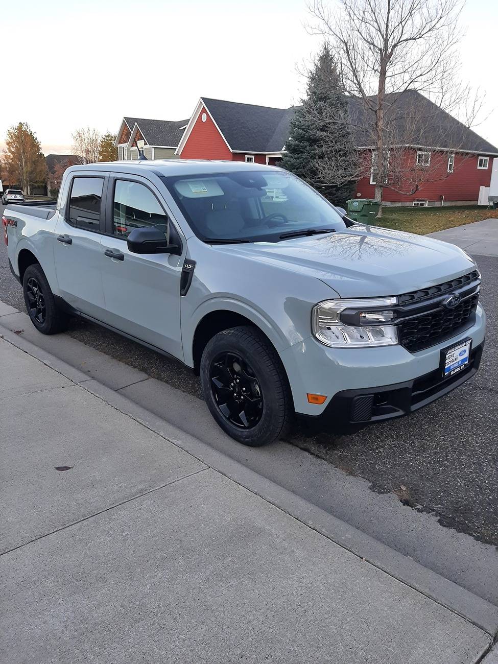

I just drove home a 2.0 ecoboost Maverick XLT fx4 AWD. So far this thing is nothing but awesome. Unfortunately the dealer did not have the optional block heater installed. Winters where I'm at in MT can get down to -30 so I'm hoping to install some level of block heater to improve engine longevity and speed up warm up somewhat.
My first question is where the removable plug used to install the factory block heater that heats the coolant? I haven't been able to come up with anything besides some info on a focus ST forum saying the 2.0 ecoboost plug is under the intake manifold on the drivers side. I took a peek and there's a plug in there that would take a huge Allen wrench. Anyone want to trace their wires back and confirm this is the one?
Has anyone installed the plug? How much of a pain was access? Was draining and bleeding the coolant difficult? I'm kinds surprised there's no write up or YouTube video out there on the job.
Alternatively I might just take the simpler and cheaper route of using a stick on pad heater on the oil pan if it looks like the plug type is going to be more trouble than it's worth.
Thanks for any input. I've got a tonneau, ski racks, and blizzaks on the way and am stoked to make this thing an all around winter weapon. A block heater would be the final touch!
