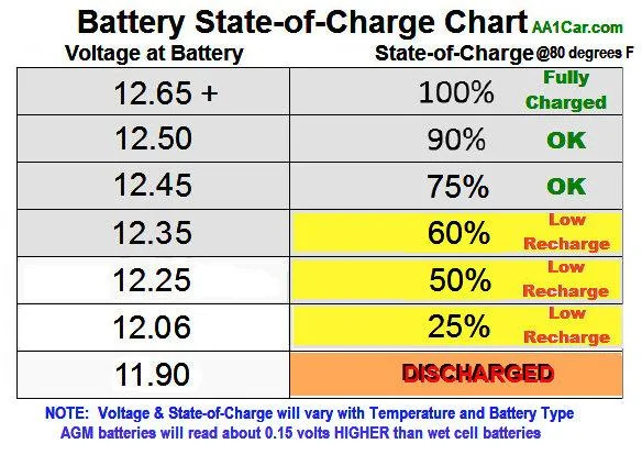

Hey Bob, get off your A.S.S. and check the battery with your volt meter, then you'll know.
Ford Maverick My Two Takeaways. battery_voltage_chart

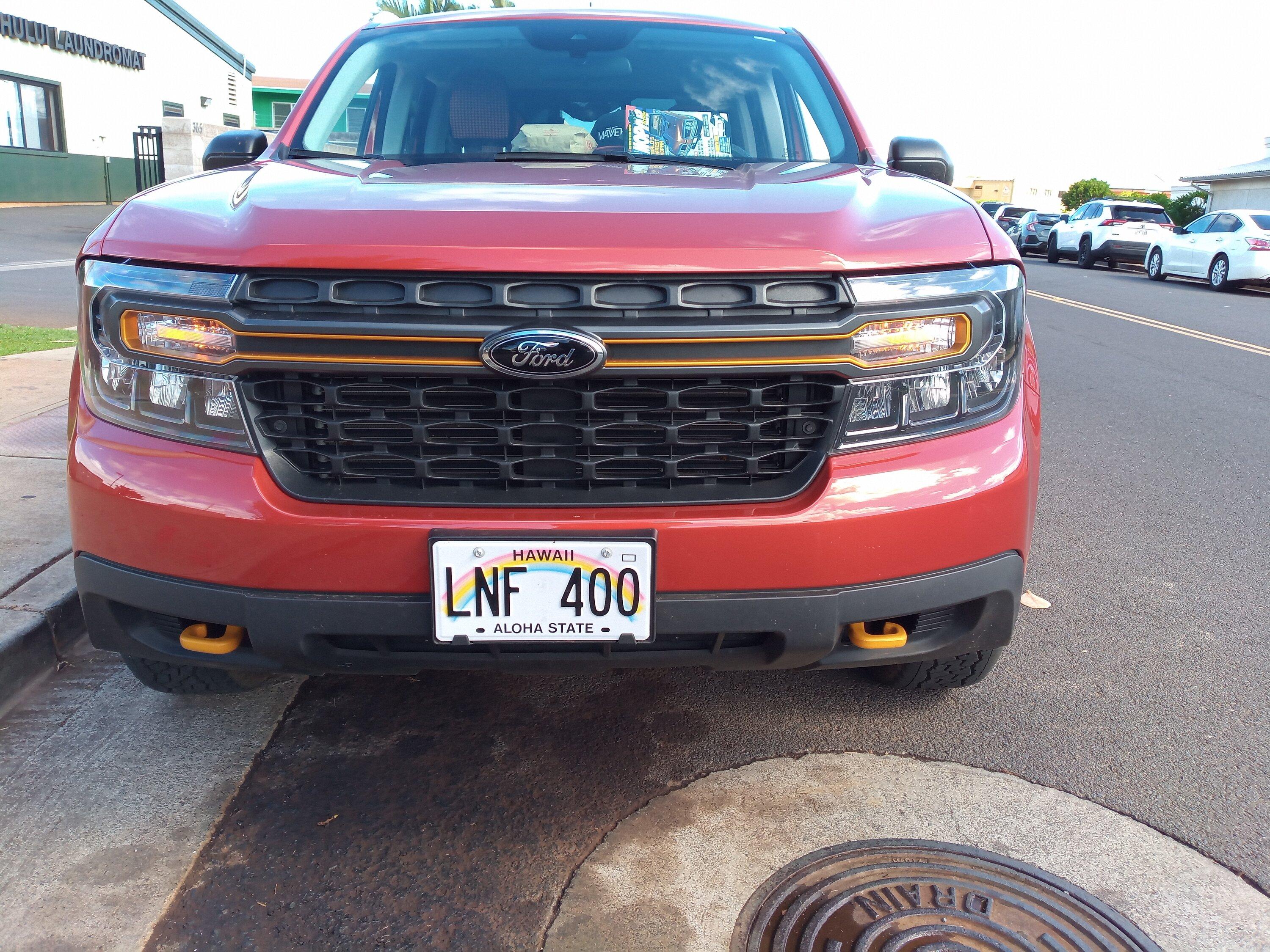

Until I read your post about the heated seats I was going to suggest driving around with marker lights only on instead of auto. Save ya a little juice. Plus it looks cooler, at least on a Tremor....

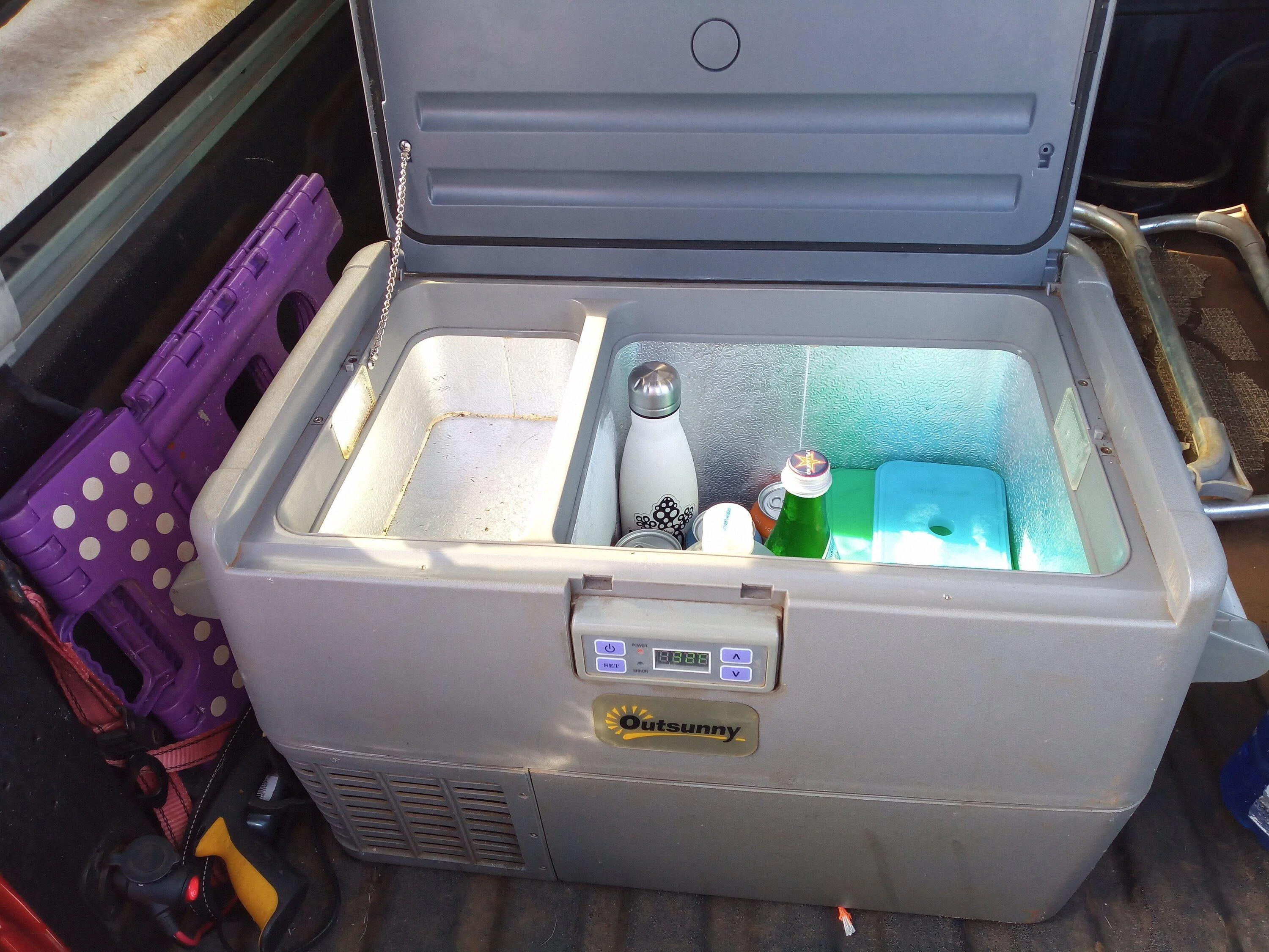

I could get holier and say you should save the juice for your heated seats since they are sooo I'm important but I save my juice for ice cold drinks! It's been running for 3 hours now and that icepack still has its frost.
