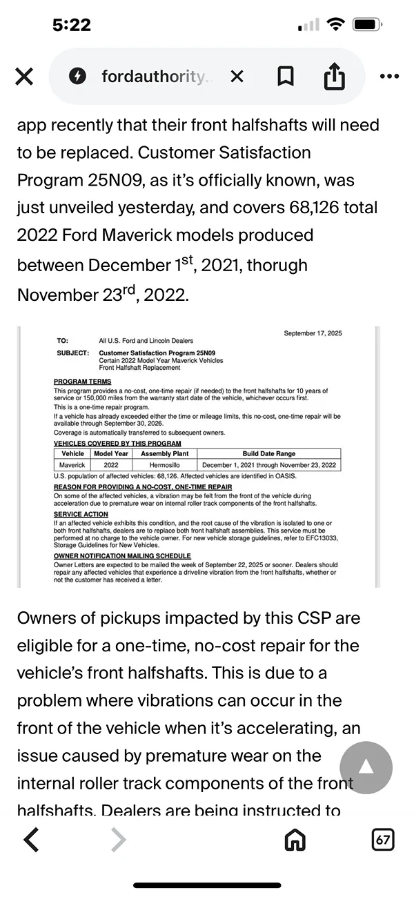

I thought they might fix them for free up to 150k (through the customer
satisfaction program). But why only the 22’s when 23 model year was also affected???
Ford Maverick My thoughts on CV axles - possible design flaw? (self replacement, tear down, tips on DIY-ing) IMG_0182
https://fordauthority.com/2025/09/s...k-pickups-need-their-halfshafts-replaced/amp/
It could be expanded later to cover more production dates, pending failure data/parts inventory. I just turned 60K on my original axles, no issues so far.... (I'm in the covered production time, so I will wait as long as possible).
