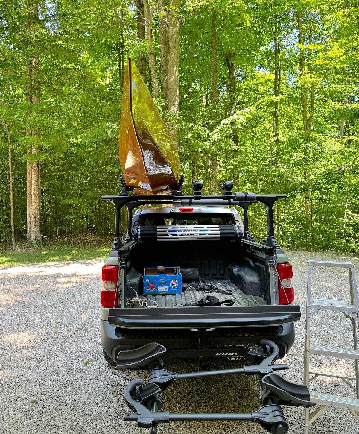

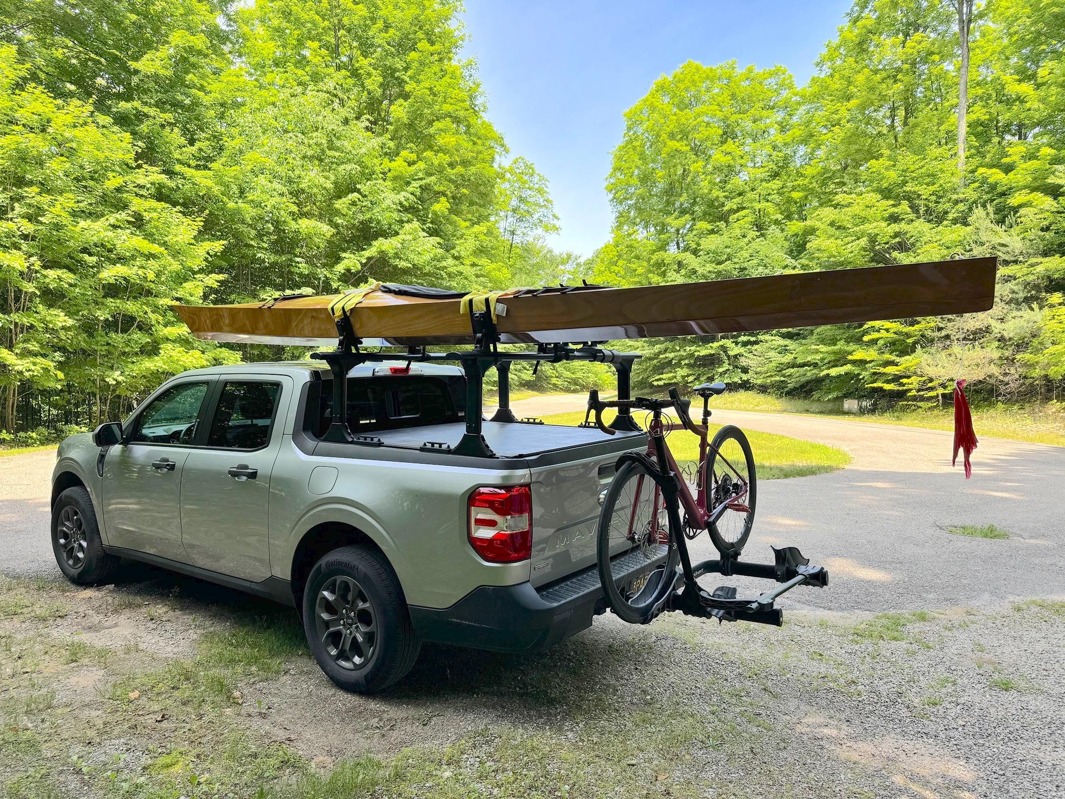

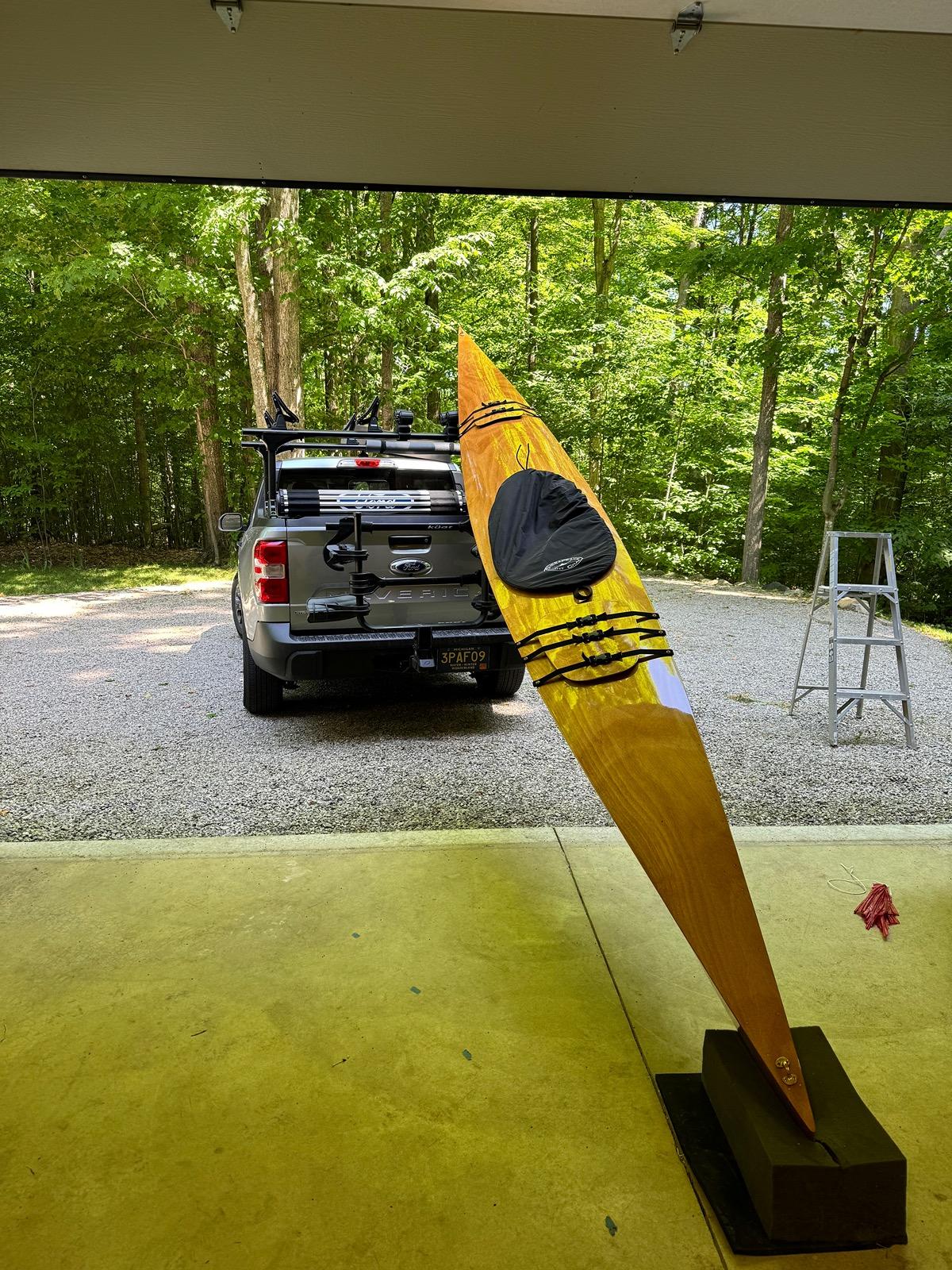

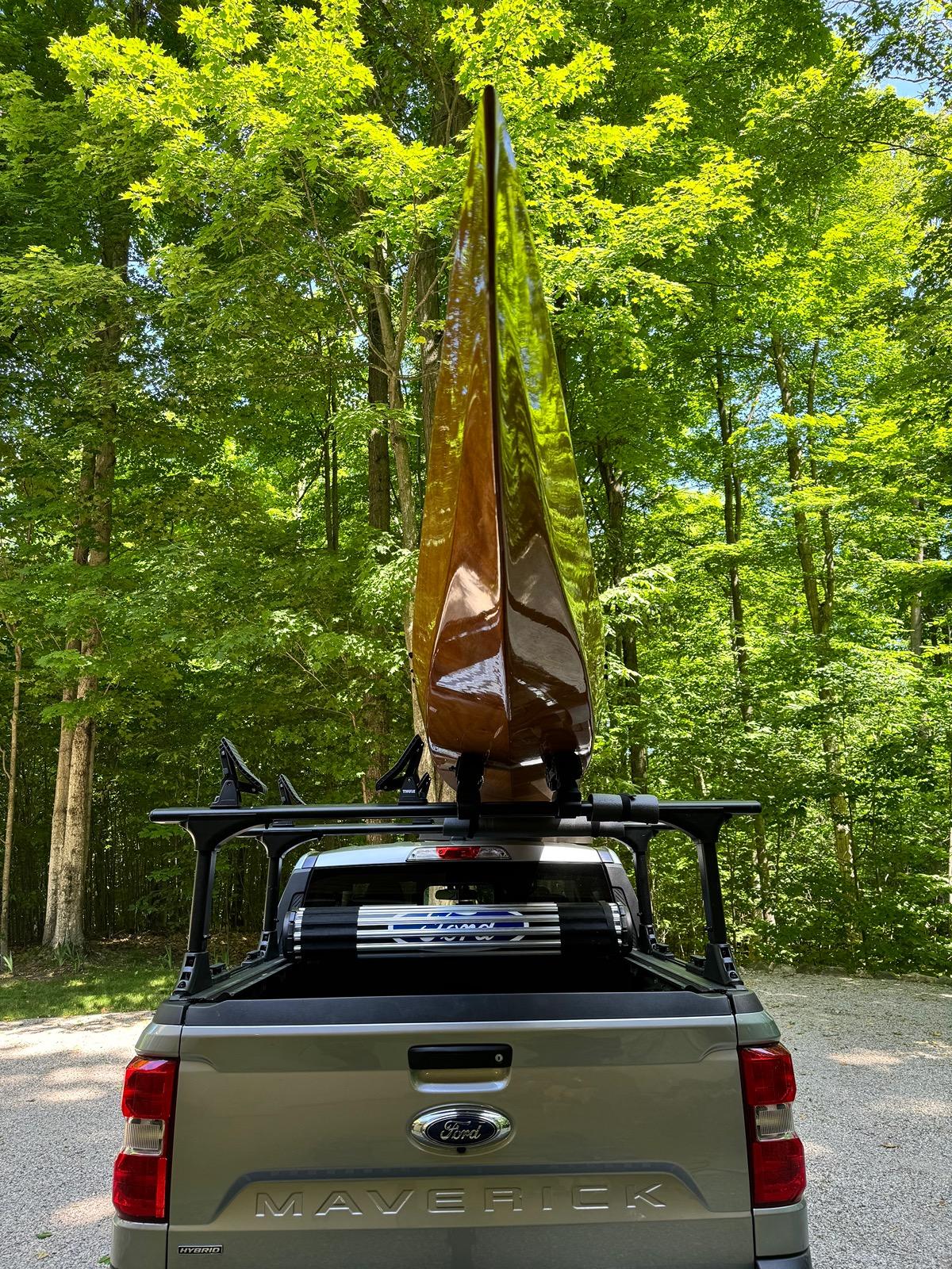

I made my first long distance road trip hauling my kayak up North. I have the Ford roll up tonneau cover, Elevate rack, Thule DockGrip, Yakima HandRoll and Kuat hitch bike rack. I use the Yakima HandRoll to push up the kayak to the rack, I place a long think foam cushion on the roof so it has a soft landing when I push it up. Once on top I move the kayak to the Thule DockGrip and stop it down.
I don't use a bow or stern line b/c the Thule DockGrip prevents the kayak from moving left or right. I have a tie down strap in the front and rear of the cock pit opening to hold it down and it prevents the kayak from sliding forward to backwards....The kayak has a 1 inch trim around the cock pit opening with an overhang lip. There is no way for the tie down straps to slip over the cock pit opening.
Driving down the highway with the kayak on top I didn't really notice any handling issues and my gas mileage was around 34 mpg. Since I'm retired I'm not in a hurry so I pretty much drove at 70 mph.
